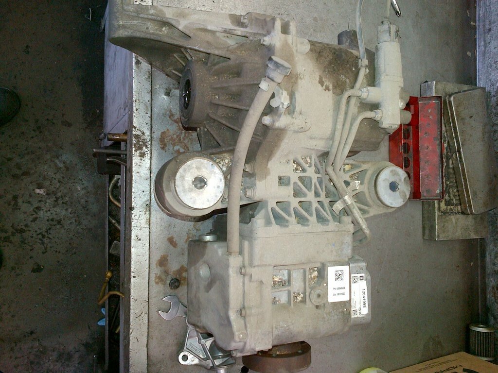

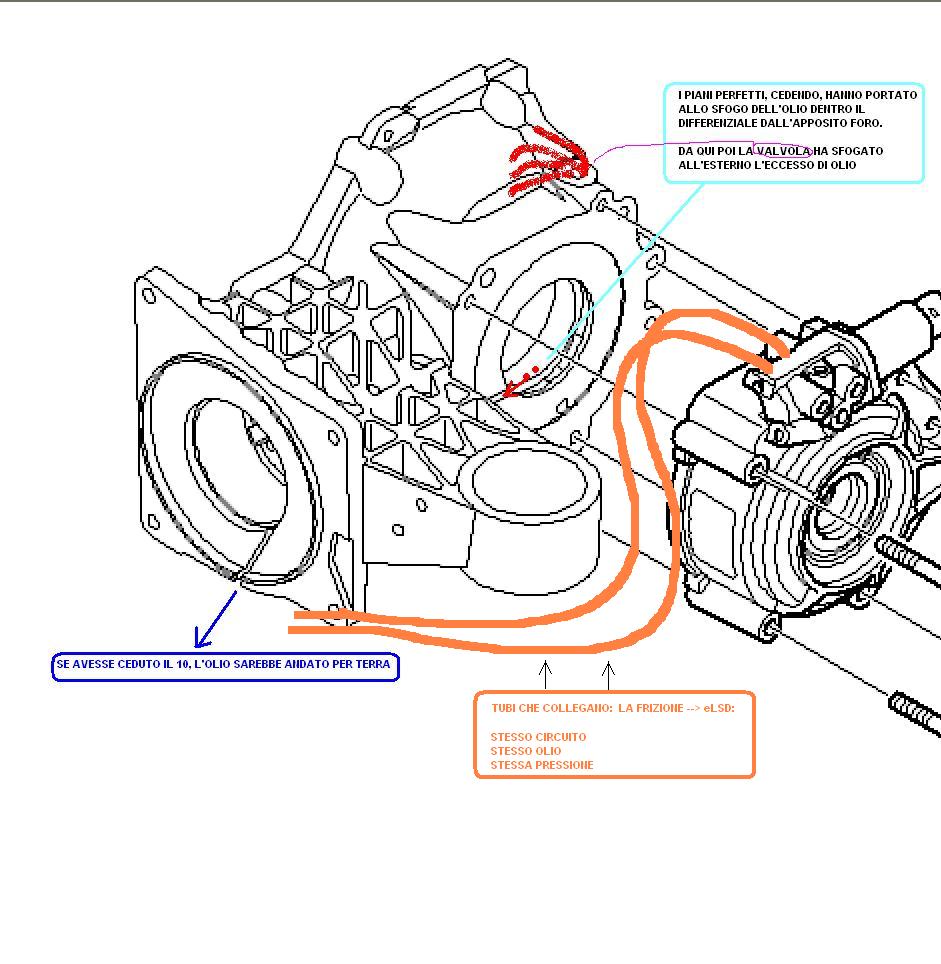

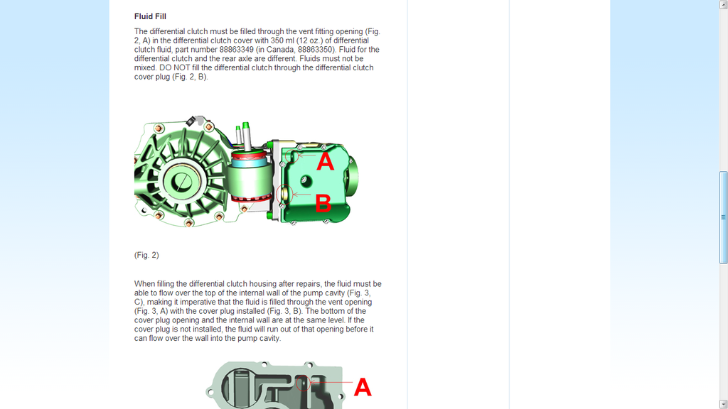

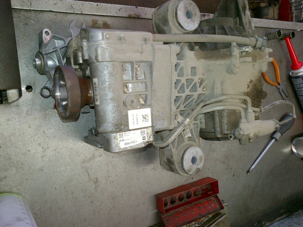

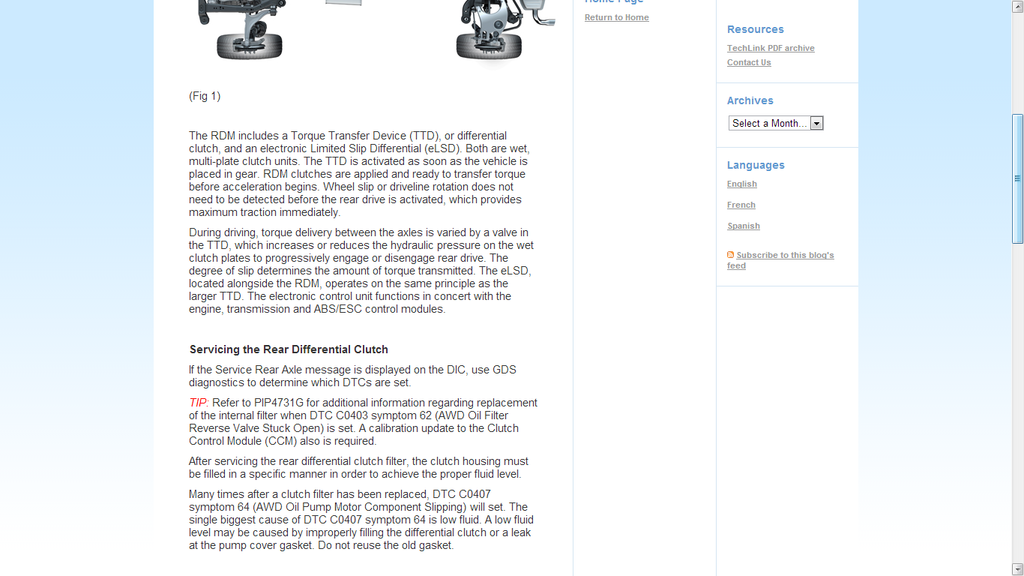

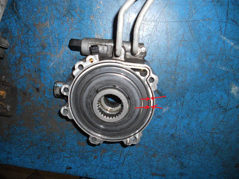

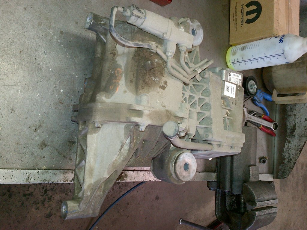

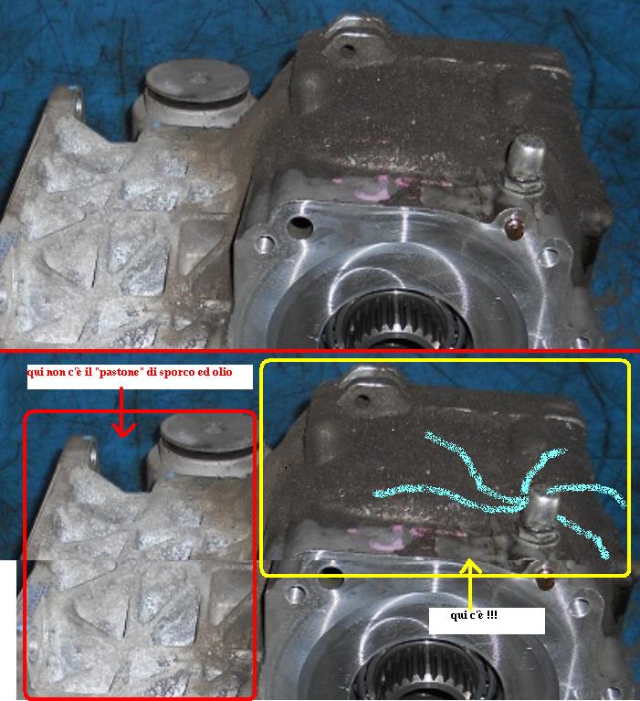

  6. Hello guys, I am writing to inform you of some details. It now seems certain that the problem that plagues the differential traction XWD affects only cars with eLSD. In fact the problem is caused by the emptying of the hydraulic oil, that organ, the coupling, through the connecting tubes of eLSD, Hose in differential because of poor sealing of a metallic o-ring. This produces, in time, draining the oil from the hydraulic coupling member, mixing with the grease of the rear differential with the consequent loss of system pressure and the resulting message in the SID.

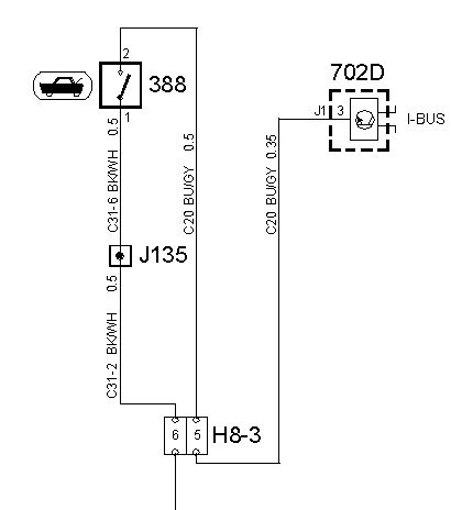

  8. Hi guys The command for opening the luggage compartment is no longer present. But the electrical system exists, and it is possible to install it. Also, the button is available as a spare part, its code is: 12787917. For those who wish to do so, the connection is simple, just connect the button to: pin number 5 of the connector H8-3 (.3 The H8 is an 8-pin connector, but only 5 are used) that corresponds to the blue / gray (in turn connected to pin 3 of connector J1 of the electronic door ) and: the joint J135 (which is a mass, and is always located behind the door panel) The coupling is easily recognizable because there is connected to the lamp and under the central locking switch. [ATTACH]75742.vB[/ATTACH] [ATTACH]75743.vB[/ATTACH] [ATTACH]75744.vB[/ATTACH]

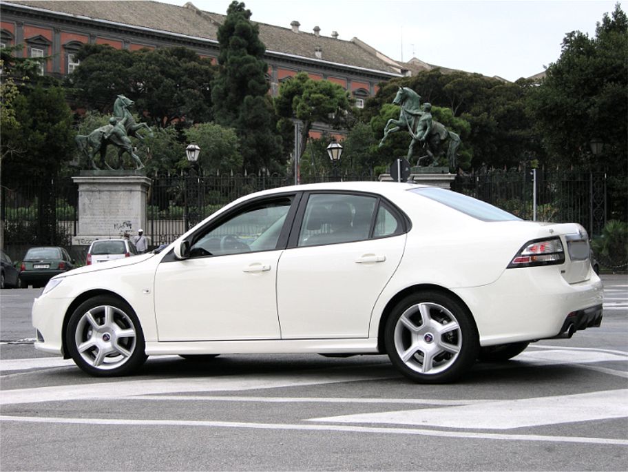

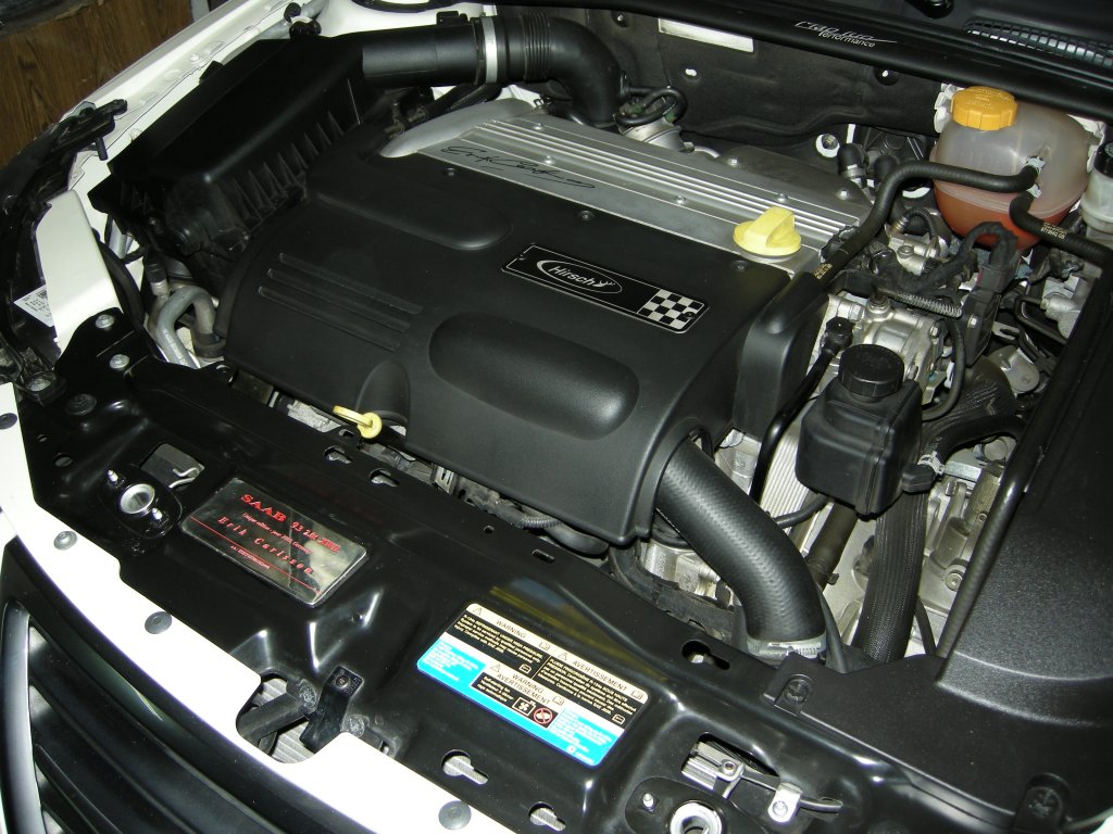

    Hello everyone, my name is Augustine, writing from Naples (ITALY), I am a fan of the Saab brand and a member of Saabwayclub Italy. Pardon my English, but not very good. I joined the world Saab in 2010 and since then I was in love. My Saab is "one of your" I've done here in Italy import from Tubingen. I'm talking about the model, unique in the world, in collaboration with Hirsch Performance. The Saab 9.3 Germany Erik carlsson edition, sedan, polar white This is just one in the picture of SaabHistory license plate F-SB4565. A two-liter XWD with eLSD Hirsch and many accessories including the mapping to 240cv. Some of you have the other model? (That is, the station charcoal gray) I introduce you:
