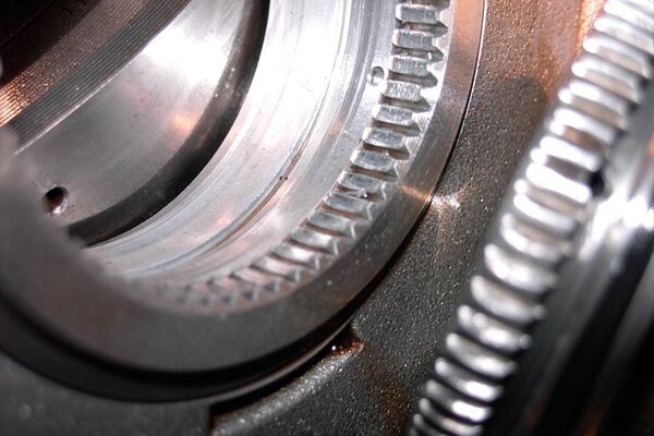

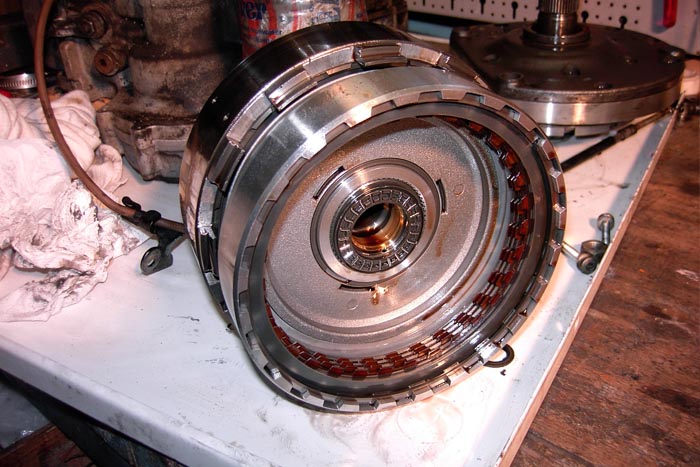

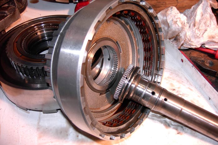

I disassembled the transmission and inspected the clutch rings. They where all in verry good condition. As i was reassembling clutch A i felt some play on the turbine shaft but it did not look to bad. Then i went on assembling but when i turned with the clutch A shaft i noticed an irregular sound and movement. So i disassembled the shaft of clutch A and there i found that the teeth in the Clutch A cilynder were gone in the middle. So if the shaft was not exatly in the middle you could not feel the it slipped.
I added a picture of clutch A and a close up of the defect piece
