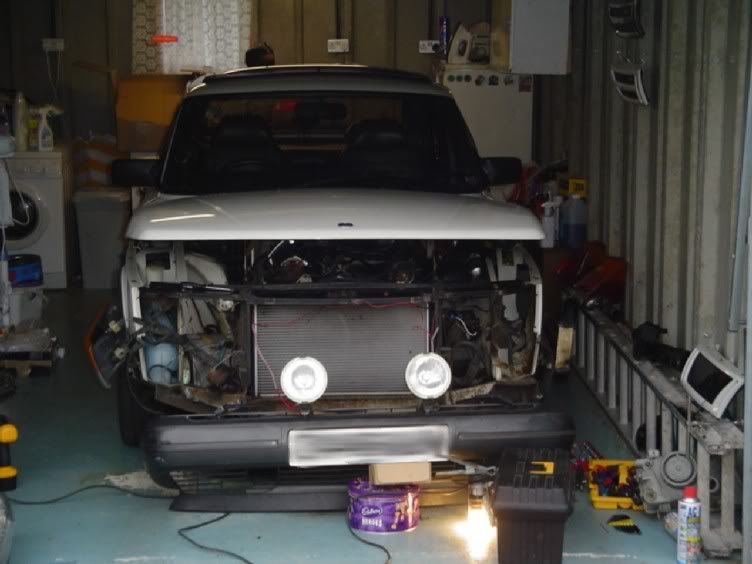

spent a great weekend doing Saabs, from a Saab meet on Saturday to fitting my volvo Intercooler on Sunday

...hi Paul, on the pictures I can see that it is only beeing held through the two black straps one on each side ?

as for my FMIC its great the induction roar is louder too now,a bit more turbo lag.
but I can live with that as when it flies it flies
It holds 1 Bar of boost easy , the biggest benifit for a FMIC is the "COLD" intake temps now.
as for the cable ties/zip ties every FMIC I have seen in the UK has had them fitted to hold the intercooler (ie lightweight fixings)
the Black T8S has a FMIC & its held on with cable ties ..its been there for 2 years now without any problems..
I did not "clock" the compressor side of the turbo.. I was thinking about it but its a lot of work..
the owner of the black T8S has a FMIC as already mentioned & he has not "Clocked" his turbo as well ( his T8S is the fatsest T8 that we know of in the country)
the only other thing I was thinking about was fitting a T3 turbo from a T16 just for the bigger compressor..

I'm a little bit confused about the tie-rap solution for you intercooler.
Do you think they will resist the appearing vibrations?

as for the cable ties/zip ties all the C900 FMIC setups I have seen in the UK use them..
I was speaking to my mate last weekend & his FMIC has been on his car for 2 years with no problems with the cable ties/zip ties..
its a light weight fixing system...
