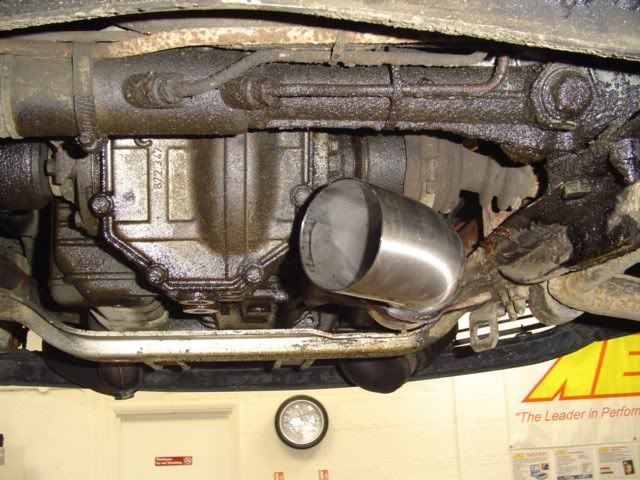

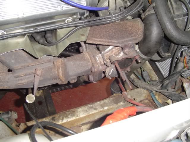

http://img.photobucket.com/albums/v280/bussman/DSC00569.jpg

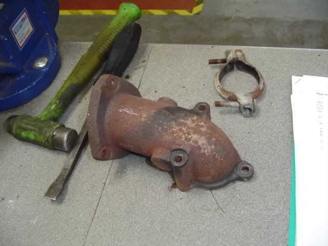

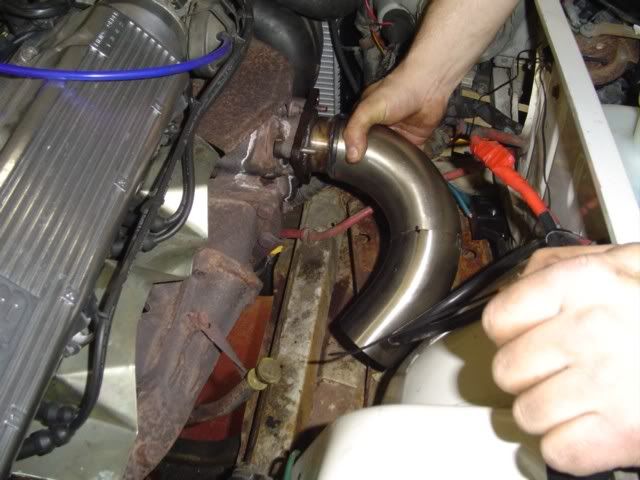

remove the nasty 90deg elbow

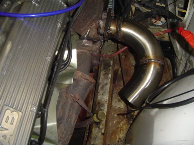

http://img.photobucket.com/albums/v280/bussman/DSC00570.jpg

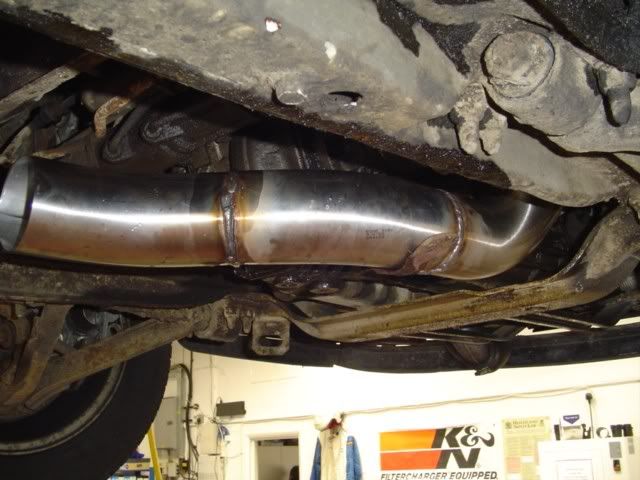

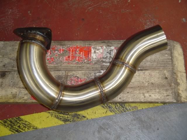

offer up the first section that has only been tack welded

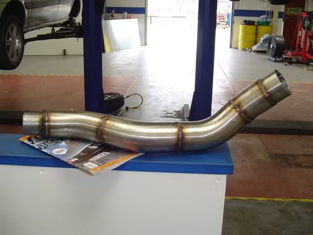

http://img.photobucket.com/albums/v280/bussman/DSC00572.jpg
with some more welding.........
http://img.photobucket.com/albums/v280/bussman/DSC00573.jpg
it looks like this

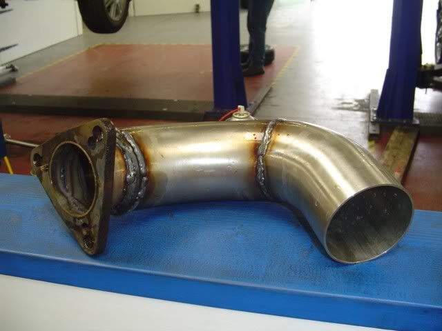

http://img.photobucket.com/albums/v280/bussman/DSC00574.jpg
Paul
fully welded..

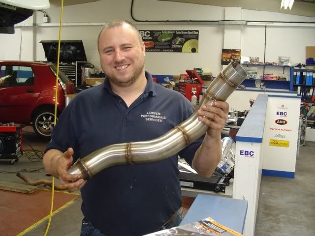

http://img.photobucket.com/albums/v280/bussman/DSC00575.jpg

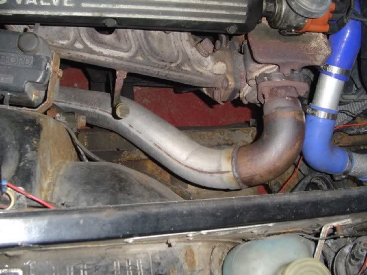

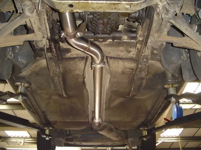

this is the complete first section it goes from the turbo to near the gearbox dip-stick..

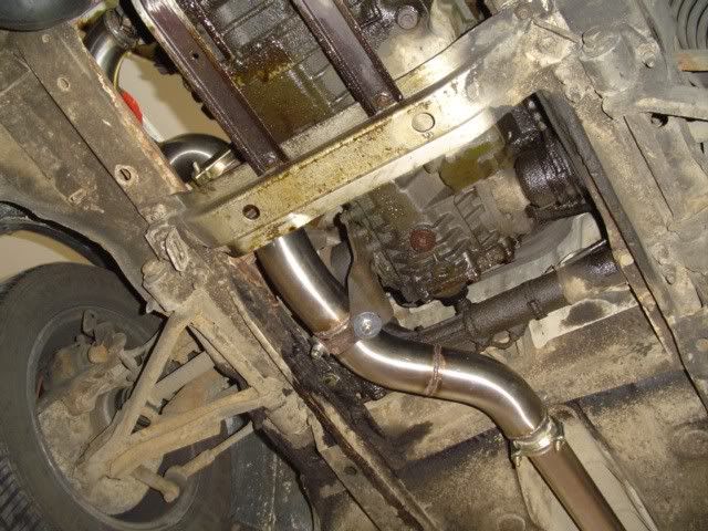

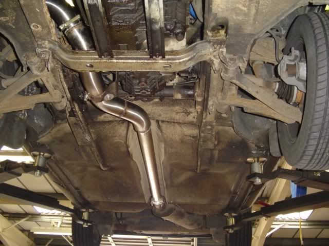

http://img.photobucket.com/albums/v280/bussman/DSC00576.jpg
this section goes from the dip-stick to the back of the gearbox near the floor

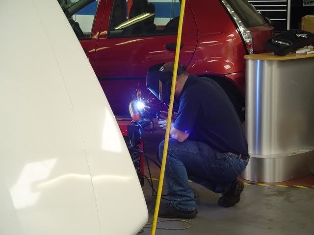

http://img.photobucket.com/albums/v280/bussman/DSC00582.jpg
as welded up by Steve a "God of the welding rods"

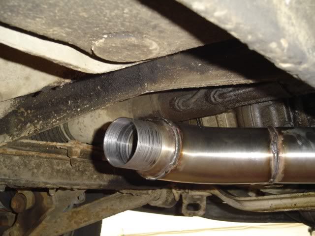

the gearbox bracket.
http://img.photobucket.com/albums/v280/bussman/DSC00581.jpg
a reducer was made to flow down from 3" to 2.5"

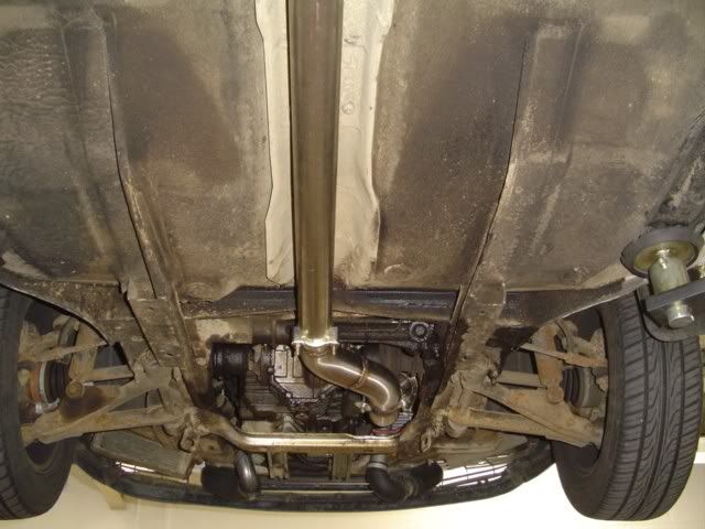

some pictures of the complete exhaust..
http://img.photobucket.com/albums/v280/bussman/DSC00586.jpg
http://img.photobucket.com/albums/v280/bussman/DSC00585.jpg
http://img.photobucket.com/albums/v280/bussman/DSC00587.jpg
from the turbo past the gearbox backwards..

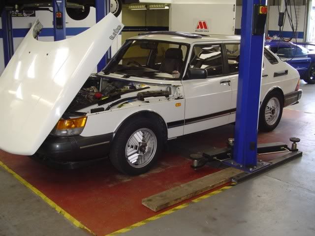

some of the other cool motor there yesterday..
http://img.photobucket.com/albums/v280/bussman/DSC00568.jpg a sleeper T8
the BadBoy is waiting to have a supercharger fitted 2005 Mystang

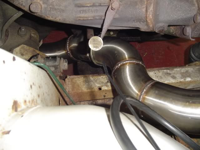

another picture I found, this time the 3" going past the gearbox dip-stick & manifold
