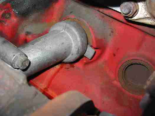

  20. klar andere Baustelle (Sinn und Zweck) habe ich ja geschrieben (s.o.)- totzdem werden die T-Schalter ja nicht umsonst angeboten. Für extrem heisse Umgebung wird zur Kombination aus 82 Thermostat und 82 fan switch geraten. Für unsere Verhältnisse ungeeignet ! Kann ja sein, dass von Euch einer in die Wüste möchte :00000465 ....Saab thermostats are special. They have a three position operation. the first position is full closed and it blocks all flow to the radiator until the engine warms up. The second position allows flow both to the heater core and the radiator to provide cabin heat and cool the engine. This is the position the thermostat should be in most of the time while driving. The third position of the thermostat allows full flow to the radiator and blocks flow to the heater core as the plate on the bottom of the thermostat blocks the passage to the pipe to the heater. The thermostat reaches this position when the engine is nearing overheating and allows coolant to flow directly to the most efficient heat exchanger, the radiator. The heater core is bypassed because the heater valve has bypass circuits in it and is not exposed nor has the flow capabilities of the radiator. This allows for maximum cooling of the engine when it is needed. Aftermarket designs usually do not incorporate these three positions, only two. The biggest complaint from people who use incorrect aftermarket thermostats is no heat after the car warms up in the winter. Saab supplies two thermostats, an 89 and an 82 degree unit. We highly recommend using the 82 degree unit to keep the engine as cool as possible but still within its designed operating temperature.
  21. Einzig durch den Thermoschalter lässt sich der Hitzehaushalt beim 9000Turbo sinnvoll steuern. Zur Funktionsweise des Thermostaten wurde alles wesentliche geschrieben. Selbst zwischen einem 88° und 89°C besteht ein deutlicher, sichtbarer Unterschied am "Schätzeisen" Kühlmittelanzeige. Ich denke, dass die Teile ein unheimliche Streuung haben. Thermoschalter Opening Temperature 1 is 80-85 degrees Opening Temperature 2 is 88-93 degrees oder Opening Temperature 1 is 84-95 degrees Opening Temperature 2 is 91-102 degrees
  22. ist das ein orig. Saab Thermostat ? Manchmal kann man insbes. mit den Zubehörteilen Pech haben. Einen 88° von flenner habe ich noch hier liegen. Fast neu, d.h. der war nur kurz zu Testzwecken im Wasser.
