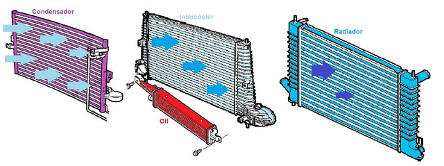

The 9-5 IC does not have a good installation, the "sandwich" type is very bad for hot climates.
The air can not circulate between the different parts, there is a lot of retention.
Hello guys!
Orginal Saab IC is very poor for cooling air in our cars, espetially in Aero and tuned ones. In fact it`s badly mounted too, because it`s in the middle. Air must flow through clima radiator first - in hot days clima warms the air by the way.

Das erste und letzte stammt von "David" (aus Spanien), also jemand der häufig mit hohen Temperaturen konfrontiert ist.
