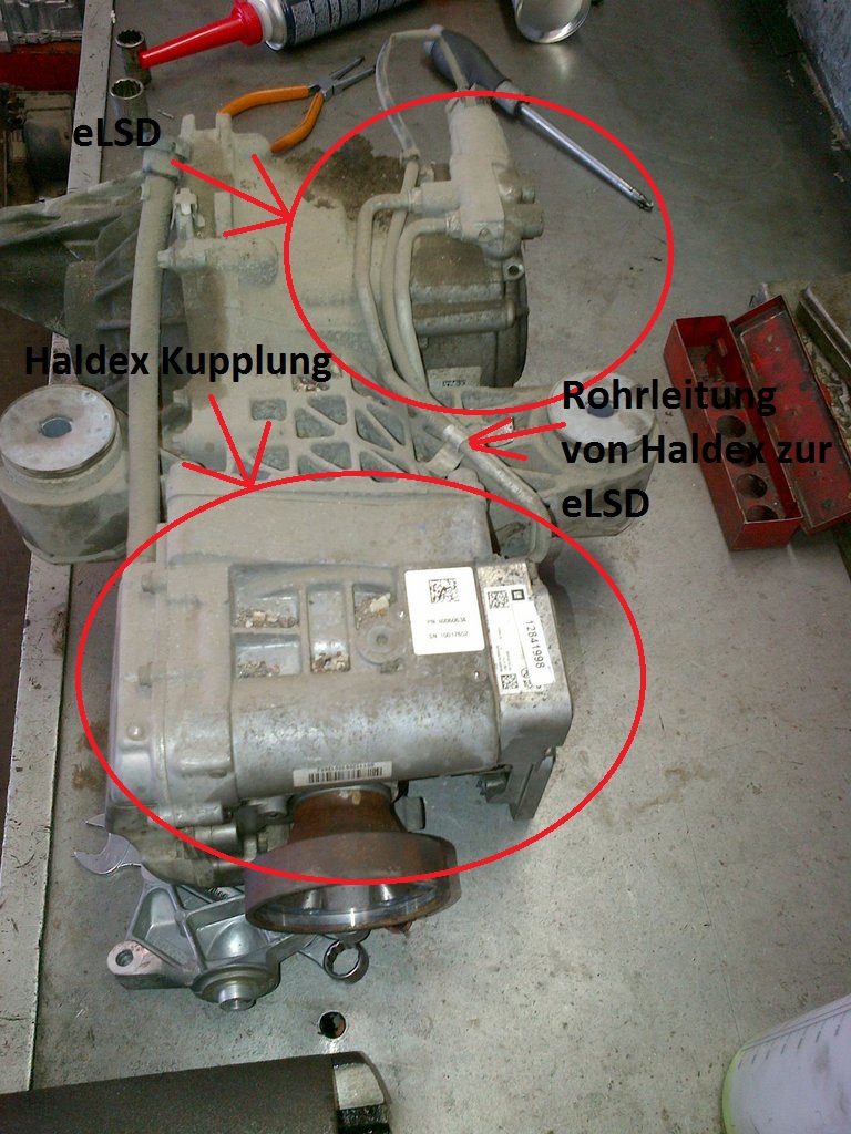

Hello guys, I am writing to inform you of some details.
It now seems certain that the problem that plagues the differential traction XWD affects only cars with eLSD.
In fact the problem is caused by the emptying of the hydraulic oil, that organ, the coupling, through the connecting tubes of eLSD, Hose in differential because of poor sealing of a metallic o-ring.
This produces, in time, draining the oil from the hydraulic coupling member, mixing with the grease of the rear differential with the consequent loss of system pressure and the resulting message in the SID. 6.thumb.JPG.2088b952481f99bc244fe7400595d83c.JPG6.thumb.JPG.2088b952481f99bc244fe7400595d83c.JPGDifferenzialeTurboX28229.thumb.jpg.ed57b26a9cafda10820821f38dbff84f.jpgDifferenzialeTurboX28629.thumb.jpg.63c6a6b35326b9c4e1bd0a84901807d3.jpgDifferenzialeTurboX.thumb.jpg.2e770de4adb5f198ddf3088c96ab810d.jpgDSCN2226mm.gif.d0ef2e7577a08d3ff747b596e8a08414.gifIPOTETICOPERCORSO.thumb.JPG.703e59e9392e66a42fb46c1d423e444a.JPGImmagine3.thumb.png.a0fc7e5516157e409836d74de6bf487e.pngImmagine2.thumb.png.eebf49278156eab1445a7be335856db6.pngImmagine1.thumb.png.ebd752f03db45c7cac785a8464764916.pngImmagine.png.6980bfd69fb4408008968b023c1743f2.png6.thumb.JPG.2088b952481f99bc244fe7400595d83c.JPGDifferenzialeTurboX28229.thumb.jpg.ed57b26a9cafda10820821f38dbff84f.jpgDifferenzialeTurboX28629.thumb.jpg.63c6a6b35326b9c4e1bd0a84901807d3.jpgDifferenzialeTurboX.thumb.jpg.2e770de4adb5f198ddf3088c96ab810d.jpgDSCN2226mm.gif.d0ef2e7577a08d3ff747b596e8a08414.gifIPOTETICOPERCORSO.thumb.JPG.703e59e9392e66a42fb46c1d423e444a.JPGImmagine3.thumb.png.a0fc7e5516157e409836d74de6bf487e.pngImmagine2.thumb.png.eebf49278156eab1445a7be335856db6.pngImmagine1.thumb.png.ebd752f03db45c7cac785a8464764916.pngImmagine.png.6980bfd69fb4408008968b023c1743f2.png

so wie ich den Post von desertstorm verstanden habe, tritt der Ausfall der Haldex Kupplung wohl nur bei Fahrzeugen auf, die mit eLSD ausgestattet sind.
Denn offensichtlich wird die Differenzialsperre (eLSD) durch die Haldexpumpe über Leitungen mit Öldruck aus dem Haldexölsystem (zum Betätigen der Sperre) versorgt und bei dem Betätigungskolben der Sperre kann es zu Undichtigkeiten an den Kolbendichtungen kommen.
Dadurch gelangt dann Öl aus dem Haldexölkreislauf über die defekte Kolbendichtung in das Hinterachsdifferential.
Das sorgt dann nach einer gewissen Zeit durch den zu geringen Ölstand im Haldexsystem zum Ausfall des Systems wegen mangelnden Öldrucks.
Und ich glaube nicht das er meint die Entlüftung vom Hinterachsdifferential zu verschließen, den dem Bild nach zu urteilen meint er damit, dass das Öl welches zu viel im Hinterachsdiff ist (durch die Leckage), irgendwann durch die Entlüftung rausgedrückt wird.
Sooo...........noch Fragen?:biggrin:
Gruß Micha
Bearbeitet von awtpa

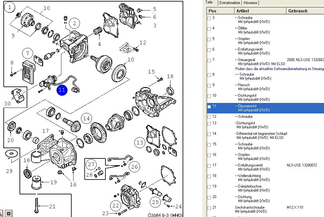

Ja hätte. Welche Dichtung ist den der Übeltäter.... (siehe Bild EPC).
Bringt ja nix das Öl zu wechseln und die Ursache nicht zu behenben.
Welche Entlüftung genau verschlossen werden soll habe ich leider auch nicht ganz verstanden.
Die Kolbenabdichtung von der eLSD (Bauteil Nr. 22) ist auf dem EPC Ausdruck scheinbar nicht separat aufgeführt.
hab ich mir gedacht :(

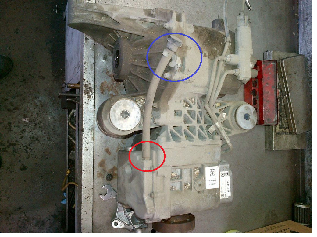

Ich habe jetzt schon an einigen Stellen von diesem Upgrade des Filters gelesen. Der augenscheinliche Unterschied ist die Filterposition. Allerdings bin ich mir nicht sicher ob ich an der richtigen Stelle suche. War gestern unter meinem Auto. Am Haldex-System gibt es nur ein Bauteil, welches annähernd wie ein Filtergehäuse aussieht und dieses sitzt auch am Ende eines Schlauches der meiner Meinung nach der Entlüftung des Systems dient (blauer Kreis). Soweit so gut. Nun ist das Problem, dass der Abgang vom Gehäuse bei meinem Fahrzeug weder Senkrecht, noch 45° sondern Horizontal ist (wie auf dem Bild aus den Beiträgen der vorherigen Seite welches ich hier mit Markierung - roter Kreis - eingefügt habe).
Filtertausch geht vermutlich leicht (Schlauch ab, Filter tauschen, Schlauch dran). Aber wie tauscht man das Öl? Ablasschraube sehe ich keine, denn der Abgang unterhalb des roten Kreises auf meinem Bild ist ja nicht ganz unten. Bliebe nur den Deckel zu öffen (neue Dichtung notwendig / oder ist der geklebt). Aber wie kommt das neue Öl dann rein? Über die Entlüftung? Wieviel Öl muss rein, bzw. wie kann der Stand kontrolliert werden?
Fur einen Ölwechsel brauchen Sie den Seitendeckel an der Rechten Seite von der Haldex ab zu nehmen.
Ist einen bisschen Fummelei, weil der Auspuf im Wege sitzt, aber mit etwas Geduld und die richtige Schlüssel geh't.
Aber besorge dir vorher einen neuen Satz Packungen und filter und die richtige Öle.
Da sind auf YT wohl einige Video zu finden.

Sieht nicht sehr aufwändig aus.- jetzt weiß ich schonmal wo der Filter sitzt
Ist es nötig das Öl von den Differentialen mit zu tauschen oder reicht der Wechsel des Öls vom Haldex?
