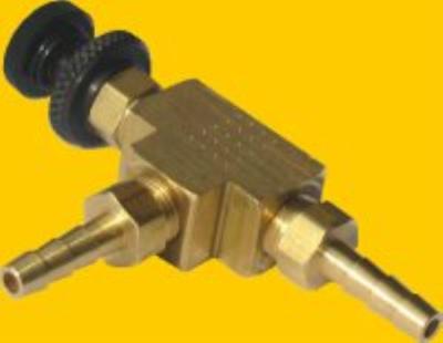

kennt eigentlich schon jemand dieses Coole Tuning-Ventil (s.u., http://www.elkparts.co.uk/product_info.php?cPath=23_120_623&products_id=1087 ) ?
Ich glaube das ist eine „solide“ Variante des „Büroklammertunings“ ( http://saab-cars.de/foren/saabforum/phpBB2/viewtopic.php?t=925&highlight=b%FCroklammer ), bin mir aber nicht so sicher.
BeachIM
Manual Boost Controller
[JoeP] £35.25
Available exclusively from Elkparts in the UK, the JoeP MBC is an easy way to improve performance on pre-Trionic turbo vehicles.
The principle behind the JoeP MBC is simple, yet effective - it is a two-port valve that fits within the vacuum line to the wastegate actuator and that opens at a user-selectable boost pressure. Until that pressure is reached, control of the turbo's wastegate is prevented and boost is allowed to rise rapidly. At the desired point the JoeP MBC opens, allowing boost through to the wastegate actuator and control of the wastegate in the normal way. The result is fast turbo spool up to a boost pressure fully under your control.
Adjustment of the JoeP MBC is by means of a thumbwheel (no tools required). A locking wheel ensures that, once set, no deviation of desired boost level occurs.
The JoeP MBC offers superior performance to similar valves on the market, due to its fail-safe, smooth operating twin ball and spring design. Unlike the more common 3 port 'bleed' valves, the JoeP MBC does not introduce leaks into the system, or allow any boost pressure through to the wastegate actuator until you want it to!
Please note that engine damage may result through overenthusiastic use of this device. It is the user's responsibility to ensure that the boost level set on the JoeP MBC is safe for the application. It is highly recommended that setting of the JoeP MBC is undertaken in conjunction with a graduated boost gauge. Elkparts accepts no responsibility for failure brought about by improper use of this device.

Aber davon ab scheint das bei Modellen ohne Trionic zu funktionieren, sehr nett wenn man temporär etwas Zusatzleistung benötigt 8)

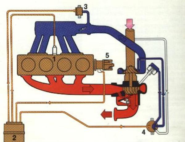

So, BeachIM jetzt bau mal dein "Manuellen Boost Controller" ein.
1. Klopfsensor
2. Elekronik
3. Druckbegrenzer
4. Druckregelventil
5. Drehzahlerfassung
Das von Erik angesprochene Problem ist nicht ganz ohne, die APC kann nie unter den GLD regeln, wenn du nun aber mit Büroklammern oder anderen Zaubermitteln dein Druck so erhöhst dass das APC System damit praktisch lahmgelegt wird macht sich das sehr schlecht, der Motor fängt an zu klopfen, APC will Druck senken kann aber nicht, und ehe du dich versiehst ist dein Kolben geschmolzen, oder Pleulstange durch geht schneller als man denkt. :cry: :cry: :cry:
