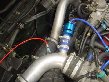

I've just brought a nearly new Bailey Atmos Dump Valve DV26..
I also have a spare top intercooler pipe, which I'm getting a alloy spigot welded onto...
now who of you guys is using a Bailey Dump Valve or a Forge Dump Valve..
I'm getting the spigot welded onto the elbow of the top intercooler pipe..
or is it better to get the spigot welded closer to the throttle body..
here's a picture of my mates T8S with dump valve & water injection..
he has a later top intercooler pipe on his 1989 T8S..
his car runs 221bhp with a volvo FMIC & CAT cam, now 5th injector, shortshift gearstick, plus other bits & bobs..
I have driven his car & it pulls like a train, loads of power/torque wheels spin in everygear in the dry...

Hi pda!
Personally I am running a standard Bosch-recirculating-item. :oops:
I think the best place to mount the BOV is as close to the throttle-body as possible. So you wont get any air-waves coming back when you let your foot of the throttle...
Kind Regards,
Erik
similar position to the one in the picture rather than nearer to the elbow..
Paul
Hi!
Well, if you want to mount it to the elbow. than the shown position is allright. Best would be the connection on the throttle-body, where the pipe for the recirc-bov is normaly mounted on a 16V-900 Turbo.
Just my opinion, not the ultimate way to go... :mrgreen:
Happy Saabing,
Erik
yes I know people who have fitted a 16v throttle body to a T8 just to mount their dump valve on it...
but the dump valve ends up being, silent nearly not loud
you end up with a better sound/louder, mounting it on the elbow of the top intercooler pipe..
even Abbott Racing mount their dump valves on the top intercooler pipe elbow..
Paul

I picked up my top intercooler pipe yesterday afternoon, from the welders
he made a very good job of it.
it looks lovely.. (plus very cheap only cost me £5)
fitted it to my T8 when I got home :daumenhoch:
easy job only took 15 minutes to fit...intercooler pipe/Dump valve/jubilee clips & all vacuum lines etc etc..
started T8, runs fine idles lovely..
had to go for a little drive last night WOW BOY OH BOY its loud :thumbsup: I'm very happy now......
