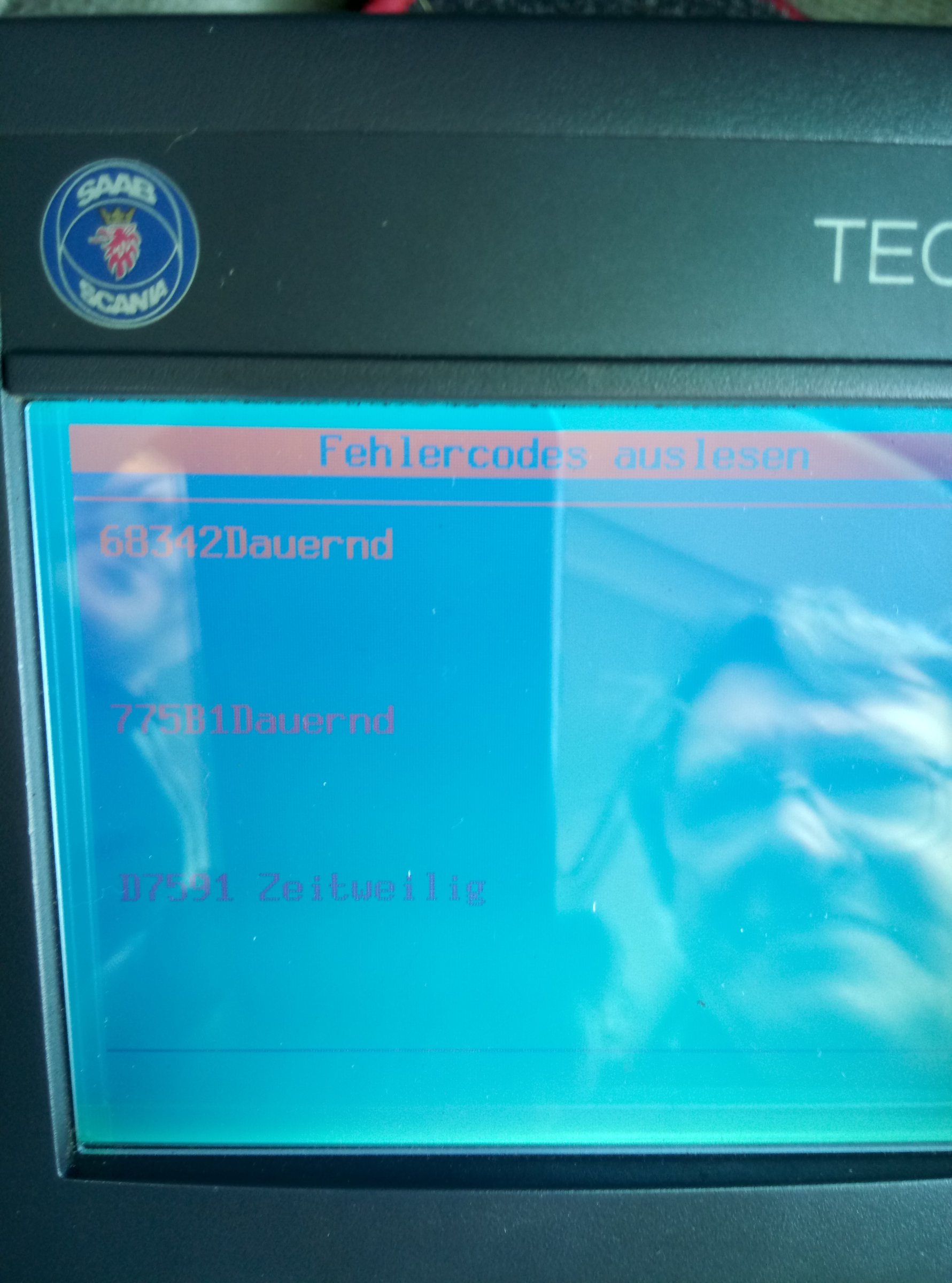

Welche Fehlercodes waren für welche ECU gespeichert?
Was passiert beim Kalibrieren?
Nächster Versuch findet morgen Vormittag statt. Dann schreibe ich die Fehlermeldung mal auf.

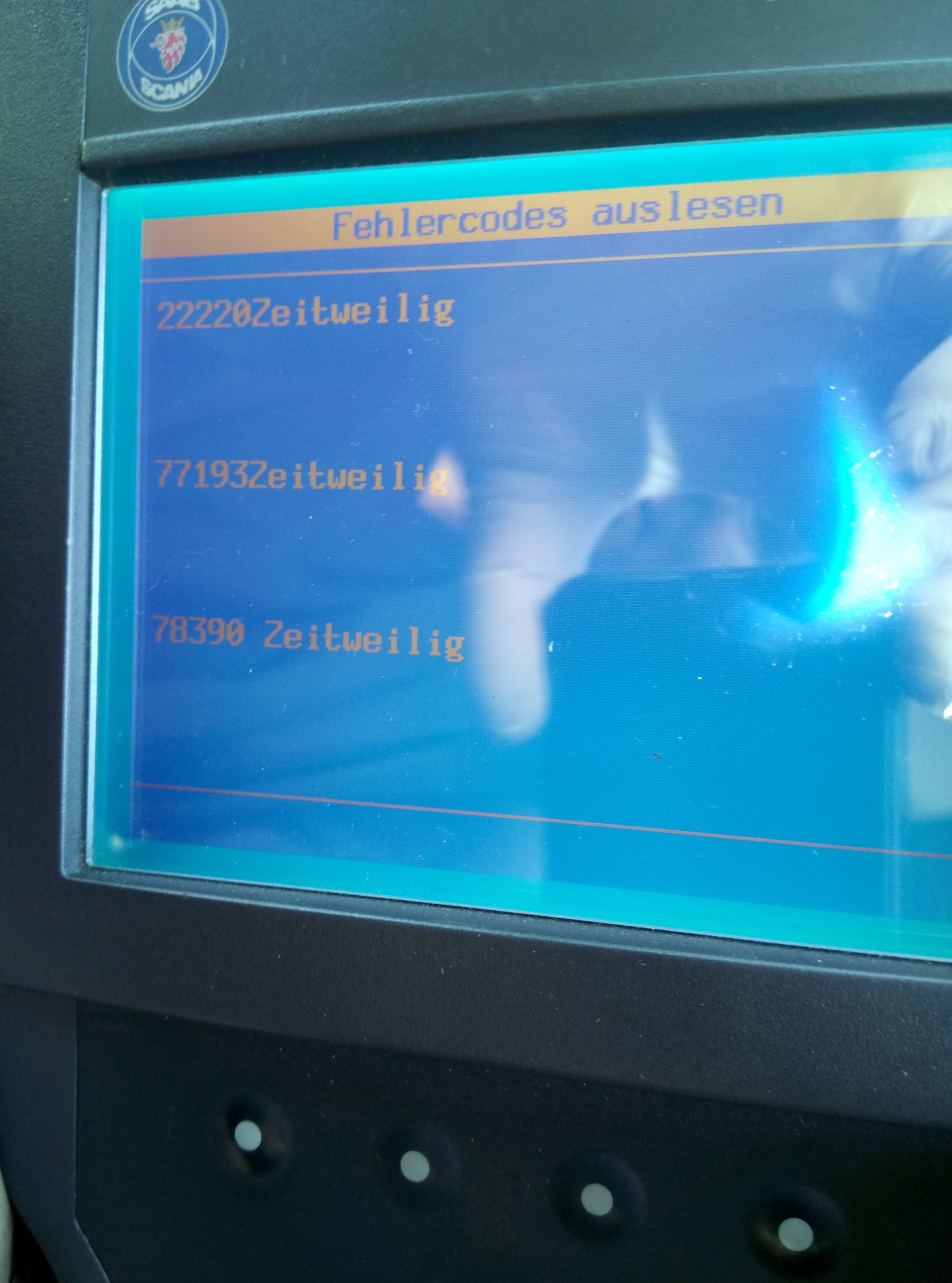

22220: Zeitweilig keine Spannung an Pin 22 und/oder Pin 13 des ETS-Moduls.
Dieser Fehler muss als erstes behoben werden. Wie ich weiter oben schon schrieb als erstes die Kontakte mit Kontakt 61 säubern.

77193 ETS ECU Fehler: EEPROM defekt
78390 Fehlfunktion des Drosselklappenventils
Wie gesagt, erstmal die Masse und Spannung checken und Fehler löschen.
Sollte 77193 wieder auftauchen hilft leider nur der Tausch des ETS-Moduls.
zu 78390 wieder auf englisch:
Fault Codes 6/78390 (Malfunction In Throttle Valve Control)
1) Check if other fault codes are present. If other fault codes are present, repair those fault codes first. If other codes are
not present, go to next step.
2) Check for leaks in vacuum circuit by starting engine. Disconnect hose between non-return valve and intake manifold. If this
causes arm on throttle housing to retract, there is a system leak. To pinpoint leak, pinch hoses, one at a time, from non-return valve via
safety valve to throttle housing. Replace any components that may be causing leak.
3) If a leak is not present, raise vacuum in throttle housing vacuum unit to release spring. In addition, disconnect intake boot at
throttle housing so throttle valve can be moved by hand.
4) Ensure ignition is off. Disconnect ETS ECU connector. Measure resistance between ETS ECU connector terminals No. 20 (Green
wire) and No. 21 (Green/White wire). Move throttle valve slowly through its entire travel. Stop throttle valve at several points so
resistance reading can stabilize. Resistance should be less than 200 ohms. If resistance is within specification, go to step 6). If
resistance is at any time greater than 200 ohms, go to step 5).
NOTE: It is normal for resistance to increase greater than specification while motor is rotated. This is because of
brushes moving along the commutator. Compare resistance to specification only with throttle valve held stationary.
5) Disconnect throttle housing connector. Measure resistance of motor between throttle housing terminals No. 1 (Green wire) and No.
7 (Green/White wire). If resistance was greater than 200 ohms in step 4) but is to specification now, check and repair wiring as necessary.
If resistance was too high in both tests, replace throttle housing.
6) Check Green wire between throttle housing terminal No. 1 and ETS ECU terminal No. 20 for an open or short circuit. Also check
Green/White wire between throttle housing terminal No. 7 and ETS ECU terminal No. 21 for an open or short circuit. If wiring is okay and
fault code persists, replace ETS ECU.

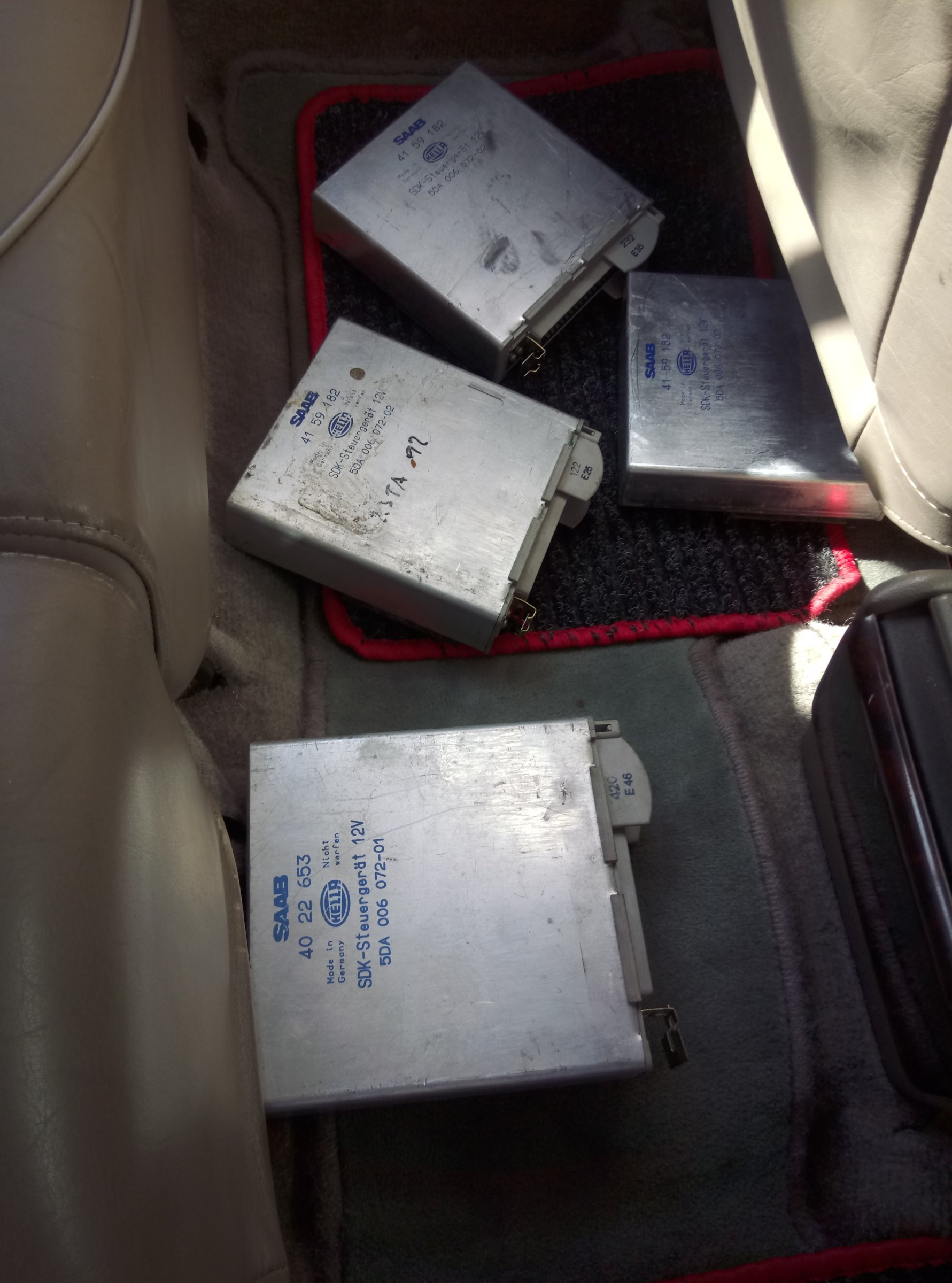

Ist das das ETS Modul? Alle verhalten sich gleich...leider ...
4022653: ETS MJ91
4159182: ETS MJ92
Vier defekte Module möchte ich ausschließen, daher Kontakte reinigen, Verkabelung prüfen. Auch das Relais, ich hatte schon Spannungsabfall von 3 Volt über den Kontakten.
