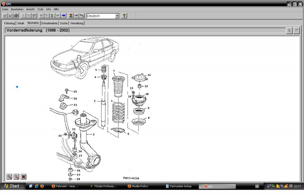

  14. Mal ganz ehrlich, wenn's wie vorgesehen zusammengebaut ist, hat die Feder soviel Druck, die KANN sich NICHT rausdrehen... Ganz sicher richtig zusammengebaut?!?!?! [ATTACH]57322.vB[/ATTACH]http://www.saab-cars.de/image/png;base64,iVBORw0KGgoAAAANSUhEUgAABQAAAAMgCAIAAADz+lisAAAgAElEQVR4nOzdXaw12Vkf+Mowk9Ew9CStME7oZFDcHppAYkFoBzvgEMdjIMQ0jgPmo8GG4LjtYBQTOkOAhLzt4WMahwYiQmRbJAhQGmE8CqNOpJGikU4urZDRzMXcRLHyXozUV+4RXEwuay62u1ynaq1Vq1at+tr799NR65zaVc96qnbVfuu/1z6nm6ZpHhtpAAAA4LSiObftGS8BAACAc4ml3ab/8+ZdAQAAwCoGgfdzAXicfreamgYAAIA6Yhn4cw83oanhjwAAAMCpjGNwF3sDEblpmv8ZAAAATis4yzsMwE3T/BQAAAC3reCzx0cr0ox/AXiw6O8BAABw25qm+cIv/MIv+qIv+uIv/uLXvva1r3vd6770S7/0T//pP/3617/+K77iK97whjd89Vd/9Rvf+Mav+Zqv+bqv+7q3vOUtb33rW9/2trcNEuURigQycP/nH+5p26ZtP7fk7u6u/+NzzzVt29zd3f0wAAAA16Jpmscee+xP/Ik/8brXve6JJ574si/7ste//vVf+ZVf+VVf9VWXqPnmN7/5L/2lv/TWt77167/+6//yX/7Lb3/727/lW77lne9851/7a3+tC5UHKRINwE3T/I2RSwa+u7u7pN/LV3/5eBMAAADOq2maP/kn/+TrXve6L/uyL/szf+bPfOVXfuUb3vCGN77xjV/7tV/7dV/3dZcp1n7a/LZv+7bv+I7vePrpp9/znvd0ufJQRcIB+DtCLkH3Mt/bts1zzzXPfVZ4fQAAAM6raZov+ZIv+fIv//Kv+Iqv+LN/9s9+9Vd/9dd8zdf8hb/wFy4Trd/0Td/0zd/8ze94xzu+9Vu/9Tu/8zuffvrpd7/73d/7vd/73ve+95lnnuly5aGKzAjAzz33XNsO/k9KTdu2l2nhDY4+AAAAm2ma5pI53/CGN7zpTW9685vf/Ja3vOUy19oFzu94daL1r//1v/6+973vAx/4wAc/+MEPfehD/djZL9JOySny5je/+VOf+lTbtoNO2rb91Kc+legkHIC/qefu7u6Sci+PDb8uC9v2m0YGu9Ff8vu///v/5t/8mx/8wR/sr/+v/tW/+v3f//22bf/9v//3g4cAAADYWNM0lw8bv+lNb7pMt77tbW/7K3/lr7zjHe945zvf+e3f/u2X6Pt93/d9XeD8W3/rb/3wD//wj/zIj3S5clBkMgDnFHnrW9/ard910i1JdBIOwF/bM866gQzctnd3d19732X55/+xn+y+uiVf9MRH/o//8/9p2/aZD/zYZeXf+73f+73f+72veeuPPfLYT3zyf/2/f/GX//evfPKbvhYAAICdNE3z5/7cn/vzf/7PXzLnN3zDN7z97W/vplu/53u+5/Ix4/e///0/8AM/0AXOH/uxH/uJn/iJLlcOikwG4Jwil066Tb7ne76n+z7dSTgAv/5V7aufcA7M/fZTcdPc3d29/r4u7gaXfP03fHPbtp/+j5953Zf+D7/yK7/Stu3f/8n/7Qu+6O//qS9/0+tf//r/9ovf99hrn349AAAAO2ma5o1vfONf/It/8a1vfes3fuM3vv3tb/+rf/Wvftu3fdt3fdd3vfvd7/7+7//+973vfX/zb/7NH/zBH/yhH/qhZ5999kd/9Ef/3t/7ew8ePPjJn/zJLlcOirRtmyjStm1Oka6TQXie7CQcgF/72te+9rWv7Rd69e8/t58Lw/0J4bZt2/a193VxN7akbdtX/t//7wv+2P/48OHDtm2//Kt/6TX/3be8FgAAgANomuYy4/qN3/iNTz31VP9jz9///d9/mfj90Ic+1J9u/fCHP/xTP/VTzz//fJcrB0Xatk0Uads2p0i/ky605nQSDsCv6YlO/3aaz/7vkV5zXz8/95d8/h/7yde85jVf8iVf0rbtr/z6737+H/3xbvkXvua/fw0AAAAH0DRNN+N6yZzf/d3f/Z73vOfysecPfvCDl+nWv/t3/2433fozP/MzH/nIR37+53++y5WDIm3bJoq0bZtTpOtkMAM82Uk4AH9Bz2f//FUv696bE341D9/d3X3BfV2svXz1l/zxP/7H/92/+3evvPLKFz3xkc//I9/aLf8CAAAAjqFpmq//+q+/fN64m3F973vf+4EPfODyYeO/83f+zo/+6I/+xE/8xHPPPfdTP/VTP/uzP/tzP/dzv/ALv/BLv/RLXa4cFGnbNlGkbducIoO538tnp9u2/U//6T+lOwkH4M8bGc4Dt23/+0sYHmzSxdrBkotPfOJ/+VNf9ff/q9f82Of95//1f/gP/2GwJgAAAPu6/P3kd7zjHZdf2b38yatLcP3bf/tvXz5s/A/+wT/48Ic//NM//dM/+7M/+/M///O/+Iu/+Mu//Msf+9jHulw5KNK2baJI27Y5Rb73e7+3i5ZdkW5JopNwAB6L/m+QXv3883iTLgCPl1y+/uAf+vY/8HmPNk3z0Y9+tG3b7/4bvx0cGgAAgF188zd/87d+67cOZlz7PvzhDz///PMf+chHfuEXfuEf/aN/dMmc/+yf/bNEkUv67X5f98GDB12Rtm1zirz3ve+9/H+AB0Xatv3Upz6V6CQ3ADf9Wd/+Z6FfnQEOrx8JwIM1//Af/sOfeeX3P/0fP/NH/uibmqb5rd/6rY9+9KMZzwUAAAAreuc73/md3/mdlz9YFQzAzz///D/8h//w8mHjf/JP/snHP/7xX/3VX/31X//1RJH+3O/l93W7Im3b5hR5//vfnyiS6GRmAL78Fej2c//ro8n1O008ADdN89rH/9Qnf+f/uqzwb//tv/3Gb/mf/ov/5lumnw0AAABWc/lzU9/3fd/3/ve/PxiAL5nzH//jf/zRj370V37lV371V3/1N37jN1588cVZRfpyinzwgx+8pN8f//EfH6TfdCczAnDT+wtYiYnfvu7Tzpevbklw5T/weY/+wT/07ZcV/ss/8oH/7A8+ni4OAADAqr7ru77rPe95z/ve974f+IEfuPzBqv6M68/93M/94i/+Ypc5f+3Xfu03fuM3fvM3f/O3f/u3j1lkXgBu+hl4ak0AAABO7d3vfvflb1Z96EMfevbZZy9/sKqbcb1kzo997GP/9J/+01/7tV/75//8n//mb/7mJz/5yX/xL/7FMYvMDsAAAADciMtHji9/s+ryPyv68Ic//DM/8zP9zHmZcX3xxRd/67d+65Of/OTv/M7v/Mt/+S+PWUQABgAAIOqDH/zgD/3QD/3Ij/zIJXP+9E//9CVzXv7Mcjfj+olPfCKYOQ9VRAAGAADgJgQCMAAAAFwrARgAAICbEJoOBgAAgCsSDsB3AAAAcEUEYAAAAG6CAAwAAMBNEIABAAC4CdccgK9jL+7225H1xr2cbCtVXnsIAADgpGYE4P4fzkpXLH60YLiFY13WOU7Six35nNUm25h7PJcc+cRAy4/2oEL/SVz7CQUAAM5rXgAOfp9YbWFnC2tukPRyKlfPe8ElZXXqrp+57UoBuP+9AAwAAIwVBuD+j4Ppvskf8zubHCtWv/tv/vo5u1AcINOl+kuCPYy3WthPrEjw4JQNl9jl5fsy3pHxf5cfLgAA4Mo0ywPwYMkgUCUenewslsfSoyfWjy3J77k4BOYUTy9MrDC3n8masYNTMFb+8Sw7N7pnPP8JBQAAblNTcQY4mD0Sj052Nvh+XG1y9MkKc3uelaCaUQiMtTReGKwTW2FuP5M1BwenYLj0Lk+2lFl8XDbnCQUAAG5TszAA58eb2JJEZ4nKOevkV8jveVb/4+iVaC+W3zJ3JLOlzJqxGFkw1tznaFbxcdmcJxQAALhNhQG4ON6UhZzMhDZr9Jy8tCRNJULa5AoHDMBzBz1mABaGAQDgls0LwJ308vH3wTg02dl4uMSSYPKZrDC351n9j38cl0r3E9tq0HBxSzkHZ7xazkCJ5ifbyKk//nH83yVDAAAA16fJD8AAAABwXgIwAAAAN0EABgAA4CYIwAAAANwEARgAAICbIAADAABwEwRgAAAAbkI0AD8AAACAKxINwA8BAADgivgINACn9ODBg4cPH+7dBQBwJgIwAKckAAMAcwnAAJySAAwAzDUjAFf5vPVxisSOSJXixylyI7t5nCI3csBju7nz3zRgysN4XFz1xFhJeo8AAMbmBeCXX/5M8deDBw8uN98HKRI7Isfp0G6esciNHPDYbl4e5Zhefvkz6QC83omxEgEYAJirmRuAi0fq33wfoUjs0eN0aDfPWCT26HE6XHU3H/T+sjyrmhtQMwPwSifGSgRgAGCu+gG4+6zdePng5jv/Y3uJIoOdiRl3Eus/sZuDTmLrTO5mbOhEkfEKk9Uyd3NQYfIpyOmwSpFMRysSezRRfPKMrduhAHwdLmk20+V5KQvAkydnzomxkgcCMAAwU+UAfAk53S3XXS9fJZJh4qat+2+sSH9PYnUqBuB+J8Ebr+BuDnZqMgMHdzOWKmMJMz8A93ck+HTEio+PVfekLymSc7c9WWTQ0sIivd7adJHYo5PpojtXx2fsrA4TxkW60XOOUr9I+tH9UuENSafZ4PNSEICbpmnbe1+xq1IABgBOoXIAvqzWfd/l27upABwsNV5hMgAPslMiSyT6XyMAD4qk80biWOVn4CUBeNxPsHgwoj+8/57F3CJ3l1TWvvq1LACnT7DMIvd7a2MZOPOAt72da+/taLNLAB58k1kk/eh+qfCGbBCAu/TbSWRgARgAOIXyADzOMwOD+LpqAG6yp3/vsoNKrJ+7ZKyKBeDBtrHUmijSPxoDg0dn7eY4lI7z+bjVdIexnZosclErAE+eYDlFBrrOYkViGwrA1LVZAO7H3fGSzBNjJTlXNwBAX2EAftD7pGsi0XUJ7W6TANzcN1jSL1sWgPu73O3XeIVgAO6ORrdkEF8ni2QqC8D9UBpsqWs1+GzGmhkPmijSqRKAg8dkbpGxfmgNFoltmCg+OGMzA3B/ncv33X9jsTZRpF8huG3mbj64H4CbkSWRr2zzaw3k2wfgxgwwAHB+5QH4Qe9XfPuxMBY5EqFuYQBupqZ/Bzf3xUEls+dgAI7F1P4K6SKZ5gbgu/sZeNDteO8m384YCB6itQNwzoGaLBKZqW1jGTj/gA939kgBuGmaB6/+r4yCO5LezQejADyIbUviqADct9nvAOek38kTYyUPBGAAYKbyAPzw/p+5ejDKw4PNE5FpSQBuku5CqaAsqPS7uqTr2KPBAHzXmw9/cH+WdZzK8uPl2JIAnBMUE9m1a+BBaYq+WBiA5x6oWCc5AbifgTMP+OBPCvX/ttCsAHw3emenGb3dkxOAu9Cb3jZzNx9MBeDBwv7VGtvq8uN4zfGGwYWDzUuy5iFtE4C78ySdfidPjJU8EIABgJmGN5PdD+NVxxnjrpd4JxNUcVB5EA/Ak/dbwRv6zKASNNip4ArBABzcoy5I94Nx/rF6eF/wWGXuZs4zeJeRXR/0AvBdLxKP10kUWRKAs8+pagG4y8CZB/xQAXhgvO2DV2eDH9y/kGO7+WBOAA4G3czlwe9jCydbOqNBmm1CBs/LwgCcSL+TJ8ZKxi8vAABp5QH4YW8GOCdpjG++C7LKg1EAztHtar9I7IhMBuDE3GZsNxMzwP1Sc49VMFhmBpXxbo5b6kbpH/90du3qjDcZ9Jko0jSLZoBjO5I4esFOcqLvuEisz3S6uJgbgO/iH4TuyuYUyazWLxLc/G6nADxrYXCdMxqn2eDrXv95EYABAJriAPwgO/2uGoDHfXZbdXs4WLMsqPSb6fbrQejzvfnZ9eF9D+YH4P7ODooX72a/bD/93uUF4LvRXenGAbhbPtiLsXSR4Cax9HtXesD7ieXIAXhQJLj53fwAPBDcKrG8v9XkcIl1ziiYZoPp904ABgB4VXkAfpgxz9aPGZmhrr/hINGNiwT77D5T2u3h4L6tIKhcEubD3uRtF+GCKSgdpYJH7y6ZDGNHqV/87v7sa1ke6/c2SInpDoOrBU0W+WwAbu4F4OC+pzsZr5xoKZ0Me72F0+9d9gFvnmvCX/cDcLd8bodVdnOwSbPJR6BjW+WvLwDfxd8WXBKA70LvpwSHSKywhpyrGwCgrzwATxrEp8xQ108sk2mnyXO3eAb4wf3E+2BmAI5VCwbj/GOVk6Jn7eZgB4MZb68AfBcJtJOdpJvJKXK/t3D6vcs+4OcKwJ2m906EAHwE/gjWnQAMAMy3VgAOTh5WD8B3U38Ha5x+74qS4YNR4u0CZ1kAntzxcZHYyukUPWs3+zsYy3g7BuBg5ckDnnOLnPOsvdpbOP3elR7wu2W/AzxLQZGuk1oBOPFoMMcOXpfSdSYXBls6KQH4TgAGAOYrDMB3kd+Q7BtsnhnqErEwVqSZEuwkdkQSoW6QePN3MzhK4rjFigyCbk6KLtjNJdm1SpFEAC474BUDcHq/igNw97QeLQA/WPwR6IFBios91F84fJGK/BhbOF6hNHIey5YB+C7+28WDITL7qUUABgDmGt5Mdj+MV13p5juVoe/HwkSRgk5ijyaK9ztJF98mqKQP15Kcn5muVy2S6WhFYo+mA/DYeh2uupuDAMx6Ng7AmUMUb148qAAMAMyyfwDeq0js0eN0uG/Oz0nXaxfJ383jFIk9epwOBeDrIADfCcAAwHwC8NBxOrSbZywSe/Q4HQrA10EAvhOAAYD55gXgyY+2pl1uvg9SJHZEjtOh3TxjkRs54LHdfCAAb+Xllz8z91mbDMDrnRgreSAAAwAzzQjAwd9UPK/EEbkmN7Kbx3EjBzy2mwLwZgqetXQAXvXEWIkADADM1eQHYAA4DgEYAJhLAAbglARgAGAuARiAUxKAAYC5ogF44V9DAQAAgON4+PBhKgBX+ZsoAAAAsK/LHwRt0gF47wlqAAAAWEoABgAA4CYIwAAAANwEARgAAICbIACv6OHZ7H3AAAAAViQAr+Xhw4cvv/yZc315rgEAgCu2KADvOls5Yfc+X375M2s/edVdnu5dDtdm+vt7mw0st+EpCQAANZUH4IfHnuHs2t6lz4dnDsC7P3dXfGIcoYGKuwAAAOfyclkAPn7A6yYzd+nz+Mcn6BY+8b7viXGEBpa7hfMEAICrJACvIjFudzwv36wRJIpr3kKw2T1/7t7AcrdwngAAcJUE4FVUD8A5qy3PJLcQbHbPn7s3sNwtnCcAAFylmgG4uS843mb3zYmYkeihVs68pgCc87TOtaTOwpnzdP4s281Z68caCB75WW0k1L3uBGAAAE6qcgCeHO9qAnB6zbkBuF+tv8L4+/HC4DqxFQYVBmIBOLKXJasVrJy/bU7ZzBNjvd3ZMQDXKigAAwBwUgJw7kODddYOwMHVYuOmN+kvSdcRgKu3VNxA3StFAAYAgLsNAnDzqv46gyX9heOHgpltvM5g9JyYEYuFg2qTuzBWawZ4cmG/t2Dl9JKB/ACcfh7v5h/DwY7kbDsYN1FwvI+zTuDx95O7s7yB9BEYH4RZHY4HSu/CYC8EYAAATmqt3wEebzK+wx7fi8eW5y/pZAbgWEKYbCwdAKoE4PHKwW/GRQoO18Xk7wAPFsZGzzmGic1z9iK9y2UnRn9ng5snWppsO6eB9FM/Lp4+K8abpGvO3YU7AAA4m+1mgNN5ZlykuW9y24KYkVkw2EY6ABQH4PHOTmae2DqzDtfF3BngdId3U8cwvXm3PH38J4cb9J/5R5hzjvN45UTbmQ0Ej0/s6I0PSPqAZ+5UbMlgF8bNAwDAwa0bgJfcZ5dV69QKwLEl6QBQ8Fegg/Fmsp9+yInVTOzvwEoBeNaS2L5MVoj1MLBZAC5rILF3sd5i/42tM9nwZA8CMAAAJ3WgADzYPL1m5j36AQPwkR08ACeS3mQPneJPICfOuoL0mPMWSayrWPHJp2DhTg12Idg8AAAc2YE+Aj1Ys79kUC291cXaH4GO7e/FlQXg4FPTX6H/zaxjON4q+M146MGjiRGD+zjr/wOcOOsGgy5v4C50XuUMN/4+eMDHxy3/WRvsQrB5AAA4spoBeF/Be/S9+jzg8clxC8Fm3xPjCA0UEIABALgO5w7AsRmqu71jxkGOz1y3EGx2z5+7N5Bp8uLaoScAAFjm3AE4QQAucAvBZvf8uXsDy93CeQIAwFUSgFdx/OMTdAvBZvf8uXsDy93CeQIAwFWaHYAfkueM8abLZgAAAFdgkGdLAvDLL3/GV/pry9Ra3e5Hz5cvX758+fLly5cvX76Wf43z7MtlAXjLPAYAAABzCcAAAADcBAEYAACAmyAAAwAAcBMEYAAAAG6CAAwAAMBNEIABAAC4CQIwAAAAMzysZ5wuV6p8sXoAfgAAAMD5PXz4sJ8Bl389iKTLNSpvF4AbAAAAzuwSFHMyYL656XJJ5djyVQLw8h0AAABgLwJwVosCMAAAwNkJwFktCsAAAABnd/AA/ODBg3Tl2PKNAvATTzzRNM0LL7wwWP7CCy80TfPEE08k926GS/+1qi0Z/YUXXrjsddM0Tz75ZHGd8/r4xz8e3PdHHnlksHcf//jHu2P11FNPZT703HPPdQ898cQTzz333JJW3/KWt3Sl+ifqiy++2D30lre85cUXX8x5KFHwySefbJrm4x//eHG3AACwtlkBOPg3tIKrTabLWX+mK1E5tnyjAPzss8+OA8zd3d1TTz3VNM2zzz4bKzjXcQLwJeZ16ai4znldkt7gXY8uFnZLLjm5r3tDJPHQM88804yUnUjjUZqm6eJ0/3lsmuaRRx7pNow9lC54edNn7nsiAACwpYIAfPnfEV2+6f8R6f5qk+kyP/1ehotVji3f7iPQwVBXPelVL1g8+pJO9t2LKl566aWmaR577LFuSX8ut793l0j89NNP93+8RNnEQ5fw+cwzz1weuuThfjrNdynbvTtzKXXp/PJ99/7FZc3LoImHEgUvHnvssaZpXnrppYJuAQBgA4kAnJ6SXR6AL5uPs25/eT/9BivHlm8XgC+poP851eeee665Py2c+ExpN412ST7dTOALL7xwiROPPfZYN/PWbdV/tD8VGawWG+Lpp5/u5voGXcVGb+5LN7PGXvSL95dcvu8f58G0fDfWk08++eKLL46rZbrM+XfZtd/toGaw4csE6dyHylq9zFQHSw0+rtz/UPfkQ4nenn766abqBx8AAKCusgBcZQa4C7r9xDsYd1D8iAF4/Ou+g18Mfumll8afKe1mye4nys8mjeBnTbsGxo92cSVYLbjw8iHt8fL06OMliWbW2Iv+ke8vuXw/OM7dNOZgrEsSbopS5SVg9+P6E088cel8UDPRcOKhS8gczABX+Vzx5SBcJmzLeksUvLhcC3M/GA8AAJtJfwT64X3VA3A3RPfNeIh05djyTf8K9CVQXWZQxx+RvUTNwWdKu/nJQVS7BOPBOl1Y7Ve4hK5LCOk2D1YLLrxkxUuQG8yIpkcfxKFEM2vsRf+wj7t6y1veclm5+03aYCfj39fNl/iU76DmJcoGdz/x0Isvvtj/QHVT70+pXcpeonXiYKaPc6zgxfjkBwCAQyn7I1gVA3Cs/pkC8OWTn5ePxfa/v7hEzS4yXUJC91udl8b6Hz/uFg426RoYzHNmVhssvHjhhReefvrpLnHljD6IQ5PN1N2L2JLBWOlHB53Mkthw8FBiAjzx0Isvvjj+vEDwucv34osvXnL74G2XYPPp4xwrmFgZAACO4wgfgR588rmbEz5NAO5n2kHcvctLboOCOZuMs1N+tbu7uxdeeGEcQQsantVM3b0o7jk2RI7EhuOHPv7xj18mey//N6NHHnmk/xeVgw8FPwIdmwQOHr2BLlH3w2rigEweq2DBRGUAADiOfQPwXeiTzw97f/P5HAH47tWPg14+yzqIKzkzwINqwU3S+TDxUHDhZQbv6aeffvbZZ4Nzs5mjJ5pZdS8mq40f3XgGeOAyaPC3efsPpXckOGJnvEIXVvsfVL4r/SNYiYI53QIAwO52/x3g7sdB+h2vE6wcW751AO7+CHBz/y9C3+X9DvCgWs5vz14evfzZoe63LnOiY3/h5bO1l79sHKw/Hn1QLdHMGntxyV0vvfTS4Pd4x5sk9uiS8cpy2uWdjuBnkgc1+/+74Jdeeuny4+XcSDwU/N8gFf9W7aXa+M8yl/1vkBIFLy5JvtYvLQMAQHX7/g5w/yPQg/R7d64AfNf7Q8SD5cHf6hz8FejBJnP/fnL3R4kT0XGwsAuBXUvNq3Ok6dEH1RLN1N2LLvH2G451NVgyGGvwO8+zjP8KdHDEu94f4uqPO/lQ/52UzuAtlUzjP/Td73B8TnYbxh5KF7zzV6ABADi85R+B7ofYbsMmLwDf9SaZx72dLABf4kHwFyMn/z/A4026/2/tE088cckVg6RxefSRRx7pT8cFq8WGuLT0yCOPPPXUU5c/BN01nxh9XC3WTN29uOsFsMsxTHcVG+sSz2JDTBr/f4ATbT/zzDOXMPnYY48NPjOceOiFF17oIvrluBX0eRf6M2P9Dvuz6INzMvZQuuCd/w8wAACHVzEA9393t8kOwAknC8Ac1uXZ736v9RJiyz5X7P/0k5D4f0QBAMARVPkd4MEsbmYAziEAU8Hg49MXsT/jNGnwZ6K4GPzPnAEA4IDm/g5wPwwv+R3gu1G6jklXji0XgLnnqaeeusxPXuZvg59hzjT4w8hceF8AAIDjK/sjWIlJ2rvsAFxAAAYAAKDQrAB8F5m2HawjAAMAAHA4cwNwjusMwC+//Blfvnz58uXLly9fvnz58nXqLwF4usXM31cGAADg4HIyYL4rDMAAAABcEwFYAAYAALgJD3v/p9+FxulypcoX4+UCMAAAAFFNVdtUvhCAAQAAuAkCMAAAADdBAAYAAOAmCMAAAADcBAEYAACAmyAAAwAAcBMEYAAAAG7CugG41v/CGAAAAPI9fPhwhwCc+78oBgAAgBousXafANwCAADAVgRgAAAAboIADAAAwE0QgAEAALgJAjAAAAA3QQAGAADgJgjAwNb816QAACAASURBVDUr+vP4ufbeOQAA5hGAgdPbPZrGGvBCBwBwKAIwcHT9l4vTTcCermEAgCsmAAMHdcWfPb6mfQEAOBEBGDiKJZnw1Gn5LH0CAJydAAzsZsvgdxnoINk4FtR3bwwA4LoJwMB2jhnwVorES8J2Pw9XbAkA4MYJwMC6jhl6EwpaXWNiefAaW6UmAMCNE4CB+oIf8V1porWWWY0t3JH8w9JfeNhDBwBwFgIwUMdKmXDV14r8Ifprzmopc1/SlQfLJWEAgDICMLDIBjE1OFzxoAWJt25jsYTfD9jBCuOFkjAAwCwCMFDoOOkrc4p1sttZoTd/0JzV+t80c2aD2yM9EQAABycAA7Md//otmLzNXzMRTWdF6MG2/W8GPybWn1wIAEBHAAZmuJorNz+pJtZMT9UWtBT8Jh25MxcCANAKwEC+67hsZ+Xe2PKczyqX9Tb+ZnIUMRgAIJMADEwbpMHmvh0bm2Wy1XTonVWqWPDDz8WJ/UTPDgDABgRgYMLwso/k3mZk806j0s2kdyen8ko7G0zdZftSvTcAgDMSgIGUnLg1GXr3zcaJ4WK5N7/s2vtSkIG7NYPbAgDcMgEYiFpyneaH3vGaFV8fEpl83MOSynVf0/rVlgw02K/t330AADgUARgIWO8KDcbd9HCxTXI2TC9cEghXDcDpgv3X3vxqBVsBAFwZARgY2vfyLAi6sW2DK/TXrNVwlTqJyol9mTt62VYAANdBAAbuOde1mcjJ4x2pPgU6CJNrHLo1MnC37bmeawCA5QRg4HOu4MJM70LdHVz7U9Dp4foLi4e+gmccACCfAAy07dUFocT07xqjrHr0JovLwAAAmQRg4HoiUCyRrv2Lr2sn4Zz6Sz7SfDUnQHWODABcGQEYbt0tXIybfTh57QC8nls4DQAABGC4add0Je4y/bvNrwHn/HEvH4QGAJgkAMPturLLMLY7+/6C7tqjDGL/lT2nAAB1CcBwo671Gkz8qeRVh9vmD2LtOCgAwBUQgOEWXd8FmP78844NrD1cxaGv76wAABgQgOHm3NrVt/unlNerP3gdXmMIAIBrIgDDbbnKS2/36d8NjHetbvqtVQQA4MgEYLghN3jdbbnLa3wKuv9KOy7uD18BAMwiAMOtuNaLbvfp35X+JNUg+qZ/BAAghwAMN+EWrrjxPm7827+1hgt+2jn246pDAwBcGQEYTqy5b+92drDGp46Le1heZzL6btBDlToAAMckAMOJ5cwEXve1lvj88747Pmv0yTneyWoCMABADgEYrtAR5kU3kN67XfZ97pFfEn3XmPm/7hMGAEAAhuu0+xToBhLTv3u0c2/oyXA++Wnn/A885+/vZjPJAADHJADDdbrxS2yv3c9JmEuib61Bi0sBAJyaAAxX6Baur/T078ZHYHLidzL3BpekxxosiR2HWYfiFs4cAOCWCcBwbW7t4jrC55+Dg8YiaHH0jY01DsDFH4C/tZMHALg1AjBclRu5stIzrtsfhJw2mqYZ59KypDp4Ie4vLI6+AAC3QACGEzvC5Oe+DnIEBrOviUe7JXVbvZrcex17AQAclgAM55aeC71K6T3d/SPQwenZ/qOHjb63cwoBADdLAIZrcFMXVCzzj38Vdptmcj7qHFyz7rhVatYtCABwNAIwnN5NXU2JnT1I9A2uueq4FYe4mo9SAwAECcBwbrd2Ke0+/Zszu9s1Uz36FjyUX/zWziUA4AYJwHA+3dW3y4d+dzSZANc7FHM/1bzxp50XDnc7pxAAcOMEYDiZxBTo1V9WsX2f3CpTbNtYwcT6VZ6LJc9p5rbp1a7+jAIAbo0ADGeSMxN4rUm4bPp37qEYvMaNH83MyTtOyQabmXVwrvL8AQBoBWA4hUGAWT6zd0YFE5VlRyA/96YfKhu6oFrmuTFYzcQvAHCDBGA4rtgkZDsnolzHnPDc/J+/WmLDyZQ4jpTFh3rJc9RvONjPYIWznwwAAMUEYDicxAdW8yfxYptf36VXfY/SB2r8UHBJfmO1npR0bs9v6frOEACAjgAMRzErdI0fveIwPIj9k2su3LWcdx8mV449NFlwrsFYC2ue5ZQAACgjAMPO0vO9c6+Uqw/DA7Gpzoo1029MJJbP3Wpts+alAQCukgAM+yie751Vvzg/H+cKTU//rheAcw7CrIi7xlEdT/9Wn/oGALgmAjBsbdXcW7fyIAyf4rKt9d5B8VjBTL7BM5t+pyCnVLW2AACOSgCGjcRS0JbTrQtnd7efH547/RtbWDzorDXHR2azYzV+q2LWwfGCDADcCAEY1nWE3Bu0PMpun4fHDWQuzKxWsC/Bg9D9uOqRGbwIB1eYXBJbCABwlQRgWMtho+9YrRzb3Le8WvD7gk7SFvY5Hre47bljzR1FAAYAbpwADJWdKPfGVE+GawTOdJ30iGs8Fxtny8zKg9WCh6JaTwAAhycAQzVnz71BK82UjosPBsqfR81P1yvl3kTNlZ76/IMT23B8kAEAboEADEvFItDZo2/Qqnm4oJO6a1ZvYKW8Pcix+T3s/qwBAOxLAIZywQh0hHC4pfwJ2OL6S7bdt6WKowdz75IAfFNnKQDAhQAMs8m9szQLLBlxjb2oWzN/6OCPmcvnrgMAcMUEYJhB9F3P8mO43nzvoaJvMMTGwnC6IADArRGAIUvwjHUa17LkSK4XUJdXXjKJHfsx+BZMZrVBhAYAuDUCMEwYpyBTvnWVHcwj596Foyd+HC/PmewdvHBX6BIA4JwEYIgSfTdQcDxPFH1nVcuJvpnxuB0F4E5+PwAA10cAhoBg9N2rmWuVmce2mb1cL1EXrDb3I8212gAAuHoCMNwj+m5gVpRdO/eu+vzmR9nM9ctWdg4DAFwIwPA5ou+q5qbNVT+1u82TGxul7H2WJv5XoNOjO5MBAC4EYGhb0fe+6rtfEH3rNlDcyfLhJhuYO5FbMPF74+czAEBHAIaJ/8fMDWpClpRaY+VVO6k4aPD72JKyypPrOKsBAC4EYG6a6DsQTLxlMXjuyisd/11y77iHwY8FLQ2mfwVgAIACAjA3SvQdmwxmmaHrCFO+R8i9Y8tbKnsP4oCHAgBgFwIwt2hwHu/bzHFMHor04Vpvyvcgk8lLetilJQEYAGBAAOa2iL4JxRO8a0/5Vp95Xs+gjVpdlcVpARgAYEAA5obIA2lzc+Zmn3ae/GD2EZ7QDWZ9i0/gIxwfAIAjEIC5CaJvjpXS7PKAGtz8ILm3jf+Nq4rtNc3wJbdWZQCAmyIAc/26NOKsS8j/VG31Nec6yPMYnPIdfP65yihlBQ9ylAAADkUA5spVn4u7SjlhtelZXm2uzKG3kflp5yXdTqbrnArFowMAXCsBmGvmNMuUCFeZYW+yzhKni751hyiuM/gGAAABmGvmNMuXP4dZfbYz0dJBUtzy+djMUQoeWlIWAODWCMBcLefYLINElz/Nu82U717PZnH0zW94smDBvq/9BAEAnJQAzNVyjuXrLuecdJe/ZnEbu1s+5VsrJJcdkIMcRgCAoxGAuU7HiVJnkX/Erjj3tvU+7Zw/hV6wTv6M8XEOLADAEQjAXC3nWKb83NvN/W489AaCgXOXqJ8/CV/2KADALROAuVrOsUmDqzhntfSaBePurtaU7+Qoy9fJebIAAEgQgLlCzq5J40wbPGixedHiI3yop6bursUqz5ryXT616/PPAAAJAjDXzGk2Fgu64yX5kThn0CrzxgsrxJqpPuXbvKqgk/T66TWd8AAAaQIw3Ir0h5xzVmtnZsW6wXKNCL3Sp53zP8ycubysjVqlAACuhgDMtZk1pXYjMucVM4/V8FWg3kRx5rgFGwaj7+KOsgZab9z02xbOfACAMQEYzi3/Q7OJdWZdj01EQalZ5laO5d6Vom9BM2Wlcip7gQUACBKA4bNWDW+rKp6DrbjLGxy6/CFOGn1zCp70FAUAOAgBmKsSO6/yP5h6ojMzsbOZE7/pOjmDDl4HBsvHU8QF8vvcMvcW97P2oJnrAADcJgGY67FkIjRR4cgScTSxyXirucNtEDWD9WNrbpx7JydpFw69ZPPTncMAAFsSgLkGicgxmIFMhOSTnpPdfuXn/PHyzH2PrVl89BIFJxdunHtjXa00eqLOZPyu0gAAwFUSgDm99PztOP1e37mXnphtFye39PsLk2UHT8FgSbrIeLXqITzHltE3Z9CypwMAAAGYc+ufSDkn1ZVl4HGGHCSx/D0tmFCNHcxBvk0sjBVJVJjV4XI50Xe90dvsNzXWPg4AANdBAObExhlg1pqnPgljSTKxQk7N9CzroPhkRo2F3sGaidViXW2Q93aPvuPhEvn/1CczAMBmBGDOKucUGoSx8UMnPQ/TkbLpmVs2/6iOs+7cOoMNg+E52OGtRd/x6AM7NgMAcC4CMGcVC4GDH/shIRioYqWOKd1qcPdzavav5ZyVg+8m5Gw+WTynyfUcPPoCALCQAMxZzQrAbS9BxVLiwc/JdAIcXI+xadXxJrMy8/hA5QyUaVB88KytTfQFALgFAjCnlM51iTXTU8HBh45g7tRoOgNPpuLMHoIZNZirM43rFBRZMmjZCgAAnIUAzClNzlImFiaybsX5zFrmRt/Etpk7FUvUwSWTDRQcxs2OvOgLAHBrBGBOaW7wy1zYPXSQCeGCedqFK6fHHTyaWXZut/mVi4m+AAC3SQDmlCZj0vhzucH103V2+UTueOj8hwarBee9y0YfhN6yQ5E/BV1QPL+H9KNemgAArpgAzCkVfP42Nm/ZrZYz3do0zaDsGnICeXrz8c4WB+D+wakyPZs5+1r9IJv1BQBAAOaajaNUeio4+NB4ne7HLUNaTn4LrtPtcn63wfxckEubkEHlxIb5A022sXAFAACugwDMuRVMJyYy2KwYXH1auDj9JkbPz5w5wxVMQSfqLEn7mURfAAD6BGBOadaEZHDNxObjac/go7Efy8JwQRpMTPkOHpo7eZt412Byw1mj5OTkMqIvAABjAjCnNDebJTJwrEIwBqfT77jC8snhYAKflbq7fS+OpvnpN7N+bKDMh4prdisUlAUA4AoIwJzS3CnNxCbpUsH0W3z2xiJxOrumq+UMmr/yeOjMQ73kmNQqmBN9N3vlae7bZlAAANIEYK7B3CnKWP5M1KkYgwdlM2NScZoqCMCZ+Tx/hYLNy3Yz8ejGrznjYygJAwDsTgDm3ObG0e68Ha+fLjXYquIJnJgCrRKZ+gG4bqrMWaHKKEs23yt2Tj6tXgMBALYnAHNWiQSbv206BsdWO9fZ24/uOZ0P3iNIB7m6TeYvz3x0x2cq/1DnPzUAACwkAHNWwXQ6KwMngkcwBs8d4oDy58nH36x6HHIC8KwnevenaVYDpoUBALYhAHMNyjJwmxGDB1Gw+nm7zYWQyLHp9WML12g7OBs/HvSws77NSH9hfpE1ewQAuHUCMCdWPD0Yq5MzD1nXBhfC3JnbxJsCq3abE4An0+8qnU0Jptzha2VeEvbCCACwKgGY67EwA49j8Eqzvlvqz0N2S2ITvP39ja0Te6hWq7GWjhl92+TxDK552B0BALgFAjDnNohkc2c7x9VqlTqa4LsDianL2P5mHodmpKzngyfGyTcLxgvTe3T20wwA4OAEYM4tmFdj3+fX3Cb9rnoVjHchmHsT866xmsWJdHJ/Zx32I7yG9A9juvnBmgvfXwAAoIwAzOkFs9zCDBwrW9fGlWN7FHwTYW7xzM1nZdrEQEd4ARkfzyZDt2as5jbNAwDcJgGY04vlilnTiTnFzyI299j2ElpshfHmweXjdaocpeURekvBAzsZfdtlk+QAACwhAHMNBukiNs9WfNatEYPXuARixyG4TjAMxzYMHsnYcc5vMv+huaNso+DESG9ywH0EALgmAjDXIB3YasXgtmoSrnsJdIl0sux4nf62g2Sb6DaxcrFYqSO/XOSfErF3HAbrVOoLAIAAAZirlf7Q6cIzcI054eI28nNvMLIOruXBN+P1B9uWtZ1Ynjn0QQzePkhoM06b4+8vAMCpCcBcs3HSG/y4/DzMzJ915Q+aWC1dIRGY++skHi0wfH05w6tE5nsQmXt0il0GADgvAZgrkc5y/e/Ha9aNcCvlnLmhN7jmYPn4x/T6ieEmu8pxupeF2Ok0TsXdmwWTOXmlVgEAaAVgrklmBm6TuaV6S8EZwsxUOU5Qk5vkPFTQSXB5ztCJspkLj6yLtTlr5qx8uiMAAHAuAjBXZVa62CwGBzuJKauTeHSygW5JcLVgneXH7ZoCcP/7yac1faBOdwQAAM5FAObazJ1hiwWSbZJwmckQldP5OJgF18mvOeuI7RWAl7zdEKtWcZPDnnIAANdBAOYK5US18ZLYVsdJwpNNrtpnV79Kfts3AFes1ma3XfcAAgBQQADmOk3mnIKJ3w1C5txBK85k5izMGSg/DRZvu0TF6d/2/tkSKztYnh7aCyMAwKoEYK7Z5GmWjiJHmG4teLRsuMzVcg5p5mrFbSyRDqLNfIMNY7vTX0EABgDYiwDMlUufaVXiXK04mh4rM1jWkmgjc/OCI7/ly8Lyg5kfocfrJGouaWncwMJqAABXRgDm+tXKGzmJYm7wmFx/ryRTJYmtWr/M4CVsebWCU2jtAFzWGwDALRCAuRUVT7n8UBqcD8wP0pX6nW5yycJZZY+g7nsK6We2efUzz5lPffWztFY1AIDrIABzQ9Y46yqmqbrBbA2rBuAj73jC4ClLv9khAAMA7EsA5uYE5+gqFs/PsYdNvImWMrst2K8DHoccmU/ixjPAxzyvAAB2JwBzi2ZNyi0cKD0leEzBDpupv2A8WSHz0XMZviaGPvM8eLXMqba8q2s6yAAAtQjA3KhBQrjZEzJ/x2el9xsMwJkPCcAAADsSgLlpg/PwBk/LWbtcJf3W2uQgZkXNyZXPexwAAE5BAIZADL7l83PulObc1a7v2ObMjWfOnx/h4Mya6gcAOBcBGNo2FDxuNgMsDMCnyHhraKZkFlm7z3xzmwcAOD4BGD4reKN/3Xf/wV0rC8BLktJVHuFrOhSSMABwNQRguCeWCa/yjK21U/npaG7kPq99A/BKh1QMBgDOTgCGodgtvlv/WP5Zcliu9ZBeZQAeDOGKAABORwCGsNgpeuM3/U1E5raZC6/A7gF4swMrCQMAJyIAQ0riRD37TX+V5mcVOfXhmmvfAFy3VP6IZ78o8t3UzgLANRGAYVr6dD3pffDGPd/U9G97jAC84+G94nxY/AkIAOAIBGDINXnSnuhW+Ajp97rtHoCrVyvu4UTXxaT+jgz+OdypIwBgHgEY5sk5dbe/IR6MGBt9rzv1W5v+bQ8TgI9zkK8gCQf7vyxZvl+x4mc/aABwNAIwlMg8gVe9f80vXqWH4gq3ebEfIQCvUXC5pmfvXj6nyZPYtsrQFcsCAEECMJSbdRovvO/PuRGPbVUwXLBUxa2u/hVAAJ60ewxeck0NNlm+F+OCR37uAOC8BGBYasmtajNl+5bSZausf62X//i5KwhXa3RVvWZd23dY942hKqWCAVgMBoDqBGCo4wi3qukeqkxSVVl59wNVS/ANi8F/Z72pIQBvMFbifZng05TZ3sJXgGAAXl4WABgQgKGmXSZtMkfMv49ftcjVXPuD18BgAI5tlXh01T4z16/ewxFGDB6H4gs2tlX6zJ+M3+MfBWAAqEsAhrWseue6XtKerDmZkG8k/XbfzApCg5ycudVCBz/sa7eXiL6J9cdiK8cq51cIrrbeNQ4At0wAhtVVuZGdvI3OLLLeOjm9Xc2Fn86xieXt/fCcv9USs8pu/xytOmIs/eavPLlV8CHZFQCOSQCGTWXm2JyJo93NbfKwO1IgOE03PiDj4zP4PlZ2vYYPaNW9nnWQl7yDs+WzCQAUE4DhtuyVVI9wyVd8N6Gfbwf1Y3KaWfso5XeYvyNVuqpes10h/cZqJioc4bQHAPoEYLg5k1df9cvzCNd73fwWzL1z29ggL60RXKvn4ZVCdTDVT/aQs1P5Da/0lgEAUEwAhlt0axdgFzhn7Xho+jP16eVx3IplxbUDcGY6Hbc3fImfKlIlCVfZNvhkjZ+RKj3k11l+cACAugRguFGTwabWKLtf7IOXrdg6OQlqUHOwwqy4FXx0+eFKV16Sx9IVFlYu7iddZKUAnO5qveIAwHICMNyudGJZfpEe5DKfzLRlya1fLVg5EZ7TubpMsIHlibps0LlFyobuj7gwAOe3MbdId4bkFAcA1iYAw61bI4wt33wN1dPgOFon0mAigffXX9LJ+Pt0w/mVczrvPzprR4oDcJctY+m3IIrn72NmwbINAYCVCMBAKkIUF1zWUX1zg19+zXH9mG7NRMHlbSQenVWqYLXM3Rxvlbnm3K2CR6P6KOnh1jjxAIBiAjDwWcF79ILAcDtX96yw1x2ZNQLwePN0Rk08TekUl7l+7KHMETO36nc1frsh1vNK5+fk8RSGAeAIBGDgnvHdef7Vemt39oMXxPGSYBhLHKKCozd4KQ7WSYeu/OgYHHQ8YqyNRLWc1eZulWij+lkaLDj3GAIAGxCAgbDBDfrkrfwNXtTB3Dt4dG6wLO6hjTwRsTCcmdnSnceKpFfIKVK2VazVyT6LJY5kcIjBqXKDVw0A7EsABiaMk3A/Y9xm9L0YvCAGVxin0/UCcBvJq5PjzmpgXDzdTJVB052MxVZO1CkYOvHo4Jtgz7NGBACqEICBXJMZ4wY18RngNpQVM4PTrAbGNXOeqUR6DIp1m1gnc3fWOJcSe53earzXk7sZqx973sfFAYDNCMAAi8SCYiL2JEqVNRDbNj/NTpZKVBuvPyvdrfHPweRuVh80cRzGqwnAALAXARiggkQ4zIm+XZGyoTM3z2wyZ7XEWPn9zFptrsljnv+8FI+Sf6wAgG0IwAD1LYyySzaskujKkuHg34V9A/DcHhJvB8TWWVK5SvwGAOYSgAHq2zgAj7fdMlyNs9ys0Vftc9+QOR5d9AWAfQnAAPVtH4Db+K+hrhS3YpXnDhessLS5UT/b/6Mj6ALAAQnAADUtiT1VXhj7DSTycH6TzcjkynMbnrV+mc3i6NzDCwBsSQAGqGaQPPeKgnNT7jjiZm47XqdgF7b852DVaCr6AsDxCcAA1SxMgxUDcP/76sEslpPLhtj+n4OKB2SNwwsArEcABqhmYRxaIwD3F66hP1xZ/zv+c5C/g+kVAICzEIAB6hjHobkBqdYL49xBF4a6hWnwUP8cCLoAcN0EYIA6mt50aH/ycG6FWp1sacmIx/zn4JhdAQALCcAAdZx0Bnj3EY/5z8ExuwIAFhKAAerovySOF86qULGZDSz8hPAx/zk4ZlcAwEICMEAd/V8WLfvd0eoBeO1fXq3y+7HH/OfgmF0BAAsJwAB1BF/W9voI9GAWunoSHg+xpFSNjio7ZlcAwEICMEAd48zZ7heAEw+V5eH0hgIwAHAKAjBAHeNwuPtHoHNWy1FruOrbrueYXQEACwnAAHUcZwa47SXbWgXTY+24+UqO2RUAsJAADFDHMWeAV43BXcg3AwwAnIIADFDHYAZ4vHBWhYWdBKN4lTAcrCMAAwCnIAAD1DGIhQWBc70AHFyhwBqdH/Ofg2N2BQAsJAAD1BF8WdslANcttfZYh/rnID/zAwBnJAAD1HG0ALxNfls+ykH+ORiEXkkYAK6SAAxQx9ECcPfNSvmtnxUX1qnU0SL93Bv88SB9AgBLCMAAdSx/WVv1I9BVknCwyBUE4MFOBYP9EfoEABYSgAGWSmTL3WeAY48WWKnt3f856P9blrkmAHBSAjDAIumIOGvSdbMAXNcVBODhv22R8F/W6vgcmHxPAQBYiQAMsEg6HTVzfku2bgDeIGJVGWX3fw665yi4L/3lc1sNvjnSr7b7vgPArRGAh5rn2ua5vZsAziMxQzh35nClGeDqQavKvGi/Wo2mKjQwiKbj3FtlBlgABoAdCcCfc4m+/S+ASekwM2uOdKUAPG5myUzmeNurCcBtqJlg1E8fkESFnOUAwHoE4M8RgIECg1ezYC46SAAOrjYpp8IGra5nMgAPvp97xPIXAgBrE4A/a5x+ZWAgR86r2V4BeO2UVaX+7v8czA3ABfWD75IUlAIAFhKAP0sABsocOQB339dNXP2CAnBO/fHTUVAHAFhOAP4sARgoc/wA3F+Y+KRuulpsw6O9mBdI78KSANyMjBeW9QwAlBGAP0f6BQqcKADH1kyoONBCwexdJUP2o2nw0VgDAMDpCMCfIwADBY4cgNfObNtkwmAgr5tLE5nfbC0AXBMBeEj0BWY5cgDuvq+b3/oFd5wBTi8vq5+wfAgAYHcCMMAixw/Ag+VliS624Y4BeNVo6h8pALhKAjDAIucKwME1l0x77hiA08uXD1e9JgCwOwEYYJHDBuANPri75Su5AAwALCcAw27mTrVxTIeaJg2OuMYJtv2pOxhr8K/RGsNVrwkA7E4Ahh2Mb9nF4PM67AxwcGHxaRZLvBuctM3IYPlKg65RFgDYlwAMW2sifztXAD6p488AT66ZUHGgc7nW/QKAGycAw9a6ABycBN6pKcodMyVu85mCKz5pr3W/AODGCcCwqeAHOLf5SCcrOebztfZJdfXn6hXvGgDcMgEYNhXLDN20cOvO+2wOOwM8XrIktcY2v9bT9Vr3CwBunAAMm4pF3HEAvu7ptWtyzKdp8vxp5kjXqd07AMBaBGDY1ODCCWZdAfhcDvs0LZnvzR9iveIHHBcAODsBGDY1Tr/t/aAS+8Ylc1jHfGpiJ1jF4juelq4IAKCMAAxbS9y7p2/ry1LHeJPmvvxSBB3zGAaf3OKnPrbhjvt+zMMOABycAAz7aELKNp9crQ3NBy5pnr7DHszJxoIn4azTUgAGAM5FAIbd1JpJS8SVRAAWg2vJyZlV6sy19rO8+ynkBAYA5hKAYTddNG0r3conAsnggp1cn3zHDMDBtzwqVq5Ys7hI/82d6l0BAFdJAIbdDG7fEhQkRAAAIABJREFUVx0oWF9UqKJWAK4u/W5IOjEG1wmutl6f+duOLyXnNgAQJADDbvpXwXpXRCIJCAlVnC4AH22IKgF4nNKd2wDAmAAMuxlMXq00RGLWTgCu4uABeKVnuWLZ4jqxKd/YfPUGLQEABycAw26C01bbDLHqoLemVgCu+3QMqlU50wZFDhKA29F5vrw9lwYAXCsBGHYzSKQ7dsISpwjA40fnWq/hJQE4WKFuPgcArokADLvp36a7Is7rmAF4jYIr1a8yAzxebgYYABgTgGE33b37wpt19nXkALzq2XWEANyGfhv5sAF4jVYBgFkEYNhN/ypwRZzXYQNwv2ytMLxGqK6VVAf/Kh0qAAePW/ejDAwAmxGAYTdrT9CxjVME4PHCudbrtmImr3VBrfdcCMAAsC8BGGCRMwbgQ5WtVeqALY3LCsAAsC8BGGARAfggpQ7Y0risAAwA+xKAARa5wQBct6YALAADwGYEYKimCdm7KVYnAO9rjYtOAAaAayUAQwXBO28Z+EYIwHuJXV/Lr7vlmwez7jile5UAgI0JwLDU5P2re9zrduQAvNKJd9jzefAP06ytxgG14Mp1sQPAwQnAsEjiZjc2BRT8kfM6bADuB7k1Ku979gazbmYAHgTd4Aqx9WNbHeGYAACTBGAol7gVHq+WuId2OVy3HQPwGsVzEubC+uPK44WJd5RiWTQ/o06uMx56siYAcAQCMJSbTL+Zt/KxUlyHIwTgdvEU5QZv3ATfHgoO3V8eXCdYYXLQfoQePxTbtmRXAYCdCMBQKCf9JrZdO0twHHsF4FjNyVyXs9p62S94acxNsOlWB2vmBODghrH6AMBhCcBQInafHfx+skjwjp+rkfmErvG8T6bcwWqz1q/XZqr4ZADurzb5UOyiy6k2TsKxngGAwxKAocSSe/HEffOsEMJZ7BiAu8pVzqhtTs7BPy7jhYmuxuuMU+vyhD9ub3ITAOAgBGAoEbzPjj00XmFwFx68L3c/fTV2D8Bd/YJ3WAo2WSh2acQa6JbnBODY5oMh+gXTO97EI/rGxw0AyCEAw2w5d8PB5cFb5ODytnf3vLRd9pYfNdfuZDBcpi27ajNybOyh9DrtKKwm9rcZBeDxARms2Y6ewf6PLmQAOAgBGGYL3p1Prp95az5Y6Eq5AplP4hGe6317SETNRBpPBOBBBB2sWRyAx6XGw7XJbAwA7EUAhtliZ2/s7rzNmM4d3Km30u8VyXwej/B0H6GHucbXTuzHdua8d/6aidEnr30AYEsCMMwWu8lOBOPBlZOo2dSeL4rdf7sp34wAvKpZAbj/0ELpTloBGAAOSQCGecb3sumb7PEKwRviwQUVW62420EpN+VbyjzOR3g6jtDDXMN/lpIZNV1nbuJNNNMKwABwSAIwzDM+dYMpN7G8ezR2r9xfoUBwlEHlcQOUyTmGBdlpL0foId/4nN89bcYuxnMdWAC4YgIwzJC4t54bgMcFg/G1oMOcgYLDUUAA3kv/zZ3+wuD3W3YVW36iYwsAV0wAhlzBW9hBqszZJLjOqlfEOP1m9sYkAXivQfvv4xxn0nXcQKw9AGAXAjBkmZz4jQXgFXvKM04F7sgrEoD3GnQ8/Vul7EKxa63/4/ZdAQAdARiyBO9cJ2++dz/PEzfc7sWrEID3GvT4AXiwXAAGgCMQgGHa4GzPzzy7n+exyV6347UIwHsN2p9ZrVWziuA7ZQd5QQAABGCYlrijTW/iPL96AvBeg/b/AapYdrnBuIN/K/foCAD4HAEYUtJBN/GoAHwjBOC9Bs15E2r7Tz3E0q8PXADAQQjAkDI4z/M/bCkAH8TawWPHALzGfp0oALcZHy0OrrDSPo6fjsmXDgBgewIwpJTdPUu/B7F2Asksm7/arHEF4P6Fls7Ak1F5oXT6XWNEAKCMAAwpsVvnwfcDrTmfg1kpK2am0OoBeFbZuTXrFlx10MHxT9RZ6a2Q4AkwbsmrAQAchwAM04KxNjbh07rfPZLMjFpWefDfhQ0IwGXbzn0PYskp0dwXXGHw/eQZAgBsSQCGXP0Y3F/YZtwWs6+6z8vgNBicA+PvMxsQgMu2zcmZ42u2HV22OXI66Y/iNQEAjkYAhhnGIac1t3MGiRAyN/+Mv0nUb+6H5Mkma+1UsV1O5oWDDq7E9BPR1j5u44gbPEMAgIMQgGG2nOTDEazxNI3f+BiHn8GSzAbyOwwm8yrOGIDb0OzroObwn65KI45HGZwVXhwA4GgEYChRPXiwkvWeqWD4ieXSnAYqRvRdtt1r0NgbAcFIvOR8SAw0jr7j7wGAIxCAAUrMehHbOAAXx7zzBuDBN4mHModLH8Zx6J0M4QDAEQjAACUOG4D7BefG4PMG4FgGTnw/rpAZeoO5V/oFgFMQgAFKHD8A9ysnMtsgQLZTk59rtFerwnhfBqvlBN3g+rEi/YXV9wsAqE4Ahjrm3ltzdrOe35yV1zth8s/JZjSHucH5XDEAt5EJ4cwisZ2dfCjdEgBwHAIwVDDrzpjrcPwAXBBcEyuvl4SrFAxm4H4MThtXS6/QJi9wFz4AHJYADEul74PXiw3sqCBYTq5f8QwpPt8yg3rd87lWAI5l4PyUm3O1Zq6wfI8AgDUIwLBI7GZ3fJcsBl+TJvJbpon1twnAmedYLPJlhsA2eT5nVuivn7NaTp1BqeBOBXe8oHhstbLmAYBtCMBQLh0ABj/OjUwcWf/VL3PlnEi5vKtEkZzINw6Q6a1imTNYLXPQJXIyeX6UndXY3PUBgF0IwFAocaudXsfJfwWC73GMV5g8GQabLGwp0eryLJqOwTkVCgYtkM7k/XVilo8IAByWAAyFipNA8X12meBwG/dwfZqij0CvF4BjZ+PcZ3ly5VjN2GlWZdACiXO+4nBr1AQAViUAQ4lEBui+T2+7zU1zN0qwNzfuxXKe6MHKGwfgsic3P7LGEmZZtfwO8613lQ0qu4gA4EQEYCgRPIEnb4iDKWX50M1944faSBwSgIsFj3PQYJ38mgubqVJqcuXBDm4waFn92AVSUCT40LIGAYDtCMBQIhFl89Nvu2CabjJupQdaGAYoftbq1uxv2MTf6Zhbau4mwUHzS21wHsbO/0yZZQGA4xOAocTc2/30PXTOcPk35bHN85cz6YABuD9KlVJLtpp7fhYMOlfZtTNZbXkpAGBLAjDMFrzdb+J/FWmcT4KPDq6pWvfriQrHuYM/SBv5DhuAcwaq28PkOb/GoGX612nZxdXf6jiXDwCQTwCG2ca3zonzOZ1+uxVWmlBKjBh7lBy1guLCmsENxyfnWGz53GgXO8GOGYDb5J/vSpssAgCcggAMs/VzQrcksfJgq/HyduUAPC7uDn6hgkM3uUnx0xFLaGWlBkUSpWIPzR19+/MwEW4zt1q1PQBgPQIwlBheCVN/+CoYUQbfcCKHCsDBbcuiWjrrjuNxYs2znNhNtr07BQAqEIBhtliaDYaQwTc5D3F8BwzAiTg6+DER8HKanIy+c3fnaJfA0foBACoSgGGG2N3/ZHiIPWRm6aSOFoDbjCnZzCKxTdJ1xo+eOgAfrSUAoBYBGHKl7/7H6yTCQMEsGYdywADcTiW3nCQcC72ZW11NAN67BQBgLQIw5Mqf4O1PCCdmxkw0ndfRAnB3LuWE1Vkyxx3vggAMAByQAAy5EnkgNgM2Xl6WEDiaAwbg/vcbvLcyOL37b/qMW5osVb29JXbpZ5tnDQAQgCHX+BZ/8FCbDADjuTJXwXkdKgAn3napfo7FclrOkkTNCp3Vs30//XcQjnY0AODKCMAww6yJ3MRJ7jb37E4RgPtLlp9vgzrBgRJtpCsv7K2WxJtca48rAAPANgRgzuQId4f9W9WFFTivEwXgwUP5eThn/eBbQuMfJwfKX3klg3/R9hrdiwMArE0A5kxm3b5v0EY7da88fnT35qnisAE4c6BM6/VQvPJCObvcz6JLjkls6MnGiocAACYJwJzPQe4UB5dA5vrO/OtQ8DxOblJ8bgzOq5zTLJbrynpoRul3Vp31LopglC3upzgMzxraSwQArEoA5sR2v1ns39cGmxlcMFv3x2oOFYDH2wYjcU4MGyTGnHGDp/3cfJi55lyJTsZptrn/LkAzFZ4nD2nBcfAqAQBrE4A5t8zb+m16CPZzlpvaUzR5HAWHa3KTJU9BLJ7NLZtIs4N8GKtccEmuce4FG8hsLL1CIgkPfpwbfV2DALABAZhrcLQYfJCWWM/RAnA79RmE/CKZQ0ym370CcCL61u1n4SgAwC4EYK7K7pnzyLm3LJwQdMAA3GZkv9g50P04eYZMPpROyLENM9csK1X3XYD0yi4uADg4AZgrJOP1xY6Go7TEAQNwl2Bjj+bUH6fiQTaOVR6PfpAAvMYztcagAMA2BGCuVuy+/HbkZ57bPD5LHDYAt1NP6CDWJnpIrzlYJ7j53M4Xmtyj8UNjweVzh3ZBAcBhCcCcSVlUu82At3wWi4SjBeDxtrPe/iiIfP0hgpscMwDH9jcdgCePzJLdBwC2JABzMrNu0McbrtHSAZXt6e0cn+UOG4AHr8z9UFdcPDjcZOQ7TgAeH5DJABxcebAwOERsCQBwEAIwp7QwBl/36dc0zSuvvPLMM888+uijTdM8+uijzzzzzCuvvDJe8/nnn3/88cebpnn88ceff/75VgbOdooA3F+SWTynyWAIHG+bvzu1zrrYbqYTbzDlBrcaVwsOegsvMgBwXgIwJ1Z8o3ndt6dN01yib9+jjz766U9/ur/aM888M1jnsqRKA1d8eC/KzrrqNbsNm3gAHqxWNso4B3bLB98Ef5wsXtBSrM7k7qcl1gzWifVw9ZcAAJyUAMzpFd/WJ+5iz6tpmsuk7rve9a7LrO8rr7zytre9rWmat73tbd1qv/u7v9s0zaOPPvq7v/u7lx8vmfmyfHkP7bVngLLzrXrNbsMmIwAP1k+nuPQK47abwwTgdtmfAYv1k3NM+g3M7h4A2IQAzPVYEoPX6GcXTdM8+eSTTz755Hh5fzff9a53NU3ziU98olvysY997BKbawXg8aDX5LABOLPOODPPCr3jaol+5m6+xOA4TEb3ArE6K+0RAFCXAMy1KQtdBTf9xxTchVdeeaVpmscff7xbcpnvHW/bfXa6Yg/XcWAHys6x6jWD2wbzWGa0q7Jfc5/xiqdHZkCtNVYiElcfDgCoQgDmOpUF2kEYOJ1Y208++WRzf743uI9LUtBkG+c9qkFHDsDt/aeyIIvmXwWxs2jWuHUDcKLawgs8c/NrOs8B4PoIwFyz4pvdZmSN9qoL9jlOv+0eATg26EkdMADHMvDcOuMi6bMltv4uATjWWHrlSSuNDgBsTwDm+i0MsUvuhjc26O2VV14Jpt92pwCcGPp0lmfLKjUnN59bM7F+d27EnsHiK6X6+bDLpXr81wcAoBWAuR0Vb0+PGYkHnXz6059+9NFHx//3o4vE7wC3KwfgYLenc8AAHKswOFFjb3z0H03XSQzdf3TfANx9s+qZNnlsAYCjEYC5LdVviMdheONzOzj0v/7X//rRRx8d/y3ozuWvPX/sYx/rlnziE59omuZd73pXu0kA7tY86UvBAQPwZAZLnKL9F/Pg+pNlx0MfIQD3l1S8PGPVTnoyA8BNEYC5UeuF1Q3CcCJyN01zibLPPPNMokL6/wO8WQDu1j/dC8IaAXihwatzzvppmYM2ofA8/jGn81oS/c/a34KV6+4IAFCdAMxNm3Wvv6R+lSFy8knilv3y8ebOM888M1jhkpmXd1uw+enCQ9k+Vq/Z37bp/Y5uu/4hHdQfj5U/+hp9zq2ZuHBmVZjfKQCwKQEYKsfU9BDFG2Zum7iPH1d4/vnnH3/88aZpHn/88eeff76rMLfJcQPbb7uxAwbg7pvhy3Ttoxqsmf5xsmCdzu7X3PJcOtGpCwA3TgCGz5qMi7Xqz+qkbKCCrfpDF284aLtsL06RJY4cgIOPLj+rB0XS1XYPwF3lDc6lU5yxAMCFAAxD4yRc8XQdXELBcWsNUbZt5ub9FBQ7XMWHsfphr66gt8lNFj5x+aNMPinp53Q8bvBMLmh+JSudTmu8PgAAaxOAYUJxiksUHJet0elwiIKtCjJqf5NEWCrY2SNHi4LGJjdZsrODl+ZZGwYVDD2ouaTCGqpccdVfDQCAjQnAMMPCqNAVaVeblRqMMmv9smg63pFBnfTKdRvbTPHzXrdmcNucgWJncsFpkyheXGRtsSOQaeNuAYCKBGBuTsVzL31znLhX3ub8z7xZL4gr/Wt/XCf4aP/HghRxtOBR0MzkJkt2MHao25mTlk3G7/fGBh2PVdY8AMB6BGCoJp2Hx2tu3FVs+cL0O958/OM4EpcFyOPE4IMH4OJqwecuWCpxRs1t4CDP6cWhmgEAqhOAYS2TGXiXZspyb79O7Ptx2WAiisXmWTtSsGFdawTghTJjakGRwQqxgQYPCcAAwAEJwLCu/Am0Uxin2eBMYGzDbv2FOXb3GLxGAF6+R4loOvgx9m5I+mlN1x88KgADAAckAMPqrjUAJ2LVYMlgtfHmxc3sdRjXCMALBVNo/9Hx0xErkr/V4B+CRKn8Qfd1qGYAgOoEYFjdlQXg4atAXmQaZOO20hHICXVrOFoAHj8vOetPyhyxW5L4MV0qc80NHKoZAKA6ARhWFwvAZ7wKBtk1GJbSkbi/bcWuNj6YBwzA7WiCfaURB89mbBQBGAA4IAEYVrc8IRzH4CWg/33aYPN2hd3fMgYfKgDH4mj1GBwrOF44a9xDXQiHagYAqE4AhtVdZQDufsyJOsHVVtr9bWLw0QJw900snS48LIk3MoJLZo11qAvhUM0AANUJwLC6WPY441WQ6LmJKCi10AYZ+EQBuL/a5POS/yTOysMnct7OAYAcAjBs4RYC8I6lYvU3yJyrblJQeTIA979PKBt9PNDp7Nh5wcEHAOYSgGELAvCqpdKjrDHQkQNwc//vYM06AsGEnDl0euHcInvZq5nBE7dLDwBwCwRg2IIAvGqpyYGqz60dKgC38Qy8pM6gYHCmN3/luYPuRQAGgOsmAMMWYif86S6EMwbgbriK0WKNALykt8GuJfa0icjpYTKklb3XcKirYMdmqr9NAwCMCcCwhesIwHXvznfZ91q7cLQAPN68n6ZyklW3Zjt1lHLSrwA8t/7kmwsAQBUCMGzhvAG4GalYuVapgqHrps0qmyxpqR9fB8tn7Wx/zfG2OdF3XGfWoLtbqZnJK0gABoBtCMCwhURy2L6ZHLHcWzcA73uvv2T0QwXgySco//2L9Obp0QdRObP5uSuvrXoz+UdeAAaADQjAsJGzBOB0WFojAO94x188+tEC8ODHdFgdH/ng8smDM3j0jAF4vJsVU+jcs2vfawEAboQADBtZO08ulJlFKzY8yEs73voXDH3MADwOtGUFMwcdh8ZxS5ml6vYWHCIz2w8WxjZM9Jx5KQEAuxCAYSOHDcCz7tdXCsCDTmoNMbef/KEPHoD7P9Y9npnRcfcTOz+vjjcsqD9YXtIxALAJARg2Ejvn970WVooHS0rtGIPPGIAHL8WJtxUWHtJBkXHwG6y8ZKxiy3e27Jnd8aQFAGYRgGEjBwzABbfsFe/y03V2iRNnDMD9DdMHrQnJX3ly6ODyzdSKoEsqSMIAcHwCMGzkUAG4+DZ9swBcd6xMZw/AbfZBC4bhWQk5MeLGT1zdzFmljgwMAIclAMNGYvfE218LS+7ON04a+cOlI1x+kZzVZq2Zv0mVANwufn6rjL7ZWV1lrPGpUmUvxGAAOCABGLZzhAC88KZ8+6m2xIiJ0JsIw8tbmrVm/iZLUmt/2y0D8Hj9LQPwrFHyz7fY8oJdk4EB4GgEYNjOSQNw/75/+wAcHHRurM1s/qQBuK33OeSFkbIsJZbJGaLsbM9fM7OHWQ0AAKsSgGE7sQC82eUwa6xgkqkbgPPzw/ClJxRoBy9KmQ+Nx6rY/Kz1Fx7YWBxdWCR/tea+WeMWSA9R3EDZuwYrNQMAVCcAw3aW566VGhivlmi1YgDOKdgPwONYG/x+coXYoNUz7aw1lx/YdC4trjCuNjnKvgF4yehrJGf/3gHAcQjAsIV+ios9ukEP6TbavDhaNwDHfhwsD447zrTDV6h4Qq4VgNMDBVdIFMwfvaBIrOHJzSd3YXxe3WAA3rgmAFBGAIbtxFLEEQJwfrJdKQDHekgH4HGsDaa14JKclnL6b5LyK1c8sJOl0j0HdyE9Vs7hrSvRW/ERaO+fbzlHoF+w4CEAYGMCMGwndjO9zeUQyyqzGsjPA7VK9QNJrEJOEBontCXHYY2VK54Gs5LbwlHaPdJv2zsxEr0Fn/RgxJ0MwIlDmj7aGzwRAEA+ARg2FbuB3mbohXGlbqxKJ4rB9+nsMa45uY/BgrN2rfrK1U+DJc9XeqtBLJy1bS39f4BiK8RybE7ZWLX2/jk5mX4TNQGA7QnAsKmjBeC5Ka5uAM5pICe3ZMbjwfKrD8Bd2VpPXKxU8Rm1vJnx97E1x2Irz6oz2V7FSwYAWE4Ahk3NymnVh154R97kRda5zeSMldlzTtJLHIRZu1Z95bXPgczktmSrjcPeYLi5J0mx/K42PiAAwCQBGDYVO/O3uSL612zBoIPNK3YSW6eJh9Ulg8Zqzhql+sobvypWyXvDfxL2eGEfj7t9M8ERpV8AOCABGDa1ewBeEmIXbt6vE/w+uFpZVk8PGit4UwG4Sg9V3qSo8uTGGshM8msMWnc4AKAKARg2dYQAXJxYxll0bggcbzt5QKqkl5z0m1i+zcpHeFUs62HhE1Rlx5v7MldLrx9beXL9WjsFAFQnAMMhbHZF9O/O5+aWwfXfXx4rFcwMse+DAxX0GauWbjXWTE7ZKisf4VVxlx5qDTr896no9C442cbDHeGpBACCBGDYWpX0tWT0wQxV/h3/YLXiqJBZc3mciBUXgA/VQ8VBg894WR5Oj5Ioe4TnEQCIEYBhawcJwO0oAxeHtFgYmMwewZXbUU4uOzKJ9CsAH6qHugE4UW0cXIuVNQAA7E4Ahq1VSV+1Ghhe0hm377X6bEbpN1Z/7oiDvRgUT6eXWaPUXfkIr4q79FB30IURNP9CqD40ALABARi2lgjA21wXiXzYjmbJYhWW99AfK9hJYmGs5njl/PTbCsBXEYDbOZ9oOO+IAEAZARi2VmsGsm4Pc2Nw8e1+sHJZ2M4J6vnpNz3WBisf4VXxOgJwV3aDUCr6AsC5CMCwtbKwt00P47v5JmKyVKLC3G0zm4+tlh9R9g3AR3BNAbhfv25MjZ3PAMDxCcCwg90DcJv954Jiy+earJzocFbSGKw8K6LMOv7rrbyjXfrcbND0+RlsY/J8BgDORQCGHSTO/y0vjbnhsCAAFGeG5b0VjDt35ZWi9Y6uOwBPSiRhAOA6CMCwg0R22vjSWD6dtcbkWE6d9LhlnRSk5fQmdQ/LBgTgvVsAANYlAMM+DhKA24P9v1vScTEzaXePzt2vggDcRnoeLDzOEU4TgPduAQBYlwAM+0hnvO2b2T0Gx3rIDL3pIvk9zFo5c/3dj20+AXjvFgCAdQnAsI/0BOaWnfTHPU78zg+9g00WdjJ3/fSgR3hnYRYBeO8WAIB1CcCwj0QuOshM7AZtpGd9C0rVaqlgk5jlLW1JAN67BQBgXQIw7OaYAbizRpCbrFk2Vt0jtktwPc6TfiODBh2nEwBgJQIw7ObgAbhTMMO5ZJOC3mbv0pqVj/b0zSIA790CALAuARh2k06DGzeTNmg1nW9z4m66fllXayjL5GUDFWxVnQC8dwsAwLoEYNjN6QLwGoHzsNG3eDgB+BSDBh2nEwBgJQIw7OlEAbitHYOLS22cfueOKwCfYtCg43QCAKxEAIY9xTLVXhkvZtBMc9+sOktS9Eqz0AU9pFcoK1vaUclYsWfhyO8sbOAgbQAA6xGAYU+JW/9DXSOJJgsU93CcY1L9iauyawVPwWBh99/YJus9BUd4fndvAABYmwAMO6ueo4JBYmG6yN+2VtwNlq1SqqLYoS4rtbyTKkXS9es+rbN62MABzzEAoC4BGHYWu+MvuEa6UoPLc3lo2TeTHDP9Xox72yYAB+PoZk/02kl4r2f8sKcZAFCLAMxNOPL5lgjAZaEouO1JA/CRo2/f4PWwrMLcgRIVmiJdkeBD6ZbWeJq2f+pPcbIBAEsIwLC/nEgzt+DZA/B6sWo9S3rO3yqx5sInPXbaZObhK4jB5zrfAIACAjDsr24ADuaQEwXgM0bfvg0CcE4cHaxfsY3E6Os9cducD+c96wCATAIw7C8WGwriRMVSFTc/4EBHM2uvxxl48IIcXL96G4lO1ngSNzg3bvPcA4CbIgDD/hJ39gW5aO5D+cWXbJ5T/2bTb1vj8KaPXuaxLW5jEH3XeypXPUlu9vQDgNshAMMhVAzA4/nAKlNza0eaG39NqLX7g6c+8egabYxPvCXVMgeqW7Z6TQDgUARgOIREAD7OxbJGM4fawR1VPAjpDNxG3ihZ3kZzf+53g2e2+hBORQC4egIwHEUiA2/cSVqV1GHWd6B6kMsMooMkXNxGwWxzLRUHckICwNUTgOEozhWAx1OIOX0m5h5v3BpHY/DsTA6x5DmNPTSn30VqvS9TpRkA4LAEYDiKyWm6LZv5/9u77/AoysSB47tCEAhFegiEhCSw6X1TSCcEAqGEpuehAuqdlbvDjp5AbBRFUFGwoNhoUnJ4NPXOnOUA5c4cNvS8E/Us97OAenZkfn+Muw7TdmZ2tub7efbx2Uxm3pkts+bLu9nokB6JMoaNUI6DAN0byvtcf0daD5bPkU19N3D83CnPSQAAoh4BDIQLI71heWSrB2ViNCPRG7ijinQBvTdkD4HxOlWu5n8bB1r4nCkAACAMEcBAGPF5Xlj74T44ARyqcaJDoIvR5z9GGKe/FyHwt8WIcDhTAABAGCKAgTBicFLO9jFDMiAvAlJBi0ZroatzbNL1wyE4sk01AAAgAElEQVR9pcLteAAAQMgRwEAY0fl5XXbGmRrThiMLwIC8CMh4GzLIO1XtXuVh6BSyz21DiwwGAABeBDAQXmTnmM/lOuOoTuXZeIRhMk40CXmqqT7ltNbUeo4F6InnpzA8JAAAEHwEMBBeVKcBZXNrpsrE9hohgAMthKmmOq9r7RkVthkc6kMAAAChRAADYUd5dhgPYO+JKbtiY4qE2zjRKiT3j+pzz8+nULhlcLgdDwAACCYCGAgNnZ/CZctl9atcQWdM2YSe5aPVObyQjxPdgnwvBW534TZpTAYDANA+EcBAkMim0fRrVnZ+aV1RbqX1JTPAES2YWRjo8Y3/800QkMEAALQ3BDAQDDotqh/Aqj+ga22itcRxIku3QOXY/B/H/0HalSDcY6F6UEIbomQwAADtBwEMBIPq9K+RH7tVZ31NBbDOtLA14R/AdqV+GAr07QptAJPBAAAg0AhgIOBU29Vg/RoMYOVoWtO/ShZuTjgHsPRfGaL1dSZwNy20ASxE9aMGAADCAQEMBJxWAFvbUHVbrSU6vS1NDp9Horqhn0zdFaaGbScpFYgbSAADAIDoRgADASdrV+kP+vo/7ssSUacYtQYxuImp89HeAHb4JwjHGebsvZkEMAAAiG4EMBBAOtnmM+qU16XbKkeQ7Vd1Q9UDE8IjgM1uq7+VXQcZKey6sSG806w9EwAAAEwhgIGA0PppXtqc+utIzy/hxFzUWigdQedLQS2hzd404+vrjOP/IFojt8NXGFtudTu83wAAQLtCAAM+qCaiTjfqN60sgPV36r0uqMWqbLlsc0ESMwYb26AwD+D2Wb9eft789nzXAQCA9oAABvSo9qpOxJp9YmutrzWsctc6waNsZuWYOivoHHP4B7CF2xVNLN/2dnuPAQCAdoIABvSYDWCzY+qvo1xTeRhGAli53J9bEeYBDC9rT85AHAkAAECYIIABQ7RK0vIzWX9D6cklvaK6XOswjHxLOaCRIyeAI4ipx4sHBQAARDcCGPDN9vo1skfZFeUetWaAtZpZdRwCuD0w/pDxoAAAgOhGAAM+BL9+Be0A1l/ZyJeC9idsGT82AjgSGXngeFAAAEB0I4ABPSGpXyFYASy9YurYOH8jl/7DxyMLAACiGwEM6HGcSGeh7ftVXrE3gJUZbPzYmAGOdFoPIg8KAACIbgQwEI5UA9jnysov9WewrTU8ARw1VJ8bITkSAACA4CCAgXAk616fb1uVRa90uX4AC+abhwCOJlpPHgAAgKhEAANhzUij6oeuTgALlmqWAI4+sn8TAQAAiFYEMGCzQDy3fY6pFbpa3xK089iW4wnaILCRXf+0AQAAELYIYMBm/j+3ZXNxRgaUta7sv7Kz1ezgyn0RwAAAAIhEBDBgM7sC2HvdYABL61eZuzosHB4BDAAAgEhEAAM2sz2AjW+lnP5Vfmn7EYZ2EAAAAMA4AhiwjTI1LY9jbYZWZ46XAAYAAAAIYMA2pgI4cKeAajwTwAAAAAABDASK/pM8mKeATgxbHtDPEewaBAAAADCOAAZCI8gBbO+uCWAAAABEIgIYCJQwmQFW/iKx2V8tVh3Tv4OybRAAAADAOAIYCBTjARzo3wf2XpGdwP4Ma8ux+T8IAAAAYBwBDNhD+ZQOkwAWNOqXAAYAAEB7QwAD9gjnABbUSpgABgAAQHtDAAP2MBvA1tY0S3VkfwLY/9njQAwFAAAAGEEAA/YI5wCWjW85gG2ZPVYeBq8GAAAACA4CGAiUKAtg2Slv17EJNDAAAACChQAGAiUcnuQ6rRs+AWzXgAAAAIA+AhgIFJ9P8iCcBVoBbGHS1fZelQ3IawIAAAACjQAG7GSqEoMzBSr9rCl/fu2WAAYAAECkI4ABG1h7j3HQ3gPsOJHlQVSv+3NU0uu8JgAAACDQCGDABuEfwP7vSNaofh6wsn55TQAAAECgEcCADawFcNDYFcD2DiX9kgAGAABAEBDAgA3sSsEAsXEGWDkPbGpA5freruY1AQAAAIFGAAOhFJx3Qdv+FmitKVzVvtWa4JUNyGsCAAAAAo0ABkIpQgNY+aU/Q/k5GgAAAGAQAQwEUJg8z+3KbNVtdeZ4ja/jcwQAAADAfwQwYDOztRmESeCABrBsBVVGRqaBAQAAEGgEMGCz9hzA/ozs4NOwAAAAEGAEMGAzs89tAlg2OA0MAACAACGAgehnYwAHdBI4ODsCAABAu0UAA/YLt3dBR0QAC4pJYF4lAAAAYC8CGLBfGAawLUkZzCilgQEAAGA7AhiIfnYFsBDcP+xEAwMAAMBeBDAQEGE1CSw9Ve0aKjgIYAAAANiIAAYCwuwzPGgB7P+7oO04InN75OUCAAAAtiCAgWAI7RPe3hlgGhgAAAARigAGAiV8JoHt/R1g2SDBOZdpYAAAAPiPAAaCxOdzPnAnRUADWKCBAQAAECEIYMAGWs9ns5O6AZoEtjGABY0DC8IZTQADAADATwQwYAODz2dTk8CBeBe0XUOZWm4jGhgAAAD+IIABG+g8n/15qts7CRyEoQJ9XhPAAAAA8AcBDARVqCaBbX9DdRB2ZHbXAAAAgD4CGLBH2E4CS3/7167fAdYfhwYGAABAeCKAAXsYf0oHZxLYoSBbaG1Y2eA6K/gzvpG9B258AAAARCsCGAgG2RPe1PPfwsmiTETll/5kpJH5ZBoYAAAA4YYABmxjPAhNTQJbOAzV3FUOazkjjbynOtDnuC1T2QAAAGhXCGDANoGb1zW+stbcr9YI/kwCh7yBBaaCAQAAYAYBDASPqTdCW3vXtHJe1HEi/b2YEiZzsOFwDAAAAIgIBDBgJ3vf22yhgY2/29nn/K3BI2QeGAAAAJGCAAZCyfZJYNncr9Y63mr1/0ykgQEAABApCGDAZmYnge1tYOlZ6b2i+i5oW2aAfR6wzkLb0cAAAADQRwAD9gvhG6FlM8BaOarsZP8pGzv4aGAAAADoIICB0DM1Cay/vk7xBmduViuDg3nK8/ICAAAAVQQwEBCheiO02TMrcGeirIGDfMrzCgMAAAAlAhgImUA0cPgEsBCw91ob33uQ9wgAAIAwRwADgRKSFjX7S7BGZqpVxzT4674hbGB+HxgAAAAyBDAQQMF/I7S9AewdTfl+ZuN7oYEBAAAQJghgIMRC1cBGpnBVA9hCVdLAAAAACAcEMBBYBlvU+CbGG1hnHINvYJatL9vW7FSzbA7Z+LZ+ooEBAAAgIoCBgLPQwPprGgxmhwEW9uj9kgYGAABAZCGAgWAw+4T3ub7xSWOd6DWShaq9bS2AlZvQwAAAAAgmAhgIBiNPeONNa3kXZjdUjUZ/Ali5FQ0MAACAoCGAgSCx0MA2ruxzKNXR9KeO/UluGhgAAADBRwADwf5cYn2mytD2Bg7aXRHaBg7avgAAABBWCGDgJ+E5N+hPA8smb8Pt1vn5lm8bdw0AAIB2ggAGVEoscM9PC2+EttDADgVB0cMhpzySUM0/AwAAoJ0ggAFB0P2s40Dsy+w6xhtYlruq3w2f/LOrgS1sFT53AgAAAIKGAAZOoDWbGui9+FzH4DHI6lf1v2HYwNKDoYEBAAAQIAQwoCKYE8L6h2F2fZ2YVF4Pk9NQ9R8dQrVrAAAARDECGPiZke4N52lD1QPTmu8NqxtiSwMHbeoYAAAAEYoABuS0ctHnEgs78nME5YAGszasZoAFw/d50HYNAACAqEQAA5qCMCFsPFaNbOLNWp2j8n4r3MLPlgY2eH9Kae0aAAAA0YcABgTBwF/T9bnQckQFqIEFRenJztkwrD7/G9js42jwuwAAAIgOBDDwE58JZCR6rXWUjQ2sWrmyHrZ8nEGgelQ+HxcLY6quFp73CQAAAOxCAANyZjNYdaFd85Y6q/mcz9SKSSWf+5WtZmpzU3QOW2t9C6PZtT4AAAAiCwEMCIKluVytEjY1iNaGfq4m3bvP3NVPWe9y2Skv+66NdFrX7M3XGUfrPuGlCQAAIIoRwMAJfDat8rtaSelzNVM7Ul3NWjbrbKVzWwzeUv/pjGl8X2YPVVrC+v9eAAAAgMhFAAMqVAvW7CbKrYw0mNljs7CJwa2MHF6AEtGfBjZ1kA5twolVDAAAgChAAAOaVLtR/6lrpBJ1ssrgeWEhzi1sJVs5aPXrHdzsciP/BiFdWWcQg48XAAAAIgsBDPhgIYMFY59mbDzYtI5KxufBWGtg/Vw0MoIFppLb1EIjx6z6SPGqBQAAEOkIYMAo4yUsmz80O47ButYaWb+NzSa3TvgFugkNRr733jB7t/vcu+DroQQAAEBkIYABc1Q7ymdcGdlKdk7pj6azmpGTS1ngOmtq9WdAA1g/eqWrCYpYNRv5+oMrxwcAAECEIoABi6zNMRrJSCOD6K9s8EjMbhI0RtJX0AhUy/WrTH3ZYYTP/QMAAABrCGDAL9bmRVXXMT6OwWC2VuP6mwSBwRSX/SuAjXeCdLl+WgMAACCyEMCADYwErcENDS4xuC9T86g+RwsOnb3LitTnthZuu9YejawMAACAMEcAA3ZSjUlrM7GqS6TTksZ35PMYDE66BoGFWyddR+dL/QF17l6f1Q0AAIBIQQAD9rMrg32Orww2/Qw2MnhoadWv2Q191q/0unKaV3mvGjwMAAAAhDMCGDiBjc9M1RY12HL6TeuzEi00cDiUs+V7zPhqgu4/H0hXkL3EGf/nCQAAAIQtAhgILK3EMjshrJylVB3HbAYb7LrgnLDKzrRWv/qdL92XkdWMrA8AAICIQAADmux9lvqctjW+of4Sgw0chkWnGvnSb5n9VwPld42s5l1TOQns6xYAAAAgrBHAgA+2Z7CpCWHj2Wy2gc0KwjmrNf2rX79mZ4kNhrSguBt51QIAAIh0BDBgiO39Y6RstWZBpfOTBrs3Is44nQAWLN1jqkOZvSuUs8EAAACIUAQwYE5wJoT1l6iGsc5yrWEtHK2fI/gcXyeAVQ/A1A20FrEEMAAAQNQggAEr7M0hgxms8y2d47G3gQNKNYC18l65RP8esPyQEcAAAABRgwAGrLM9ivSncL1LtPZrpIH9P8LAnbw6M8A+b6/P204AAwAAgAAG/BXQ2WCd8NOZ/zQ1e+z/QdrFyG3X2VZnuc6/GhgcmQAGAACIAgQwYBu7ntU688DS9DU1t2lvots+pnRw783RH9/I3v2c/pXd27xqAQAARDoCGLBZgKZYHdqM7F1Z0bYI0IlsdsLWZyqbzVflPzTwkgUAABAFCGAgIGyZMDQbgQZXtvfsC3QDWx5fOnNrdhACGAAAICoRwEAA2ZLBgkbFGU9E2dxvBJ19WjdQusTI9K/lvRvcCwAAACICAQwEg+2TrnaltbW9+1xi475Uoz2gAax6A3nJAgAAiAIEMBA8gegonzGsmo62TIrqL/Sf7KaZ2ov3Zlo4NuldFHFz5gAAANBBAAPBFqDpRK1hteZObZka1V9ujUNBZy8+p3/tOhg/xwEAAEA4IICBkAlQBptax+Ax6IeoXYmorE2fI+tPfds1/cvrFQAAQHQggIEQC0RfKTPSyPpalCvr787yAfsc2cjBCHaEqzKDAQAAEAUIYCAsBDSDDXajwTG1lvhz/Fo3XzWAfba95XA1OD4AAAAiFAEMhJEAZbBgUwNrDeJnAytvteyFRmt3Zo/W4PpM/wIAAEQrAhiIcvp1ajwmDc79Wmh4rfrV+laAAlh177xSAQAARBMCGAg79naXkTf0Ok6kukRrWK3vGr8JysrVGtzU3WJhZdVJYAAAAEQNAhgIU36+r9i7rc7MrS1j6oxmMIO1DtLPfwiwUODS7mX6FwAAIPoQwEBY8z8C9Wd9zQ5lbUpWfzW7jtDUTpWryV/deI0CAACIOgQwEBkcEqa2MjWyDtWtzN4EneXKtNaJbWW1Gt+d6jqyKwQwAABAVCKAgcijWox+rmlq735OzBos20AHMPULAADQ3hDAQOSRpaB+BNoVdVpTwX4OKGjM/RrMV9XVfGa/7OVLthWvTgAAANGKAAYij/L00co21VlT/ZFl/DxUI4zcHNV19L+levyq6au/CQAAAKIGAQxEHq3Tx2cGWzjvglDCqjPAxjfUn+kVNG4C9QsAANAOEcBA5PF5+ujUneXMC0QfqhaszmSvwRGEE5tfdm+oTgJTvwAAAO0BAQxEHuMTpFpt6U/v2dWKqk1uYXCfc9Ras+I688MAAACISgQwEHlMnT6qGSw/k61mp6lNZJtrHY/OmjpDKW+F6sSvcgaY1yIAAID2gwAGIo+F00c1LFXbWNDORdVhLZ/Lqg2sDFSdozVyzFqHZy37AQAAENEIYCDyWA5gnzWok5H6OzV1SFodq7VHaeJqbWjktqjeNAAAALQfBDAQeSwHsODHL9ka2dzg4A6N6Vllyuqvr9zWO4J+Evs8QgAAAEQlAhiIPNZOH9XaND6UjRmsE7TKAFYGrWwvqmWrvLE6xwMAAIB2ggAGIo/l00drQ+UcqU4e21jCynVUr8sOxuBBmjoMAAAAtAcEMBB5/Dl9rG2r2pCyFwGz26p+qTOLqzOa6mpmNwEAAEDUI4CByOPn6WNk2tZ4fJqaEPZ5DPpRbTxlCWAAAAAoEcBA5LHl9DGShaox7H8GO9T+4pFyp7ISNtWxWjPMAAAAaM8IYCDy2Hj6KGvT+DpGStjnrvXHUWXkCB3MAAMAAECBAAYiT4BOHyPBaS2DtQ5Yugud3SlrVvUgZde1xgQAAEC7RQADkUFZpCE8ibSiV3U1h/Y0r3BiqSo3VN5q5QpaOyV9AQAAIEMAA2HNWgQG+fD0lwiKCWHVcQRfE7aynNYaBAAAANBCAAPhS9Z7yowMhwYWLGWwwXGU39UvZMOHDAAAgPaIAAbClGruqq4mGGjLIDAevT4P1aFg8ACMHy0AAADaIQIYCFPSc0Q6FSxtQmUkhwMLc78B2i8AAAAgRQADYcpgAKuuHw50JoTD7VABAADQThDAQJhShqJsifK7QToyk1RvSKgOBhGHZwsAALARAQyEKeUcr/7K/p9TWtOztkzbhue7tQEAANCuEMBAmJKdbDqryVLZ2skle5e1crktAvoWaF5VAAAAoI8ABsKU6vuflWTrq37L4O6UARy4WA2ECDpUAAAAhAQBDIQpCwUraEyx+oxn5crKDS3dCB9HG84DAgAAIPoQwECYshbA/u/Uofb+5zBvYF5PAAAAYAQBDISp4Aew1tSx6rdsYVe0+z8IAAAA2gMCGAhTZpvTz3NKdXeBDmA/Rw7cUQEAACAqEcBA+DJ+mvifgo4TKZf7M7jBvQdufQAAAEAggIEw57P0ghOoQeMwINTHCAAAgEhFAAMRgCAEAAAA/EcAAxGG7gUAAACsIYCBCMO5AwAAAFhDAAMRhnMHAAAAsIYABiIM5w4AAABgDQEMRBjOHQAAAMAaAhiIMJw7AAAAgDUEMBABlH/3iDMIAAAAMIsABsKX6h/79QYwfw8JAAAAMCXsAtjhN62bGokjoz1TPj1UnzA2PoV09sgTFQAAAFEgvALY/5+wo2lktHNazzeH2lug/X8KSUeWntqy7wIAAACRK6oCeMGCBdE0Mtoz1eDUmY81G6hag+vv2vj4AAAAQBgK0wBW3conI5kaQSOjPbMQtBYY3zUBDAAAgCgQAQEs+5HdWkwGeWTjCGCoshbAFjY0sl/qFwAAANEh3ANY2aU6pWoqUwM08gLdkP55QM9qBDC0GM9OuwJVaxwCGAAAANEhrANYq0i1lhvP1MCNXO1wPO3w4WmHo5oAhi/SSV1/1jG7O1PfAgAAACJI+AawbDT9L01lqs5Mr58ji8QG1hpfWr/6IwOys0xJsHv6Vzqy6mEAAAAAkYsAlvM/gB0Oh9Y8sFi/DgIYhmlFqfRbITkwAAAAIOJEQADLGtL/TA3cyNIRlA3snfslgGGB2r+o8LQBAAAATIiAAFbtUlsCWJVdAezwzAOLC6VzvwQwAAAAAAQfASxnYwB7G9hbvwQwAAAAAIRK+AawTqk6HI6F/mVq4EZuPTGAW1tbn/bMAxPAAAAAABBCYR3AqqUqNupCtVL1/+8A2ziyeP+Ic7/S3wduJYABRC+HQqiPCAAA4GfhHsDekvTyBqqyVE1lauBG9lau9J3P3gYmgAFEMdn/GhySP9al/JaskGWvhPoJrfotrVdpUhwAAIgiIICVtErVbAAHaGSH553P3vqVNnArAQwgeilTU/Y/C50lqjGs1a5aASwbRHUc1d0RyQAAtAcRGcBapep/ANsyskPyF49kpPPAPkcGpKQ/oPOEQdhSLUll7iq/ZfC61jg+B9dZwWdsAwCAqBGpAdyqVqq2BLD/IyvnfqWqJX8bSX9kQMRsFSKI7BVPuVA4sTP9DGCdmlXdUHUFAhgAgPYjggNYVqpmMzVAI2vN/UpJG5gAhj7V1lX96T9AOyIJYIrW01V2XRnJyjVV19EfUHYABgNY4KkOAEC7EdkB3OopVdsDOKAjSxHA0Kf1w7ryu37uRTUeAlHaiG5GelUnerXGVO5ClqxaC1XHka2pfM4DAIBoFfEBbDAmI3FkQFBM9squEMAIN6rPFmVwqj61VK+r1q/yS4Pbqq6pdQwAACD6hGMAL/BP1IwMCBpvChVO/MHdSKA6FHRWU90j4A/9jtVZRzVi9YeSBbZsHGUzawU5AACIPmEXwH6WZDSNDAjG5rJkYWz56aRav36OCYSc8WbmeQ4AQNQLrwAWFP9gb4HWTY3EkQFB7V2asm9pfdfsXhxqSaD6LQAAACAShV0AA5DR6k8bTyLVXRDAAAAAiDIEMBDugvDeAa1heZMCAAAAogkBDEQA1fcnh+pgAAAAgAhFAAMRIxBzvwAAAED7QQADAAAAANoFAhgAAAAA0C6ELIA//PBTLly4cOHChQsXLly4cOHCJZiXEATwYQAAAAAAQiHYAQwAAAAAQJgggAEAAAAA7QIBDAAAAABoFwhgAAAAAEC7YCiAQ3NoAAAAAAAEl+Pyyy/PwokyT5SRkZGenp6WluZyuYYNG5acnJyYmDho0KABAwb07ds3JyfncgAAAAARolu3bj179uzdu3e/fv3i4uLi4+MTEhISExOTkpKGDh2afKIURBfHb37zm2xIqMaw2MBiAKekpCQmJg4ePDguLq5fv345OTm/AQAAABAhZAE8aNCghIQEb/2GOtAQWI7zzjsvBydSJrHYwGlpacOHD09JSUlKSkpISBg4cGC/fv1yc3PPAwAAABAhvAHcv3//gQMHJiQkDBkyRKt+UxFdHDNnzsyFgqyHxQb2TgIPHTpUDOD+/fvn5ubOBAAAABAhunfvfsopp/Tp02fAgAHi+5+TkpK89SvrpeGILo7TTjstD2pkPSw2sDgJnJycPGTIkPj4+AEDBuTl5Z0GAAAQUg5EkVA/m6KfGMD9+vVTBrCyeF2ILo6mpqYCq8ZXuVeeUfjKtcWf3tXw0aqpT5+beW5dflFhYWFhoeUxQy5fQhrDYgNnZGS4XK6UlBTv52Dl5+c3AQAAhI7D4VjgsXDhwubm5uuuu+7666+/8cYbFy1atMTjFo9lHrd6LPdY4XGbx+0ed3is9LjLY5XHao97PO71uM9jjcf9Cg/4ba3Hgx4PeTzi8ajHOo/1Hhs8Nno85rHZY4vHVo9tHi0e2z0e9/ijxw6PnTt37tq1a9euXbt3796zZ88TTzzxxBNPPPnkk08++aTD4Qj1cyrKde/evVevXt5fAE5MTBTrVzV30xBdHA0NDYWWNNSU//eqDOHaBOH6gcKGycKGXx77dfd/jOm2qMbldruLioqKioqsjRwOZEksNnB2drY4CZyampqUlCR+DlZhYWEDAABAiIj129zcLHavmL5i/d50001Lliy52cNa7iq7904PbwB7u/duD2UAr1GwsXuNBPDDHsoS1gngTR7WSvgPHqpJLMtgsYT37NkjNnCon1nRTBrA4vSvOPfrLd50iQzD5syZ89xzz8kWnjLplJS8lPT0dPFDhVKKU9Jy0jIyMsQvtWRlZo7MSxpXkCBexhQMyctKM34kmZmZ4m9xer80uOE7NzkPnPPTRdjjbF3eXXU1429nMH7MQeOoqakpsuSqadVCs0u46hThlmHCH84RVtZ+OSP2ufLYa8blV5/pbrwov3SEW1RW7h43vcxbxUo1NTWbN29+9913xT9P/MorryxbdmtOTk5+fn5hYaG4zowZM7x1auForW0u7eH8/Pzc3NysrKz09HTprwGLx++/0euOSC+lpaVVVVXWhrp8TtMT9416dX3ewUez751fNGP6SK01N5yaMnNMaU1NTdXYqePqTz+76TT3uSvd564sOuPGgqlXjmg8y+KNsSrcjgc2GmlSqI8XpnH+Rr158xZeu2jR2g0taze0rFjbsmK1eFnbvGJt8+K1jRObZs48N9TH2E45HI4bbrjhhhtuuPFEixYtWrx48c033+yd7/Xmrs6krrJylbm7SkGne4Mz8etnABuZCtYpYX+S2FvCYgyLdu3a5XA4Qv3MCoHzz/+tqYvlHck+AWvo0KEpKSne9JX1UqYvc+bMufvuuzMzM6dOnbpv37477rhD+t2sO/v3H9dn2LBhSSOSep3Xo+ttnXo39Ha5XPpjVuelrL7ylHc2dXx3c8cP/pzx2IJT6vKTfB6JKC8vr7i4uLq6esKECZMmTcrOzk5LSzO4rSyAhT1OYbNTuMf50TUdpas5HI6FBrS2thrcbzA5SktLiy15/PwSoTlNuKaXcFeR8McLhYWuD6bE7irpfuovayp/1fXcFZ2u2jjksgeTr21JXt42sPmZniUlJarjTJo06ejRo4LC0aNHi4tLcnJyCwoK9u7dKwiC+G7kgoICs4e6b98+s5u7JcQSLigoyMvLy87OzsjIEH8NWAxgt9tdalJm6eRxv7yg8dxmafE+cPCLh//xxeh1R67407GSRW8kJyfn5+cbHDBt8q+HXbou5f63ija9cW/LmE+eKX/gzjHTJyVOq+t/2Vq5URUAACAASURBVBkJ9y4o0drwzVn93pzVb0zVhFETfvPmrH6PFXW+/+3/3f/2/2568YNxS54afu6DTTWNp1blmL2BloXb8cBGI0wK9fHCNM7fqPf739+4bOU9a3cfnbuibfbitsnNbbVz2/IvaMuf3Tq7ua158drJv5gZ6mNspxwOx9KlS5coLF26VJz19XavN3e1mlYQHILg8GZta2ur9MuFCx2C4GhtbTUy3xvyALZWwqaSWKeNjU8Xe5NYNkXscDhC/cwKAbMBbHlHYgCLvwCcmJgovvk5LS3NW7zSv4qanZ39xBMvei9L1r0kXubMmbNv377s7OxTTz113759y5cvz87OPuecc8SFouSK5ImPuwpXxg+Z1TfroQFZ2wbEr+sRe2WXxMTEjIwMrT/L6s5Nn1g46KPHuvx7dbfvnnG+v7H7N205EwsHFeZm6fwx15tv3jhr1rWFhdVlZWUNDQ1Tp04988wzZ8+ePWfOnOTk5IyMDOUfu1H6bpvz143Dp1VnTqvO/HhzjDeAP7ymQ1lZmXc14wHsc4/B58jNzbXwpKmtqnjvymxhYYrQ3E94cIyw5WzhN30ONcQ+NDJpxPSi+gudlzzStfn52OVvxq45EnvPJ7G/ffAUraHEOt2xY2dFRWViYtLQoclVVVUHDx4UBOHRR9elpaXn5uaJSZydnZOdnVNQUGD2aK1tXuIh9nBRUVFBQYE4CZyWlpaSkiJ+DlZJSYmpz5d2NR8Si9fVfGjd348+feiocPyY9DJ63ZGSRW/079/f5XL5HC2roKzvmUtzt38/8+/H7zj0jPDWFcLrEy+dW3/ZdeePveRecZ1Fc1JVt21KTnpzVr+Pm/uIP7Z+3Nzn0ZyYJa8cXfrykYUv/t/0hw5mn3X7y2tHbzl1wOyRw03dRmvC7Xhgr3yTQn28MIfztz24Z+NGQRBq5x1uO3S07dDRln1H17Ycbl57eHLz4fzT165Y2zbn9zeH+hjbKYfDcasa8R3Ot912m5Ff2fWmrNjAra2tYv2KF+lyae7qzPcGuXtNBbCyhE0lsU4bm41kaRtvldi2bZvD4Qj1MysEzAaw5R317NnT+wvA4vufXS6XN32zs7NlfyT1jp1/LS09S3ZxV106Z86cPXv25OTkiN2bk5PT1NQkXhENGDfg/L+Vzv5r/qnPZo7907DiPw7O2Nq/9+1de2f1drlcqn+QNTc3t7Ew4alVXb/5c4cP13X/75Zu3+53fnsweevSHiMLUvJyc8XLiX+1Jicvr+a229bv37+/rKxs4sSJF1988bRp0y6++OIFCxYsWrRozJgxqampytulJOxx/nr0cPGHselj089syjxrYuZZ4zJn1GeVlZV5VzMewD73GHyO3NxcszMzI0aMWD6zRrguQ5jXR1g6SNh2qnB//XezYvdXxt44paT0zLSmyzvOezz2xgOxdxyOvf/z2BX/jp09L9PtdqsOJdZpcnJKfPyghIQhyckpyckp2dk53uWZmVni9fT0jPT0jPz8ArNHa2HzMgkxhouLi4uKivLz87Ozs9PT01NTU8XPwbIQwE98KriaDx0/9j/x8vSho7Xbf6jd/kP51QfEJcYDuO+ZS/MfP3bmi8ITf2sWXh319CbXBWc3XLbspvMPCle9Jriv2Jk1etT46jjVbS9K7P/Wb+M+bu5zZEXqB9cP/Li5zxpXhzWuDqUdO1zxwsenbnsz++xVL7X+6p2tI1t+GVddkmPqZloQ6OMRBMH2Yw7EmNFK1reZmZmpKYlDEgYmJcanJCdmZKRHQQCLLzWhPorQCOHriXifB+6eb88Pq8w9D20UBGH2amH2Wvll8gUtKza0hlUAW37UjG8YPk8Mh8Oh/H1d77ua77zzTp3cVZ25FUNXnO8VBMfChd6fdB1as7vK3A159+qUsKkkVraxTiQbqWWD77ImgAMawNJfAB46dGhqaqr4JmFvIkpXzsvL0wrgKVOm7Nu3Ly8vT+xe6RWRa07C798ZO+fgiF+9WDj1L+k125P6LejWubxzXFycy+VS/Us0xQU54wsTPvxjx+/2nfTmXd3fW9/9q+djfmzr+P3f4icVDZ5WOnha6aBppYMnFQ2uLMzwbjVu3HnffPNdY2PjpEmTBEHYu3fvpZdeeuGFF911110rV66cM2dOQkJCVlaW/h/BOX9ksrDHue9059rq2NMKUvLy8qQfjVRYWOhd03gAG/z7O8HkcLlcFSZVVla+f2XiP3/d/eVJzk3nDl/zm4adTfHP5zkf7OM85/SKURf1nb3k5GufjF16MHbVB7H3fxF7/QuxTadXuN1u1dHee+89QRBKS8t69+4bFzcwKWloSkpqUtLQhIQh8fGDUlJSZW+NzsjILC0tnTdv3v79+71vlt68ebP4VmRv7p5xxhlHjx599dVXVTcfMWKE/m0slxB7uKSkxO12i5PAGRkZw4YNEz8Hq7S01NwHbzcfcjUfOv7DJ8d/+CTv4W/E9P3qe+H9L4Tyqw8c/+GTkkVvlCx6467UIQkJCfofvJ4wekaXDV9P2ie88tbcHw+OeHDl0Mbi1IZx9elr3q99/PgZfzs+45njZZdsS3Tnq25+U0r3t6+OP7Ii9eOlye9dPeija36aurmwT4eZf/pw8va3Xb96YNEdl3312un7rkpc0DjY3M00z5/jkT3KquNrLfdHIMaMVtIPkxialDhoYN+CvGETx+TNmDpizKiSoYkDk5ISpetIt1U+vqqPuMHngMFHzedoqoNbEwVPJP/PX60vdUgfUJ+bqD6LDO4Corsf3CB8K7QdFlrahJY2YUWrsGL30ea1bc1r29a2tLXua7v4sqXKrYJ5KtkyjvENw+fp4XA47r777tVqfP5erqqFCxcKguPEk8YhCII4LaxMXP3cDWj3WithnSQ2EsmmstlySDscjlA/s0Lg/PN/K33aeUNX9hruXW55R94AHjJkiHf6NysrS0xfZTLpzACLjSfOAOcpArjmgczrPmy65u2GX79YXLRyUPfa2N69e8fFxWVnZ+fl5WVmZubm5kr/9MxPWxW4tt7Q7a27u3/1TKdv/3HSvzZ3//GdTsc/ufLY65XfPx/7zbPOb/4a/8r20ROKhhR4Np0+/YonnmirqKi4/vrr9+7de88991x66eXTpk1raWl59NFH58yZExcXl56ertWEs2uGPT8n9ut7ncd3OF86z7n/TOdzU51rqrpNLhyu3pB2BLD3AdVZotxEubL+JioHn5CQUGVSdXV1VVXV7CuunXDOgimXPzrpqnUlp82bUj/y1JFZ1aeVNMxxXrK2a/Mzsbceir3v09g1n8desblXZXVZaWmp6miXX365IAhHjhxZvnxFff3olJTUtLT0tLT0YcNcSUlDhw2T/9QybJjr/vvvFxQ2btyUn19QUlIifvnKK68IgrBhwwbl5kVF7rKyMp0bWCnh7WGxgYuKivLy8rKyslwul/g5WGVlZQlmuJoPtb37/vHvPzr+/Ud5D38jCIJYv299Kojpe+B94dUzEr+4KWdPfq8BAwboDNV15qqMJ7799+FrfzhQ0npf35kV3bJS4hISEnKqx8Xd9W3e+uO/ePFY1b1f9IlPVd18TUHXjxbFHVmR+nFz33cviX/30ozP1l+1xtVh8u5Pmrb9p2r1a8MueOSs3/3mg73T39tUsHZid1M30wJ/jkcQBJ/jG1nHrECMGa0SPeLj4/v27enOG3zVrzIWXzXuwZtG3HxlRdPYgsGD+g0ePNi7mnIE6b2tvOeNPxYG19TfneVho5Wf56/s3jZ1Z4or+9zE2gPUzh9Wmbvv3nD0W+Fwa2tb84rDhw+LV9rafrrS2tp25sVLlVuF6lSyPI7tLyZBYFcAt7a2CoIg/ldwOOQXcaEgyIpX9oOW7Ic0aQBLlxPARgI41M+sEBBbV9q9siuyi+Ud9erVq3///t5fABanf3NycsRAEj+IV/oBuqoBLP4OcFFR0cyZM/ft2/fII48UFRWJJez9SN24s/qe+mRx8weTrvpXfd9pPfr165efny9+61e/Wjl79qUZGRnKz+gtcRdOcg/57C8dfny144+HOh7/T8zxj355/NMrj/2j9/f7u335dKcPN3b59rWZd/5uYK07U9ykqmrW1VevGj169Ny5c5cuXXrVVVddfvmt06ZN27t37+bNm8UAzszMVPmo4JqMp87v8dXdzh+2OI+vdQqvLPn4idX/fWL5i2c795/pfHayc1VVz6Zi+YbGA1jrw4YFQZBdVy5RbqK6XGt9LY6+ffua+sy02traMY2njp1/eMwlRybPF5auF9ZsF8689gf31I+Kf3FVwS8yplze4zfrY5v3xS77V+ydn8QuerXnzCtzCwoKysvLVQd0u4tnzpx1+PBh72vi888/P3/+/PT0jOHD07Kysr2/AxwXNzAubuDw4Wnil/Pnz09NHZaaOmzSpCZxSXp6RkFBoXh9/foNQ4cmp6YO867v3dztLtY6GK9qCTGJxQYuLi4uKCjIzs72/hpweXl5XzNczYd+/O4d8ZL38DffHRPe/0L48EuhZNEb+/8jHHhfWPePYyWL3tiT36tz5849evTQGqdPv0HDzr9z9/Pzf/h7/YdbumW487rl53cb5u6aVdE5o+KUs9/qeaUwreVY1crPuw7IUB3hsaqTP1rS78iK1Pev6ff+faXv31f6xeaJD+V0qLj3zfLlL+Re0ZJ83vrMMb87sn/K50+O2D6hk6mbaYE/xyMIgnJA7zNK9qV0iey/WleMb6VDeQBag+sfQITq79GjR7f4gadMHzd0y63DVi8saL0/76ElDddelJuVkdi3b2/vasoRVO8cg0tkj5rqE8P45qob+hxWZ4UoeKz9P39N3cnGN5HtRX+/OnvU+lJn/OizZPX6o98Kbc0r1ubXth06LF5p3ffTlZbWtjMuulq5leq9pHpPev8rfYh93ufK9WW7kG2itV+fB6m1ueo4WscfIA6H4/7779efmPU5PXv//fcrW1elgQWhtbVVlrWy2V1B0rfe60IgozdUTMW22TJ3OBwBfdqEJ2Xril8KGgFseUfiR0DHx8cnJSUNHz5c/DwqMX2VveR2u7VmgMVPzJ0zZ862bdvcbvfkyZP37du3detW6efppqSkDDin1+Qd+VNa3Pn5+W63e+LE8+bOvXX16u3z5z82duyEnJwct0KdO/3Oi/v8+PG1xz9dePxI8/HP5v34Vvofbyt/4Dfu1eflvrC09zdPp7y1p3pC8VBx/fz8EW5305QpU+rrp15yyY3z5t1z1lln7dq1669//evOnTsXL14cFxeXlZUl28sfftnrq1XOHzY7j+90Cnucwl1O4dNXBUH49r//FD8I+sXZzv1nOJ9pci4r6S3d0HgAK2+akiAIWktk31KuqbVQh6N79+71Jp129pKZ1wtNVwlzlgnrnhLu2CqccdXxovr/lIycf+6lqbMvKpwxy33Wb/MuvLZwzry831+dP2lCZVFRUU1NjepoFRUVubl5w4e7yspGXHHFFTt27BA/FPrll1/OysouKCgsLv5pUnfgwPiBA+PT0zMLCgpzc/NGjaq/4IILVq68s62tTVwhJSXVW8sVFZUDBw5KTEwaPtwl27ysbITWwdTX14+SqKurq6urGzlyZG1tbXV1dWVlZVlZmdvtzsvLy8zMFN8FXVlZ2d0MV/OhH799S7zkPfzNh18K738h3H7D7P3/EVY8+5U4Cew870BMTMzJJ58cGxurNU5iYr/b7r/8x9dP/eGp/sVjRzvzz3Wu+tp533fOtcecD37rvOsT5+0fDNrwecflX5/cL011hMfHOD9a1O+LW/vsqOzyYFJH8Rf2etc1DzrjvsRZDyT94vb46XeOPO3Xwus1R1rztzecZOpmWuDP8Qgnko0sLpEu9y7xLtS6YmQr5R5VqQ5lYUmE6ukR2/Xk7LRT1lyfsPiyxJ2rk3ffnfr4ncNXLxxaXzm4d+8e3tWUI8juCuXDLVuidWdq3aWyu9fgE8bgsDqD+xwhIvh5/ur8V7qOz02U60i/lD1t/H9YdfYelZbctvroUeHw4cNthw63tR1uazvcuu9w6762lta2lta2lt1tE869WrmV/hPbyKMgW1NriZFXb539Gt+RbImF54/tbAlgwfMOZ5W5X2kVOxwWAliIxvp9IPABHLjnTNjSCWAv6Xct78hCAI+a90fZxRvAopKSEvHvAKtG1z2P35Oz0PXbW383ffqs8ePPnTr1kpUrNy1YsGHDhqfy8wvy8/Olf4amtLhoYnHSf57o+P0LHX882PF/e7sc//Ty95/P3nJNxX8Pj3vvzXEPzMk6+mSfp+7MGO9OEjcpKirKysqaNm3aeeddWF8/tb5+6urVaw4cOLB58+b77rvP5XINGjQoJyfnyivXud3ulSt/OsjPb/akr3i5xym8+5QgCF+++Yz3jyGJGdw6zin+QuhPDWlfAAva9av8rnJlrYU6HF26dBlj0ozfPTX7BmHa74Vr7ha2PiM0rxEmX/h1bsVbI6ZNevD6k/Y/2mvX3Wn33Z6x8d7Ml3akfL239+nTKktLS+vq6lRHq62tLSkpzc7OEX/1NyUl1eVKu/nmmwVB2L17d1GRu6Tkp49x9hZsUZFbfIezjPhd7/XevfsmJAxxudJkm48YUV5bW6t/G0d7iFVcV1dXW1tbVVVVXl5eUlJSUFCQlZU1fPjwoUOHVlVVdTHD1Xzok09fOfb1K8e+fkUM4L49nH17OMX0LVn0xrGvX/EGcNeuXbXGmXXW4Gefu+yHZ13LbyhzppzpnHqv8/R7nRO2OKc84pzyiHPSfc665c6Ri51V18X0S1MdYcuok16fc8qni/q+M6/3zuyTNhV1OKXymr6NSzc1pT560aiB4xf1H7+0+dIG4a85/30wfmtjB1M30wJ/jkcQBOWA0ueGbB39JbL/6o+jv2utgzQ4uOo6ESrWo3u3LvkZvS6bHb95ReKmWxMfXjT4b4+lNFTHlxf17t7t59WUI2jdfOVyI4+vd7nW3atcrhxQZ3fKR1bnmaN1wBHElvNXdkX/Du+i8bDqPKCyYzb4wOkfg+rI0erqJauPHhVa9glzF7e2th1u2Xd07uLWltY28cralrYJ516t3Er1EbF8P+ss8fn80X98je9INqCpow0Qh8Oh9dZc2bt5tXJLes94Pv9Z+DmGBeGE/wqC1rbeJdLvev8b6lz9mf5MuMjIPyiYov971yLve9TXrFnjcDgC95wJW2ZngC3vqE+fPuInYCUnJ7tcLu/7n8Xclf15VO+fhlmy5BXvpcSkV199dcmSJW538erV9zU0zJg06YI773xs794XNm/e/ItfnJ6VlSXd0djiYWsXnPL1c85v9jo/f67nlwcyfng1eeedE/cta2wYk1tZkf1Uc+2zd7qa3AlVJfniJqWlpUVFRU1NTVdfffVjjz22d+/e/fv3b9u27emnn168eHG/fv2GDRtWVFR0++2vzJu34pZb/i5u9eVtkvrd4xTudwqHHhEE4bMDm6QBfOAc518mOsVfCBUZD2D9u0UQBJ9L/FlflSMmJmasGY3jp5x61X9Pmy+c2Szcsl7Y9LTwu2VC/YyjBRV/qpvp3rQ05u8bYj/YE3v8b7HCa7HCG7Gv/iG+oryksrJyzJgxytHEl8vS0rL8/IKMjCyXK817Eb+Vk5PrdheL14cOTR46NLmgoPCpp54SBOHw4XcWLmyeNWt2fn6BuEL//nEuV7p4PSFhyMCB8S5XunJzMcV93tIGD7GHR40aVVtbK04CFxYW5uTkuFyu5OTkmpqaGDNczYf+dPClY1+3Hfu6Le/hbw68L3gv5VcfEJc7zzvQoUMHnUH69e1yy9LMr/aWfbmjV8fyS5yTljsv2NC5S1dTR9Kc2/HpsV0/XdT300V9X2js/LfxXf5+aq83zur+4hn917g69G+4adCIiz98KPHbrQNfu/Tk5RUnmRrcAn+ORxAE2WjSJeJ140uU/zU+sg4jG1oePPyd7NGl88kD+/c4Y0Lc47clL78y8em7E6759aArzh44MK57586dvKspR9C6K7TuRv3HV39MnWG1rhsZVnwtUn5p6sDCky3nr+yK6h1i5LRVrqn80sgmOt+N6AfLsnnNqw5/JMxd0Tp5bkvrvsPNK1onz21p2d0mLlnb0jp+xjzlVtZen42vafz5o38kxncUo/Gss/ayYAv/A1ikOf3r5fjpzyPJAlgnp6XrhDp7fxYpARy450zYMhvAlndkIYBXrWptbT38/PNvPP/8G6tWtbmrLjVeXBMmTNizZ8+TTz45fvz4008/a+nS21tbn33yySc3btw4e/bs5OTktLQ0t9strjyyJOeOS/t80+r87jnnd/s6/GfLyd+/nPfSpuId19d+/fkZZaVZZaVZRz48bc0FeaNLMqR7Ef9yzeLFi9euXbtp06Zt27Y988wzixcv7tWrV0JCQlFR0bx595199kMtLW/MnLla3EQewI85hdbTPn5q9dv3nukzgFuN0blbBPM1a2ETJUdMTEyjGVN/cdkv5wtN84QLlwmP/kl4YI9w9kKhrPGjotpbfntF8s6VXV7fGvtZa6zwj1jh9Vjhtdh7FpeMGDFi1KhR48aNU4524MABQRDuuOOOgoJC7yU3N89brcOGDff+Wm9aWkZaWsaIEeXeb8XHD4qPHzRs2HBxSf/+cWlpGeJ1MXcLC4vq6+tlmxu8peM8xBgePXp0XV1ddXX1iBEj3G53bm5uenp6SkqKhQB+6h8v/vDVCz989ULew9/sfe+n9BUvx75uW/f3oz4DuDC/16P3lgm7hp1z6XRnzU3Oy/c4V7x+UsOlJ3fteXLnrh2HlXe6ScjfLcSuETqsF4YWTlQdpG5Qx03FHV45u8eni/p+NL/fG+f0fbaxy7aSTmtcHfqPuObKkQXP3pT2/aNx/7ek866mLrOye5q6mRb4czzWfsDS+fnY7A80Rn6yMXtIdv10Hia8ZdupU6c+vWILM/rPGJfQWBm/5LdJte5+6ak9TzmlS6dORgPYyN3i86dV/XHM3tvWhvV5YJHyEAfi/DV4zhp5cE3txfh3tQ4sWs1rXnz4o6OtbYdb97W1et723LK7bW1L69qW1rUbWsfPuFC5lbXXZ+NrKk8Way+wplZW3bXZF3AbORyO9evXK//uzrp16x599FHphy15P4dJtZZ/+vgrkcPh/VL21ujW1lZpVAuCIMtscYl+JItClbumMvVeA5R/GPluY7wfV7bqRHfddRcBbORDsCzvyGwAr1rV9uWXX37xxRf//vfb//73262t/1y79oDxBs7Ozp47d+7+/fvvvvvue++998knn9yxY8eFF16YlJQ0cODA5OTk3Nxcb2lPKk58/aGTv9vt/GBzzD/v7frN8x0/+UvKk7dVvrC86ZsvfgrgH7+avm7NyCVnZo8oK5XuqKioqLi4ePHixXPmzJkzZ86ECRP69Okj1u/Wrf+6/fZ/jRvXtH79/3nXlwfwH53CnkGvLSw8ePkQ/QD2n2AsZWUL9b80yBETEzPBjOm/3jbjmu+mXvHd+b//6Jql7/z2us+nz/lfQe3b7gln3XNjp2fuj/3347H/ez5WeCVWeD1WOBg798L6mpqaMWPGjB8/XjnaZZddJr62Llu2vLKyqqSktLy84qKLLhb/fNGDDz40ZEhiVtZPfxO4sLBw2LDhpaVl4pdnnTVTrN+XXnpJXCIN4GHDhosrjxs3Trb5uHHjjNzS8R5iDDc0NNTX19fW1lZUVJSUlOTl5WVkZKSmptbW1po633rP2Pmntr3Hvnz+2JfPe7v3h892iZd1fz/qbNrhbNqhH8B1Iwe0bSv94LaE7nXznBPvdN74knP1v51bv3auPeK8482LXxIq/yI4H/wibovgrFrQrbt6u3bv0un2wg5Pjezyn3m9/q+573tXDXjrd4PXl3VfPzn+D1N6vnR+1yOLen2wqN/fftV56/RTBp7SxdTNtMCf49H6IcYrxsCPPjo/dXkH0V9N/wZq/fQsHVx52KrrGDlm/YMJPmkAdz65U+9Tug7s17MgvU9hRt9+fbr36Na588mdjAdwjNrj4vPOlK2sOo7W7owcgJHD099W9Sb4vB4O7D1/fd5v0gdU9cFVPqZae/HzYdUZP/pcOG/x4cNHxbdAS9753Nqy7+jc5tYVG1orpxkK4Bjd12fvd2M07mGtbWVXVJ8J+o+v1o6MbK66U61no+3sCuCfM1jtV3/F62IMmw1grQYmgAlgGbN/Bsnyjrx/BFj8CGjxF4ALCwvFadjSE5WVla1a1fbGG/86fPidgwf/efDgP//2t39t2fK8u+rSMmMmTJhQXl5+ww03PPzwur17986fP3/o0KHx8fHJyclZWVmFhYXiX2kVVx5fMuzFVV3+t6Prx+u7v7ay4/ubOrauLvzzDaOPv9bx+KEujWNzxzbkHv9myrGjtduvqRhbVSjbV1FRUVpaWkJCQnx8/ODBg1NSUoqLi0ePPm/jxo/Gjbt4586PzjnnYe/K8gB+2Cm8eJMgCP/35ztVA1hKOs1rZLmM7DFVXSIuVG4iXWLwIZByxMTETDJj1FlTTzvr9IamhsbpjSPHjRzVOLZywuOZNVsaZ9dvvqXTi+ti398d+8MLscJrscKbsV/s7TZ96uj6+vrx48erjzZq1JYtWwU1Bw8e7N8/bsiQxOzsXPFjsQRBOHz4cH5+gdYmTU1TvB95lZ6emZ6eWVlZNWnSpM8//1y6+ahRo7SOx2uihxjDjY2NY8eOHT169MiRIysrK0tLS/Pz88XPwRo5cqSp8633jJ29Z+w88NrTP3zx5x+O7vrh6K4fPtuVd9VfvJeTBlR26NK/Y8eOOoM0jBnw2fb0Syf16tN/kLPq9855zzrv/8+Qp4XfvyLMPSjkPSt02iZk7hKcDTf2ixuiM05Gn5i7ik96qq7zmxef8uE1vT+c1/vda/p+8Pve71x2yr8u7vnu3B6H+zg+egAACktJREFULu22Y3rH0sGmbqJ14XY8sNHP9du5c2xs1+7dunaL7dw9tnO3rp27xXbu3i22W2zXzp07exs41McL0zh/o96FlyxuO3x07mLPO58X//TOZ/HKirXqAdyeBbp7vRwOx+bNmx9T2LRp08aNGzds2CDtYZHyL/F4af4ZJM87HqV/0eehhx6S/TCmmsTeMPYKXAAbeVezkcrVSVnln5tapXCXwp1qVq5cuXLlyjvuuOOOO+64/UTtNoBNXSzvyGwAl5WVuasulV2MF5f45uTm5qWLF9+al5cnzvoq01dUW5p/0+x+n2+K/d9jPf+3s8v3Lzo3XZG2/9ZJx9/qfvzVk46/3un4651+/KzX8c+6/2ldn2WzcpW7Ky4uzs/PF/+gcVFR0fXXP3Hzzc+NG3fxtm1vX3/9fumalgO4tbVV+ru+DodDf3lYccTExDSZ0Tix0e12FxQWlI4ozcnNycrKKqkoGX/a+KkX521e0evVzbFHW2OFl2OFN2OFg7F/uCdv9Oj6cePGTZw4UXW0+vp6t7u4qWny9u3bjxw5Ir4mvvzyK0uX3jxkSGJ8/KDhw11ud/Hll1/+zjvvCoLw2WdH0tMzs7Nzd+7cKa780ksvNTVNmTVrtiAI27a1JCenSAO4qqq6qanp2mvnSzevrKwaO3as/s2UlfD48ePHjRs3ZsyYurq6qqqqsrKygoICMYDr6upMnW+9Z+zsOHZLr/HrT4jenmkdOnXr4CHWb6dOnbQGqSjv88Wm4TOrO8XExPTo2aNjyWznpTucD33Sb6fQ7XHBeee/nRdtOWnknE7d+/g8nuG9O96Ue9LjNR2fGd355Wmxr5za7eUZ3V+d2ePgGV3+PLXz+jGdM/rqpbjtwu14YJeTJTp37tylS+fYrl26du0i/rdr1y5dunQWZ4EJ4MjF+RvdZlyyuO3w0Z/e+dzSJr7tee2G1hVrxUsLASwTzADepmbr1q1btmx57LHHNnqs91CdLvb6OYAFyXuhPTPAqv2sM7es8xvIAQ1gndldIzO3RuJWK2i9TSvlLdvbJFasWLF8+fLly5ffeuuty5YtW7Zs2S233HLLLbcsW7aMAA50AA8cOFD8I8AZGRk5OTniHygqKSkpKysbcaJyO7jd7vT09MTExKFDh4p/j3fEiBEVFRXKNSsrKiaVpjx1c+zb6zq9/cjJ72yNefC37mOvxxx/p9OPb/QoK80aUZZ57KNOxz896ccPO6y/rNTI3pcseXj37qPz5v1Ztvz/LnN+eZv88peJKpcnqpxlZWXeDZWhq788rDhiYmKmmNHU1DR5yuSp06ZOmTalsbGxtra2qKhodNPozCmZ439Vee1lRdvvGvTcw/0fWOo6f1ZJw5iRo0ePnjBhwuTJk6dOnaocrbGxsbq6JicnLyUldciQxJSU1MzMrMzMLJcrLSUlNSUlNScnr7q6ZsSI8oKCQpcrbciQxJycvIKCwpycvMzMLHEdcdv+/ePi4weLm2dmZom/TlxXN2rKlCl1daOkm1dX1zQ2NqreusmTJ0+ePFnZwOIkcENDw6hRo6qrq8UAFj8IetSoUabOt45Dx5yUc/lJA+tP6pEmLV7plG8nD61B4uO7vrY64cZJsRXZ3WfVDnjod6nzftm7piKpQ+HUDoVNHZOKYrr1Mn5I/WM6zh100uqCDi21J20f43x8jHP76A4bR8U0D+8UHxOCn1bD7Xhgi5NNCvXxwiLO3yg248J5Yv2uVavfFasJ4JBxOBw7dux4XGH79u0tLS1bt27d7OEt4Q0e69WIcwnSqWDxunImWTmlrCzh4ASwkflendldnUldZe4qK/d2BWniipZ73OrhLd6bb7556dKlS5cuXbJkyWIPAjjQAez9G0hZWVniTGlJSYmYuxUnqrSD+EuUhYWFxcXF5eXl+ivXVZZMLE2dVJoiXm49K/2RuSWql+Uz033u+pFH3lu2bF9DwyzV75qaO5Vu6JAwsjx8OGJiYqaaMX369GnTpk2fPn36qdOnTZs2bdq08RPGNzY11o2t8z4/xOdKdXW1+NlXTU1NU6ZMUR2tqampoaGhvLwiJydP/PBnb8FmZmbl5OSVl1c0NDTU1Y3yrlNYWFRSUlpSUlpYWCSmsngR/35SYWGReCkvrxC3nTp1qnQXhYVF1dU148ePVz0ebwYHLoDFrJUVb4yB6JUZO7LXX67s8tfmxLsu7nfNzN6p8aaOQuV4+sd0LOjUoa5Lx1FdOuad3LF/TEefE9GBEG7HA7sQwO0B5290c5fVzb6gefLs5trT59aePrd2sniZnT95dv7k2bWT57py3KE+xnbK4XDs3r17p4JYxS0tLVs8vO+OVpawzM8fiOWZ+JUWsuovG/ss4eAEsHLi10j3WstdZeV6ySpX6hYPafQuWrTopptuuvHGG2+88cYbbrjhuuuuI4ADGsD9+/cfNGjQ0KFDXS5Xdna2+Gd4xfqtrKysqqqqlqhBdHHExMRMM2O6wrRp06ZMmXLaaad5PyxK/Au64gdfNTU1idksrqk0efLksWPH1tTUik3rvZSUlNbU1I4dO3by5MkTJkwYNaq+oqKysLCooqKypqZWvMg2Eb8rXkaNqh81qn7ChAnTpk2Tbe5druTNYO88sFjC4rugx44dW19fX1NTM2LEiMLCQmsBDAAAYCMxgPd47PbYuXPnH//4x+3bt3vfFO2dCt6ksFFB+qHQsjxWlnCoAtjPiV8/u1drUldauTd7LPVY4iHt3htuuOH666+/7rrrmpubm5ub220AB82AAQPEXwBOT0/PyckpKioqLS0V61cs3lqJkYgujpiYGGXTBtmUKVMmTpw4duzY+vrR3svYsWMnTpw4ZcoU2QricpFsE/G7InEFrc3F5UpiBivfDq0VwC6Xq76+PtSnMAAAaL8cDsdTTz31hIRYwrt27dqxY4f4RmiRcipYWcJG2thICesEsJGONcvIb/zqTPwGrnuluSta5CGmr7d7xd+ZXLBgwYIFC+bPn08AB5T3E7AyMjLy8vLcbrf4/t7q6mqxeOsk6hFdHDExMafCw5vByndET5w4sbGxcfTo0bW1teXl5UVFRdnZ2QQwAAAIOYfD8aSHt4F3797tfRe0LIC9U8HKz47WaWNTAeydClb+MnD4BLDOxK+R3+Y1Mt+r2r0i6ayvmL7zPajfQIuLixsyZEhKSkpmZqb3/c9i/YrFO0aiAdHFERMTcxo8vBksa2BvAI8ZM2bkyJHl5eVutzs7OzstLY0ABgAAIedAFAn1syn6xcXFJSYmip+AJf4tooqKipqamrq6OrF4x0qMQ3QhgFVIp4LFEp4yZcqkSZPGjx/f0NBQV1dXWVlZXFyck5OTlpY2ZsyYUJ/CAAAAAIwaOHBgUlKS+AlYRUVFZWVlVVVVtbW13vqV9lIjogsBrIIABgAAAKIVAdyeOWJiYn6BE8kaWAzgpqamCRMmSAM4Nzc3LS1t9OjRoT6FAQAAABjlDWDxI6DFXwAeOXKkt36lvTQe0cXRCgAAAABAO/D/20KdHEzJaUMAAAAASUVORK5CYII=http://www.saab-cars.de/image/png;base64,iVBORw0KGgoAAAANSUhEUgAABQAAAAMgCAIAAADz+lisAAAgAElEQVR4nOzdXaw12Vkf+Mowk9Ew9CStME7oZFDcHppAYkFoBzvgEMdjIMQ0jgPmo8GG4LjtYBQTOkOAhLzt4WMahwYiQmRbJAhQGmE8CqNOpJGikU4urZDRzMXcRLHyXozUV+4RXEwuay62u1ynaq1Vq1at+tr799NR65zaVc96qnbVfuu/1z6nm6ZpHhtpAAAA4LSiObftGS8BAACAc4ml3ab/8+ZdAQAAwCoGgfdzAXicfreamgYAAIA6Yhn4cw83oanhjwAAAMCpjGNwF3sDEblpmv8ZAAAATis4yzsMwE3T/BQAAAC3reCzx0cr0ox/AXiw6O8BAABw25qm+cIv/MIv+qIv+uIv/uLXvva1r3vd6770S7/0T//pP/3617/+K77iK97whjd89Vd/9Rvf+Mav+Zqv+bqv+7q3vOUtb33rW9/2trcNEuURigQycP/nH+5p26ZtP7fk7u6u/+NzzzVt29zd3f0wAAAA16Jpmscee+xP/Ik/8brXve6JJ574si/7ste//vVf+ZVf+VVf9VWXqPnmN7/5L/2lv/TWt77167/+6//yX/7Lb3/727/lW77lne9851/7a3+tC5UHKRINwE3T/I2RSwa+u7u7pN/LV3/5eBMAAADOq2maP/kn/+TrXve6L/uyL/szf+bPfOVXfuUb3vCGN77xjV/7tV/7dV/3dZcp1n7a/LZv+7bv+I7vePrpp9/znvd0ufJQRcIB+DtCLkH3Mt/bts1zzzXPfVZ4fQAAAM6raZov+ZIv+fIv//Kv+Iqv+LN/9s9+9Vd/9dd8zdf8hb/wFy4Trd/0Td/0zd/8ze94xzu+9Vu/9Tu/8zuffvrpd7/73d/7vd/73ve+95lnnuly5aGKzAjAzz33XNsO/k9KTdu2l2nhDY4+AAAAm2ma5pI53/CGN7zpTW9685vf/Ja3vOUy19oFzu94daL1r//1v/6+973vAx/4wAc/+MEPfehD/djZL9JOySny5je/+VOf+lTbtoNO2rb91Kc+legkHIC/qefu7u6Sci+PDb8uC9v2m0YGu9Ff8vu///v/5t/8mx/8wR/sr/+v/tW/+v3f//22bf/9v//3g4cAAADYWNM0lw8bv+lNb7pMt77tbW/7K3/lr7zjHe945zvf+e3f/u2X6Pt93/d9XeD8W3/rb/3wD//wj/zIj3S5clBkMgDnFHnrW9/ard910i1JdBIOwF/bM866gQzctnd3d19732X55/+xn+y+uiVf9MRH/o//8/9p2/aZD/zYZeXf+73f+73f+72veeuPPfLYT3zyf/2/f/GX//evfPKbvhYAAICdNE3z5/7cn/vzf/7PXzLnN3zDN7z97W/vplu/53u+5/Ix4/e///0/8AM/0AXOH/uxH/uJn/iJLlcOikwG4Jwil066Tb7ne76n+z7dSTgAv/5V7aufcA7M/fZTcdPc3d29/r4u7gaXfP03fHPbtp/+j5953Zf+D7/yK7/Stu3f/8n/7Qu+6O//qS9/0+tf//r/9ovf99hrn349AAAAO2ma5o1vfONf/It/8a1vfes3fuM3vv3tb/+rf/Wvftu3fdt3fdd3vfvd7/7+7//+973vfX/zb/7NH/zBH/yhH/qhZ5999kd/9Ef/3t/7ew8ePPjJn/zJLlcOirRtmyjStm1Oka6TQXie7CQcgF/72te+9rWv7Rd69e8/t58Lw/0J4bZt2/a193VxN7akbdtX/t//7wv+2P/48OHDtm2//Kt/6TX/3be8FgAAgANomuYy4/qN3/iNTz31VP9jz9///d9/mfj90Ic+1J9u/fCHP/xTP/VTzz//fJcrB0Xatk0Uads2p0i/ky605nQSDsCv6YlO/3aaz/7vkV5zXz8/95d8/h/7yde85jVf8iVf0rbtr/z6737+H/3xbvkXvua/fw0AAAAH0DRNN+N6yZzf/d3f/Z73vOfysecPfvCDl+nWv/t3/2433fozP/MzH/nIR37+53++y5WDIm3bJoq0bZtTpOtkMAM82Uk4AH9Bz2f//FUv696bE341D9/d3X3BfV2svXz1l/zxP/7H/92/+3evvPLKFz3xkc//I9/aLf8CAAAAjqFpmq//+q+/fN64m3F973vf+4EPfODyYeO/83f+zo/+6I/+xE/8xHPPPfdTP/VTP/uzP/tzP/dzv/ALv/BLv/RLXa4cFGnbNlGkbducIoO538tnp9u2/U//6T+lOwkH4M8bGc4Dt23/+0sYHmzSxdrBkotPfOJ/+VNf9ff/q9f82Of95//1f/gP/2GwJgAAAPu6/P3kd7zjHZdf2b38yatLcP3bf/tvXz5s/A/+wT/48Ic//NM//dM/+7M/+/M///O/+Iu/+Mu//Msf+9jHulw5KNK2baJI27Y5Rb73e7+3i5ZdkW5JopNwAB6L/m+QXv3883iTLgCPl1y+/uAf+vY/8HmPNk3z0Y9+tG3b7/4bvx0cGgAAgF188zd/87d+67cOZlz7PvzhDz///PMf+chHfuEXfuEf/aN/dMmc/+yf/bNEkUv67X5f98GDB12Rtm1zirz3ve+9/H+AB0Xatv3Upz6V6CQ3ADf9Wd/+Z6FfnQEOrx8JwIM1//Af/sOfeeX3P/0fP/NH/uibmqb5rd/6rY9+9KMZzwUAAAAreuc73/md3/mdlz9YFQzAzz///D/8h//w8mHjf/JP/snHP/7xX/3VX/31X//1RJH+3O/l93W7Im3b5hR5//vfnyiS6GRmAL78Fej2c//ro8n1O008ADdN89rH/9Qnf+f/uqzwb//tv/3Gb/mf/ov/5lumnw0AAABWc/lzU9/3fd/3/ve/PxiAL5nzH//jf/zRj370V37lV371V3/1N37jN1588cVZRfpyinzwgx+8pN8f//EfH6TfdCczAnDT+wtYiYnfvu7Tzpevbklw5T/weY/+wT/07ZcV/ss/8oH/7A8+ni4OAADAqr7ru77rPe95z/ve974f+IEfuPzBqv6M68/93M/94i/+Ypc5f+3Xfu03fuM3fvM3f/O3f/u3j1lkXgBu+hl4ak0AAABO7d3vfvflb1Z96EMfevbZZy9/sKqbcb1kzo997GP/9J/+01/7tV/75//8n//mb/7mJz/5yX/xL/7FMYvMDsAAAADciMtHji9/s+ryPyv68Ic//DM/8zP9zHmZcX3xxRd/67d+65Of/OTv/M7v/Mt/+S+PWUQABgAAIOqDH/zgD/3QD/3Ij/zIJXP+9E//9CVzXv7Mcjfj+olPfCKYOQ9VRAAGAADgJgQCMAAAAFwrARgAAICbEJoOBgAAgCsSDsB3AAAAcEUEYAAAAG6CAAwAAMBNEIABAAC4CdccgK9jL+7225H1xr2cbCtVXnsIAADgpGYE4P4fzkpXLH60YLiFY13WOU7Six35nNUm25h7PJcc+cRAy4/2oEL/SVz7CQUAAM5rXgAOfp9YbWFnC2tukPRyKlfPe8ElZXXqrp+57UoBuP+9AAwAAIwVBuD+j4Ppvskf8zubHCtWv/tv/vo5u1AcINOl+kuCPYy3WthPrEjw4JQNl9jl5fsy3pHxf5cfLgAA4Mo0ywPwYMkgUCUenewslsfSoyfWjy3J77k4BOYUTy9MrDC3n8masYNTMFb+8Sw7N7pnPP8JBQAAblNTcQY4mD0Sj052Nvh+XG1y9MkKc3uelaCaUQiMtTReGKwTW2FuP5M1BwenYLj0Lk+2lFl8XDbnCQUAAG5TszAA58eb2JJEZ4nKOevkV8jveVb/4+iVaC+W3zJ3JLOlzJqxGFkw1tznaFbxcdmcJxQAALhNhQG4ON6UhZzMhDZr9Jy8tCRNJULa5AoHDMBzBz1mABaGAQDgls0LwJ308vH3wTg02dl4uMSSYPKZrDC351n9j38cl0r3E9tq0HBxSzkHZ7xazkCJ5ifbyKk//nH83yVDAAAA16fJD8AAAABwXgIwAAAAN0EABgAA4CYIwAAAANwEARgAAICbIAADAABwEwRgAAAAbkI0AD8AAACAKxINwA8BAADgivgINACn9ODBg4cPH+7dBQBwJgIwAKckAAMAcwnAAJySAAwAzDUjAFf5vPVxisSOSJXixylyI7t5nCI3csBju7nz3zRgysN4XFz1xFhJeo8AAMbmBeCXX/5M8deDBw8uN98HKRI7Isfp0G6esciNHPDYbl4e5Zhefvkz6QC83omxEgEYAJirmRuAi0fq33wfoUjs0eN0aDfPWCT26HE6XHU3H/T+sjyrmhtQMwPwSifGSgRgAGCu+gG4+6zdePng5jv/Y3uJIoOdiRl3Eus/sZuDTmLrTO5mbOhEkfEKk9Uyd3NQYfIpyOmwSpFMRysSezRRfPKMrduhAHwdLmk20+V5KQvAkydnzomxkgcCMAAwU+UAfAk53S3XXS9fJZJh4qat+2+sSH9PYnUqBuB+J8Ebr+BuDnZqMgMHdzOWKmMJMz8A93ck+HTEio+PVfekLymSc7c9WWTQ0sIivd7adJHYo5PpojtXx2fsrA4TxkW60XOOUr9I+tH9UuENSafZ4PNSEICbpmnbe1+xq1IABgBOoXIAvqzWfd/l27upABwsNV5hMgAPslMiSyT6XyMAD4qk80biWOVn4CUBeNxPsHgwoj+8/57F3CJ3l1TWvvq1LACnT7DMIvd7a2MZOPOAt72da+/taLNLAB58k1kk/eh+qfCGbBCAu/TbSWRgARgAOIXyADzOMwOD+LpqAG6yp3/vsoNKrJ+7ZKyKBeDBtrHUmijSPxoDg0dn7eY4lI7z+bjVdIexnZosclErAE+eYDlFBrrOYkViGwrA1LVZAO7H3fGSzBNjJTlXNwBAX2EAftD7pGsi0XUJ7W6TANzcN1jSL1sWgPu73O3XeIVgAO6ORrdkEF8ni2QqC8D9UBpsqWs1+GzGmhkPmijSqRKAg8dkbpGxfmgNFoltmCg+OGMzA3B/ncv33X9jsTZRpF8huG3mbj64H4CbkSWRr2zzaw3k2wfgxgwwAHB+5QH4Qe9XfPuxMBY5EqFuYQBupqZ/Bzf3xUEls+dgAI7F1P4K6SKZ5gbgu/sZeNDteO8m384YCB6itQNwzoGaLBKZqW1jGTj/gA939kgBuGmaB6/+r4yCO5LezQejADyIbUviqADct9nvAOek38kTYyUPBGAAYKbyAPzw/p+5ejDKw4PNE5FpSQBuku5CqaAsqPS7uqTr2KPBAHzXmw9/cH+WdZzK8uPl2JIAnBMUE9m1a+BBaYq+WBiA5x6oWCc5AbifgTMP+OBPCvX/ttCsAHw3emenGb3dkxOAu9Cb3jZzNx9MBeDBwv7VGtvq8uN4zfGGwYWDzUuy5iFtE4C78ySdfidPjJU8EIABgJmGN5PdD+NVxxnjrpd4JxNUcVB5EA/Ak/dbwRv6zKASNNip4ArBABzcoy5I94Nx/rF6eF/wWGXuZs4zeJeRXR/0AvBdLxKP10kUWRKAs8+pagG4y8CZB/xQAXhgvO2DV2eDH9y/kGO7+WBOAA4G3czlwe9jCydbOqNBmm1CBs/LwgCcSL+TJ8ZKxi8vAABp5QH4YW8GOCdpjG++C7LKg1EAztHtar9I7IhMBuDE3GZsNxMzwP1Sc49VMFhmBpXxbo5b6kbpH/90du3qjDcZ9Jko0jSLZoBjO5I4esFOcqLvuEisz3S6uJgbgO/iH4TuyuYUyazWLxLc/G6nADxrYXCdMxqn2eDrXv95EYABAJriAPwgO/2uGoDHfXZbdXs4WLMsqPSb6fbrQejzvfnZ9eF9D+YH4P7ODooX72a/bD/93uUF4LvRXenGAbhbPtiLsXSR4Cax9HtXesD7ieXIAXhQJLj53fwAPBDcKrG8v9XkcIl1ziiYZoPp904ABgB4VXkAfpgxz9aPGZmhrr/hINGNiwT77D5T2u3h4L6tIKhcEubD3uRtF+GCKSgdpYJH7y6ZDGNHqV/87v7sa1ke6/c2SInpDoOrBU0W+WwAbu4F4OC+pzsZr5xoKZ0Me72F0+9d9gFvnmvCX/cDcLd8bodVdnOwSbPJR6BjW+WvLwDfxd8WXBKA70LvpwSHSKywhpyrGwCgrzwATxrEp8xQ108sk2mnyXO3eAb4wf3E+2BmAI5VCwbj/GOVk6Jn7eZgB4MZb68AfBcJtJOdpJvJKXK/t3D6vcs+4OcKwJ2m906EAHwE/gjWnQAMAMy3VgAOTh5WD8B3U38Ha5x+74qS4YNR4u0CZ1kAntzxcZHYyukUPWs3+zsYy3g7BuBg5ckDnnOLnPOsvdpbOP3elR7wu2W/AzxLQZGuk1oBOPFoMMcOXpfSdSYXBls6KQH4TgAGAOYrDMB3kd+Q7BtsnhnqErEwVqSZEuwkdkQSoW6QePN3MzhK4rjFigyCbk6KLtjNJdm1SpFEAC474BUDcHq/igNw97QeLQA/WPwR6IFBios91F84fJGK/BhbOF6hNHIey5YB+C7+28WDITL7qUUABgDmGt5Mdj+MV13p5juVoe/HwkSRgk5ijyaK9ztJF98mqKQP15Kcn5muVy2S6WhFYo+mA/DYeh2uupuDAMx6Ng7AmUMUb148qAAMAMyyfwDeq0js0eN0uG/Oz0nXaxfJ383jFIk9epwOBeDrIADfCcAAwHwC8NBxOrSbZywSe/Q4HQrA10EAvhOAAYD55gXgyY+2pl1uvg9SJHZEjtOh3TxjkRs54LHdfCAAb+Xllz8z91mbDMDrnRgreSAAAwAzzQjAwd9UPK/EEbkmN7Kbx3EjBzy2mwLwZgqetXQAXvXEWIkADADM1eQHYAA4DgEYAJhLAAbglARgAGAuARiAUxKAAYC5ogF44V9DAQAAgON4+PBhKgBX+ZsoAAAAsK/LHwRt0gF47wlqAAAAWEoABgAA4CYIwAAAANwEARgAAICbIACv6OHZ7H3AAAAAViQAr+Xhw4cvv/yZc315rgEAgCu2KADvOls5Yfc+X375M2s/edVdnu5dDtdm+vt7mw0st+EpCQAANZUH4IfHnuHs2t6lz4dnDsC7P3dXfGIcoYGKuwAAAOfyclkAPn7A6yYzd+nz+Mcn6BY+8b7viXGEBpa7hfMEAICrJACvIjFudzwv36wRJIpr3kKw2T1/7t7AcrdwngAAcJUE4FVUD8A5qy3PJLcQbHbPn7s3sNwtnCcAAFylmgG4uS843mb3zYmYkeihVs68pgCc87TOtaTOwpnzdP4s281Z68caCB75WW0k1L3uBGAAAE6qcgCeHO9qAnB6zbkBuF+tv8L4+/HC4DqxFQYVBmIBOLKXJasVrJy/bU7ZzBNjvd3ZMQDXKigAAwBwUgJw7kODddYOwMHVYuOmN+kvSdcRgKu3VNxA3StFAAYAgLsNAnDzqv46gyX9heOHgpltvM5g9JyYEYuFg2qTuzBWawZ4cmG/t2Dl9JKB/ACcfh7v5h/DwY7kbDsYN1FwvI+zTuDx95O7s7yB9BEYH4RZHY4HSu/CYC8EYAAATmqt3wEebzK+wx7fi8eW5y/pZAbgWEKYbCwdAKoE4PHKwW/GRQoO18Xk7wAPFsZGzzmGic1z9iK9y2UnRn9ng5snWppsO6eB9FM/Lp4+K8abpGvO3YU7AAA4m+1mgNN5ZlykuW9y24KYkVkw2EY6ABQH4PHOTmae2DqzDtfF3BngdId3U8cwvXm3PH38J4cb9J/5R5hzjvN45UTbmQ0Ej0/s6I0PSPqAZ+5UbMlgF8bNAwDAwa0bgJfcZ5dV69QKwLEl6QBQ8Fegg/Fmsp9+yInVTOzvwEoBeNaS2L5MVoj1MLBZAC5rILF3sd5i/42tM9nwZA8CMAAAJ3WgADzYPL1m5j36AQPwkR08ACeS3mQPneJPICfOuoL0mPMWSayrWPHJp2DhTg12Idg8AAAc2YE+Aj1Ys79kUC291cXaH4GO7e/FlQXg4FPTX6H/zaxjON4q+M146MGjiRGD+zjr/wOcOOsGgy5v4C50XuUMN/4+eMDHxy3/WRvsQrB5AAA4spoBeF/Be/S9+jzg8clxC8Fm3xPjCA0UEIABALgO5w7AsRmqu71jxkGOz1y3EGx2z5+7N5Bp8uLaoScAAFjm3AE4QQAucAvBZvf8uXsDy93CeQIAwFUSgFdx/OMTdAvBZvf8uXsDy93CeQIAwFWaHYAfkueM8abLZgAAAFdgkGdLAvDLL3/GV/pry9Ra3e5Hz5cvX758+fLly5cvX76Wf43z7MtlAXjLPAYAAABzCcAAAADcBAEYAACAmyAAAwAAcBMEYAAAAG6CAAwAAMBNEIABAAC4CQIwAAAAMzysZ5wuV6p8sXoAfgAAAMD5PXz4sJ8Bl389iKTLNSpvF4AbAAAAzuwSFHMyYL656XJJ5djyVQLw8h0AAABgLwJwVosCMAAAwNkJwFktCsAAAABnd/AA/ODBg3Tl2PKNAvATTzzRNM0LL7wwWP7CCy80TfPEE08k926GS/+1qi0Z/YUXXrjsddM0Tz75ZHGd8/r4xz8e3PdHHnlksHcf//jHu2P11FNPZT703HPPdQ898cQTzz333JJW3/KWt3Sl+ifqiy++2D30lre85cUXX8x5KFHwySefbJrm4x//eHG3AACwtlkBOPg3tIKrTabLWX+mK1E5tnyjAPzss8+OA8zd3d1TTz3VNM2zzz4bKzjXcQLwJeZ16ai4znldkt7gXY8uFnZLLjm5r3tDJPHQM88804yUnUjjUZqm6eJ0/3lsmuaRRx7pNow9lC54edNn7nsiAACwpYIAfPnfEV2+6f8R6f5qk+kyP/1ehotVji3f7iPQwVBXPelVL1g8+pJO9t2LKl566aWmaR577LFuSX8ut793l0j89NNP93+8RNnEQ5fw+cwzz1weuuThfjrNdynbvTtzKXXp/PJ99/7FZc3LoImHEgUvHnvssaZpXnrppYJuAQBgA4kAnJ6SXR6AL5uPs25/eT/9BivHlm8XgC+poP851eeee665Py2c+ExpN412ST7dTOALL7xwiROPPfZYN/PWbdV/tD8VGawWG+Lpp5/u5voGXcVGb+5LN7PGXvSL95dcvu8f58G0fDfWk08++eKLL46rZbrM+XfZtd/toGaw4csE6dyHylq9zFQHSw0+rtz/UPfkQ4nenn766abqBx8AAKCusgBcZQa4C7r9xDsYd1D8iAF4/Ou+g18Mfumll8afKe1mye4nys8mjeBnTbsGxo92cSVYLbjw8iHt8fL06OMliWbW2Iv+ke8vuXw/OM7dNOZgrEsSbopS5SVg9+P6E088cel8UDPRcOKhS8gczABX+Vzx5SBcJmzLeksUvLhcC3M/GA8AAJtJfwT64X3VA3A3RPfNeIh05djyTf8K9CVQXWZQxx+RvUTNwWdKu/nJQVS7BOPBOl1Y7Ve4hK5LCOk2D1YLLrxkxUuQG8yIpkcfxKFEM2vsRf+wj7t6y1veclm5+03aYCfj39fNl/iU76DmJcoGdz/x0Isvvtj/QHVT70+pXcpeonXiYKaPc6zgxfjkBwCAQyn7I1gVA3Cs/pkC8OWTn5ePxfa/v7hEzS4yXUJC91udl8b6Hz/uFg426RoYzHNmVhssvHjhhReefvrpLnHljD6IQ5PN1N2L2JLBWOlHB53Mkthw8FBiAjzx0Isvvjj+vEDwucv34osvXnL74G2XYPPp4xwrmFgZAACO4wgfgR588rmbEz5NAO5n2kHcvctLboOCOZuMs1N+tbu7uxdeeGEcQQsantVM3b0o7jk2RI7EhuOHPv7xj18mey//N6NHHnmk/xeVgw8FPwIdmwQOHr2BLlH3w2rigEweq2DBRGUAADiOfQPwXeiTzw97f/P5HAH47tWPg14+yzqIKzkzwINqwU3S+TDxUHDhZQbv6aeffvbZZ4Nzs5mjJ5pZdS8mq40f3XgGeOAyaPC3efsPpXckOGJnvEIXVvsfVL4r/SNYiYI53QIAwO52/x3g7sdB+h2vE6wcW751AO7+CHBz/y9C3+X9DvCgWs5vz14evfzZoe63LnOiY3/h5bO1l79sHKw/Hn1QLdHMGntxyV0vvfTS4Pd4x5sk9uiS8cpy2uWdjuBnkgc1+/+74Jdeeuny4+XcSDwU/N8gFf9W7aXa+M8yl/1vkBIFLy5JvtYvLQMAQHX7/g5w/yPQg/R7d64AfNf7Q8SD5cHf6hz8FejBJnP/fnL3R4kT0XGwsAuBXUvNq3Ok6dEH1RLN1N2LLvH2G451NVgyGGvwO8+zjP8KdHDEu94f4uqPO/lQ/52UzuAtlUzjP/Td73B8TnYbxh5KF7zzV6ABADi85R+B7ofYbsMmLwDf9SaZx72dLABf4kHwFyMn/z/A4026/2/tE088cckVg6RxefSRRx7pT8cFq8WGuLT0yCOPPPXUU5c/BN01nxh9XC3WTN29uOsFsMsxTHcVG+sSz2JDTBr/f4ATbT/zzDOXMPnYY48NPjOceOiFF17oIvrluBX0eRf6M2P9Dvuz6INzMvZQuuCd/w8wAACHVzEA9393t8kOwAknC8Ac1uXZ736v9RJiyz5X7P/0k5D4f0QBAMARVPkd4MEsbmYAziEAU8Hg49MXsT/jNGnwZ6K4GPzPnAEA4IDm/g5wPwwv+R3gu1G6jklXji0XgLnnqaeeusxPXuZvg59hzjT4w8hceF8AAIDjK/sjWIlJ2rvsAFxAAAYAAKDQrAB8F5m2HawjAAMAAHA4cwNwjusMwC+//Blfvnz58uXLly9fvnz58nXqLwF4usXM31cGAADg4HIyYL4rDMAAAABcEwFYAAYAALgJD3v/p9+FxulypcoX4+UCMAAAAFFNVdtUvhCAAQAAuAkCMAAAADdBAAYAAOAmCMAAAADcBAEYAACAmyAAAwAAcBMEYAAAAG7CugG41v/CGAAAAPI9fPhwhwCc+78oBgAAgBousXafANwCAADAVgRgAAAAboIADAAAwE0QgAEAALgJAjAAAAA3QQAGAADgJgjAwNb816QAACAASURBVDUr+vP4ufbeOQAA5hGAgdPbPZrGGvBCBwBwKAIwcHT9l4vTTcCermEAgCsmAAMHdcWfPb6mfQEAOBEBGDiKJZnw1Gn5LH0CAJydAAzsZsvgdxnoINk4FtR3bwwA4LoJwMB2jhnwVorES8J2Pw9XbAkA4MYJwMC6jhl6EwpaXWNiefAaW6UmAMCNE4CB+oIf8V1porWWWY0t3JH8w9JfeNhDBwBwFgIwUMdKmXDV14r8Ifprzmopc1/SlQfLJWEAgDICMLDIBjE1OFzxoAWJt25jsYTfD9jBCuOFkjAAwCwCMFDoOOkrc4p1sttZoTd/0JzV+t80c2aD2yM9EQAABycAA7Md//otmLzNXzMRTWdF6MG2/W8GPybWn1wIAEBHAAZmuJorNz+pJtZMT9UWtBT8Jh25MxcCANAKwEC+67hsZ+Xe2PKczyqX9Tb+ZnIUMRgAIJMADEwbpMHmvh0bm2Wy1XTonVWqWPDDz8WJ/UTPDgDABgRgYMLwso/k3mZk806j0s2kdyen8ko7G0zdZftSvTcAgDMSgIGUnLg1GXr3zcaJ4WK5N7/s2vtSkIG7NYPbAgDcMgEYiFpyneaH3vGaFV8fEpl83MOSynVf0/rVlgw02K/t330AADgUARgIWO8KDcbd9HCxTXI2TC9cEghXDcDpgv3X3vxqBVsBAFwZARgY2vfyLAi6sW2DK/TXrNVwlTqJyol9mTt62VYAANdBAAbuOde1mcjJ4x2pPgU6CJNrHLo1MnC37bmeawCA5QRg4HOu4MJM70LdHVz7U9Dp4foLi4e+gmccACCfAAy07dUFocT07xqjrHr0JovLwAAAmQRg4HoiUCyRrv2Lr2sn4Zz6Sz7SfDUnQHWODABcGQEYbt0tXIybfTh57QC8nls4DQAABGC4add0Je4y/bvNrwHn/HEvH4QGAJgkAMPturLLMLY7+/6C7tqjDGL/lT2nAAB1CcBwo671Gkz8qeRVh9vmD2LtOCgAwBUQgOEWXd8FmP78844NrD1cxaGv76wAABgQgOHm3NrVt/unlNerP3gdXmMIAIBrIgDDbbnKS2/36d8NjHetbvqtVQQA4MgEYLghN3jdbbnLa3wKuv9KOy7uD18BAMwiAMOtuNaLbvfp35X+JNUg+qZ/BAAghwAMN+EWrrjxPm7827+1hgt+2jn246pDAwBcGQEYTqy5b+92drDGp46Le1heZzL6btBDlToAAMckAMOJ5cwEXve1lvj88747Pmv0yTneyWoCMABADgEYrtAR5kU3kN67XfZ97pFfEn3XmPm/7hMGAEAAhuu0+xToBhLTv3u0c2/oyXA++Wnn/A885+/vZjPJAADHJADDdbrxS2yv3c9JmEuib61Bi0sBAJyaAAxX6Baur/T078ZHYHLidzL3BpekxxosiR2HWYfiFs4cAOCWCcBwbW7t4jrC55+Dg8YiaHH0jY01DsDFH4C/tZMHALg1AjBclRu5stIzrtsfhJw2mqYZ59KypDp4Ie4vLI6+AAC3QACGEzvC5Oe+DnIEBrOviUe7JXVbvZrcex17AQAclgAM55aeC71K6T3d/SPQwenZ/qOHjb63cwoBADdLAIZrcFMXVCzzj38Vdptmcj7qHFyz7rhVatYtCABwNAIwnN5NXU2JnT1I9A2uueq4FYe4mo9SAwAECcBwbrd2Ke0+/Zszu9s1Uz36FjyUX/zWziUA4AYJwHA+3dW3y4d+dzSZANc7FHM/1bzxp50XDnc7pxAAcOMEYDiZxBTo1V9WsX2f3CpTbNtYwcT6VZ6LJc9p5rbp1a7+jAIAbo0ADGeSMxN4rUm4bPp37qEYvMaNH83MyTtOyQabmXVwrvL8AQBoBWA4hUGAWT6zd0YFE5VlRyA/96YfKhu6oFrmuTFYzcQvAHCDBGA4rtgkZDsnolzHnPDc/J+/WmLDyZQ4jpTFh3rJc9RvONjPYIWznwwAAMUEYDicxAdW8yfxYptf36VXfY/SB2r8UHBJfmO1npR0bs9v6frOEACAjgAMRzErdI0fveIwPIj9k2su3LWcdx8mV449NFlwrsFYC2ue5ZQAACgjAMPO0vO9c6+Uqw/DA7Gpzoo1029MJJbP3Wpts+alAQCukgAM+yie751Vvzg/H+cKTU//rheAcw7CrIi7xlEdT/9Wn/oGALgmAjBsbdXcW7fyIAyf4rKt9d5B8VjBTL7BM5t+pyCnVLW2AACOSgCGjcRS0JbTrQtnd7efH547/RtbWDzorDXHR2azYzV+q2LWwfGCDADcCAEY1nWE3Bu0PMpun4fHDWQuzKxWsC/Bg9D9uOqRGbwIB1eYXBJbCABwlQRgWMtho+9YrRzb3Le8WvD7gk7SFvY5Hre47bljzR1FAAYAbpwADJWdKPfGVE+GawTOdJ30iGs8Fxtny8zKg9WCh6JaTwAAhycAQzVnz71BK82UjosPBsqfR81P1yvl3kTNlZ76/IMT23B8kAEAboEADEvFItDZo2/Qqnm4oJO6a1ZvYKW8Pcix+T3s/qwBAOxLAIZywQh0hHC4pfwJ2OL6S7bdt6WKowdz75IAfFNnKQDAhQAMs8m9szQLLBlxjb2oWzN/6OCPmcvnrgMAcMUEYJhB9F3P8mO43nzvoaJvMMTGwnC6IADArRGAIUvwjHUa17LkSK4XUJdXXjKJHfsx+BZMZrVBhAYAuDUCMEwYpyBTvnWVHcwj596Foyd+HC/PmewdvHBX6BIA4JwEYIgSfTdQcDxPFH1nVcuJvpnxuB0F4E5+PwAA10cAhoBg9N2rmWuVmce2mb1cL1EXrDb3I8212gAAuHoCMNwj+m5gVpRdO/eu+vzmR9nM9ctWdg4DAFwIwPA5ou+q5qbNVT+1u82TGxul7H2WJv5XoNOjO5MBAC4EYGhb0fe+6rtfEH3rNlDcyfLhJhuYO5FbMPF74+czAEBHAIaJ/8fMDWpClpRaY+VVO6k4aPD72JKyypPrOKsBAC4EYG6a6DsQTLxlMXjuyisd/11y77iHwY8FLQ2mfwVgAIACAjA3SvQdmwxmmaHrCFO+R8i9Y8tbKnsP4oCHAgBgFwIwt2hwHu/bzHFMHor04Vpvyvcgk8lLetilJQEYAGBAAOa2iL4JxRO8a0/5Vp95Xs+gjVpdlcVpARgAYEAA5obIA2lzc+Zmn3ae/GD2EZ7QDWZ9i0/gIxwfAIAjEIC5CaJvjpXS7PKAGtz8ILm3jf+Nq4rtNc3wJbdWZQCAmyIAc/26NOKsS8j/VG31Nec6yPMYnPIdfP65yihlBQ9ylAAADkUA5spVn4u7SjlhtelZXm2uzKG3kflp5yXdTqbrnArFowMAXCsBmGvmNMuUCFeZYW+yzhKni751hyiuM/gGAAABmGvmNMuXP4dZfbYz0dJBUtzy+djMUQoeWlIWAODWCMBcLefYLINElz/Nu82U717PZnH0zW94smDBvq/9BAEAnJQAzNVyjuXrLuecdJe/ZnEbu1s+5VsrJJcdkIMcRgCAoxGAuU7HiVJnkX/Erjj3tvU+7Zw/hV6wTv6M8XEOLADAEQjAXC3nWKb83NvN/W489AaCgXOXqJ8/CV/2KADALROAuVrOsUmDqzhntfSaBePurtaU7+Qoy9fJebIAAEgQgLlCzq5J40wbPGixedHiI3yop6bursUqz5ryXT616/PPAAAJAjDXzGk2Fgu64yX5kThn0CrzxgsrxJqpPuXbvKqgk/T66TWd8AAAaQIw3Ir0h5xzVmtnZsW6wXKNCL3Sp53zP8ycubysjVqlAACuhgDMtZk1pXYjMucVM4/V8FWg3kRx5rgFGwaj7+KOsgZab9z02xbOfACAMQEYzi3/Q7OJdWZdj01EQalZ5laO5d6Vom9BM2Wlcip7gQUACBKA4bNWDW+rKp6DrbjLGxy6/CFOGn1zCp70FAUAOAgBmKsSO6/yP5h6ojMzsbOZE7/pOjmDDl4HBsvHU8QF8vvcMvcW97P2oJnrAADcJgGY67FkIjRR4cgScTSxyXirucNtEDWD9WNrbpx7JydpFw69ZPPTncMAAFsSgLkGicgxmIFMhOSTnpPdfuXn/PHyzH2PrVl89BIFJxdunHtjXa00eqLOZPyu0gAAwFUSgDm99PztOP1e37mXnphtFye39PsLk2UHT8FgSbrIeLXqITzHltE3Z9CypwMAAAGYc+ufSDkn1ZVl4HGGHCSx/D0tmFCNHcxBvk0sjBVJVJjV4XI50Xe90dvsNzXWPg4AANdBAObExhlg1pqnPgljSTKxQk7N9CzroPhkRo2F3sGaidViXW2Q93aPvuPhEvn/1CczAMBmBGDOKucUGoSx8UMnPQ/TkbLpmVs2/6iOs+7cOoMNg+E52OGtRd/x6AM7NgMAcC4CMGcVC4GDH/shIRioYqWOKd1qcPdzavav5ZyVg+8m5Gw+WTynyfUcPPoCALCQAMxZzQrAbS9BxVLiwc/JdAIcXI+xadXxJrMy8/hA5QyUaVB88KytTfQFALgFAjCnlM51iTXTU8HBh45g7tRoOgNPpuLMHoIZNZirM43rFBRZMmjZCgAAnIUAzClNzlImFiaybsX5zFrmRt/Etpk7FUvUwSWTDRQcxs2OvOgLAHBrBGBOaW7wy1zYPXSQCeGCedqFK6fHHTyaWXZut/mVi4m+AAC3SQDmlCZj0vhzucH103V2+UTueOj8hwarBee9y0YfhN6yQ5E/BV1QPL+H9KNemgAArpgAzCkVfP42Nm/ZrZYz3do0zaDsGnICeXrz8c4WB+D+wakyPZs5+1r9IJv1BQBAAOaajaNUeio4+NB4ne7HLUNaTn4LrtPtcn63wfxckEubkEHlxIb5A022sXAFAACugwDMuRVMJyYy2KwYXH1auDj9JkbPz5w5wxVMQSfqLEn7mURfAAD6BGBOadaEZHDNxObjac/go7Efy8JwQRpMTPkOHpo7eZt412Byw1mj5OTkMqIvAABjAjCnNDebJTJwrEIwBqfT77jC8snhYAKflbq7fS+OpvnpN7N+bKDMh4prdisUlAUA4AoIwJzS3CnNxCbpUsH0W3z2xiJxOrumq+UMmr/yeOjMQ73kmNQqmBN9N3vlae7bZlAAANIEYK7B3CnKWP5M1KkYgwdlM2NScZoqCMCZ+Tx/hYLNy3Yz8ejGrznjYygJAwDsTgDm3ObG0e68Ha+fLjXYquIJnJgCrRKZ+gG4bqrMWaHKKEs23yt2Tj6tXgMBALYnAHNWiQSbv206BsdWO9fZ24/uOZ0P3iNIB7m6TeYvz3x0x2cq/1DnPzUAACwkAHNWwXQ6KwMngkcwBs8d4oDy58nH36x6HHIC8KwnevenaVYDpoUBALYhAHMNyjJwmxGDB1Gw+nm7zYWQyLHp9WML12g7OBs/HvSws77NSH9hfpE1ewQAuHUCMCdWPD0Yq5MzD1nXBhfC3JnbxJsCq3abE4An0+8qnU0Jptzha2VeEvbCCACwKgGY67EwA49j8Eqzvlvqz0N2S2ITvP39ja0Te6hWq7GWjhl92+TxDK552B0BALgFAjDnNohkc2c7x9VqlTqa4LsDianL2P5mHodmpKzngyfGyTcLxgvTe3T20wwA4OAEYM4tmFdj3+fX3Cb9rnoVjHchmHsT866xmsWJdHJ/Zx32I7yG9A9juvnBmgvfXwAAoIwAzOkFs9zCDBwrW9fGlWN7FHwTYW7xzM1nZdrEQEd4ARkfzyZDt2as5jbNAwDcJgGY04vlilnTiTnFzyI299j2ElpshfHmweXjdaocpeURekvBAzsZfdtlk+QAACwhAHMNBukiNs9WfNatEYPXuARixyG4TjAMxzYMHsnYcc5vMv+huaNso+DESG9ywH0EALgmAjDXIB3YasXgtmoSrnsJdIl0sux4nf62g2Sb6DaxcrFYqSO/XOSfErF3HAbrVOoLAIAAAZirlf7Q6cIzcI054eI28nNvMLIOruXBN+P1B9uWtZ1Ynjn0QQzePkhoM06b4+8vAMCpCcBcs3HSG/y4/DzMzJ915Q+aWC1dIRGY++skHi0wfH05w6tE5nsQmXt0il0GADgvAZgrkc5y/e/Ha9aNcCvlnLmhN7jmYPn4x/T6ieEmu8pxupeF2Ok0TsXdmwWTOXmlVgEAaAVgrklmBm6TuaV6S8EZwsxUOU5Qk5vkPFTQSXB5ztCJspkLj6yLtTlr5qx8uiMAAHAuAjBXZVa62CwGBzuJKauTeHSygW5JcLVgneXH7ZoCcP/7yac1faBOdwQAAM5FAObazJ1hiwWSbZJwmckQldP5OJgF18mvOeuI7RWAl7zdEKtWcZPDnnIAANdBAOYK5US18ZLYVsdJwpNNrtpnV79Kfts3AFes1ma3XfcAAgBQQADmOk3mnIKJ3w1C5txBK85k5izMGSg/DRZvu0TF6d/2/tkSKztYnh7aCyMAwKoEYK7Z5GmWjiJHmG4teLRsuMzVcg5p5mrFbSyRDqLNfIMNY7vTX0EABgDYiwDMlUufaVXiXK04mh4rM1jWkmgjc/OCI7/ly8Lyg5kfocfrJGouaWncwMJqAABXRgDm+tXKGzmJYm7wmFx/ryRTJYmtWr/M4CVsebWCU2jtAFzWGwDALRCAuRUVT7n8UBqcD8wP0pX6nW5yycJZZY+g7nsK6We2efUzz5lPffWztFY1AIDrIABzQ9Y46yqmqbrBbA2rBuAj73jC4ClLv9khAAMA7EsA5uYE5+gqFs/PsYdNvImWMrst2K8DHoccmU/ixjPAxzyvAAB2JwBzi2ZNyi0cKD0leEzBDpupv2A8WSHz0XMZviaGPvM8eLXMqba8q2s6yAAAtQjA3KhBQrjZEzJ/x2el9xsMwJkPCcAAADsSgLlpg/PwBk/LWbtcJf3W2uQgZkXNyZXPexwAAE5BAIZADL7l83PulObc1a7v2ObMjWfOnx/h4Mya6gcAOBcBGNo2FDxuNgMsDMCnyHhraKZkFlm7z3xzmwcAOD4BGD4reKN/3Xf/wV0rC8BLktJVHuFrOhSSMABwNQRguCeWCa/yjK21U/npaG7kPq99A/BKh1QMBgDOTgCGodgtvlv/WP5Zcliu9ZBeZQAeDOGKAABORwCGsNgpeuM3/U1E5raZC6/A7gF4swMrCQMAJyIAQ0riRD37TX+V5mcVOfXhmmvfAFy3VP6IZ78o8t3UzgLANRGAYVr6dD3pffDGPd/U9G97jAC84+G94nxY/AkIAOAIBGDINXnSnuhW+Ajp97rtHoCrVyvu4UTXxaT+jgz+OdypIwBgHgEY5sk5dbe/IR6MGBt9rzv1W5v+bQ8TgI9zkK8gCQf7vyxZvl+x4mc/aABwNAIwlMg8gVe9f80vXqWH4gq3ebEfIQCvUXC5pmfvXj6nyZPYtsrQFcsCAEECMJSbdRovvO/PuRGPbVUwXLBUxa2u/hVAAJ60ewxeck0NNlm+F+OCR37uAOC8BGBYasmtajNl+5bSZausf62X//i5KwhXa3RVvWZd23dY942hKqWCAVgMBoDqBGCo4wi3qukeqkxSVVl59wNVS/ANi8F/Z72pIQBvMFbifZng05TZ3sJXgGAAXl4WABgQgKGmXSZtMkfMv49ftcjVXPuD18BgAI5tlXh01T4z16/ewxFGDB6H4gs2tlX6zJ+M3+MfBWAAqEsAhrWseue6XtKerDmZkG8k/XbfzApCg5ycudVCBz/sa7eXiL6J9cdiK8cq51cIrrbeNQ4At0wAhtVVuZGdvI3OLLLeOjm9Xc2Fn86xieXt/fCcv9USs8pu/xytOmIs/eavPLlV8CHZFQCOSQCGTWXm2JyJo93NbfKwO1IgOE03PiDj4zP4PlZ2vYYPaNW9nnWQl7yDs+WzCQAUE4DhtuyVVI9wyVd8N6Gfbwf1Y3KaWfso5XeYvyNVuqpes10h/cZqJioc4bQHAPoEYLg5k1df9cvzCNd73fwWzL1z29ggL60RXKvn4ZVCdTDVT/aQs1P5Da/0lgEAUEwAhlt0axdgFzhn7Xho+jP16eVx3IplxbUDcGY6Hbc3fImfKlIlCVfZNvhkjZ+RKj3k11l+cACAugRguFGTwabWKLtf7IOXrdg6OQlqUHOwwqy4FXx0+eFKV16Sx9IVFlYu7iddZKUAnO5qveIAwHICMNyudGJZfpEe5DKfzLRlya1fLVg5EZ7TubpMsIHlibps0LlFyobuj7gwAOe3MbdId4bkFAcA1iYAw61bI4wt33wN1dPgOFon0mAigffXX9LJ+Pt0w/mVczrvPzprR4oDcJctY+m3IIrn72NmwbINAYCVCMBAKkIUF1zWUX1zg19+zXH9mG7NRMHlbSQenVWqYLXM3Rxvlbnm3K2CR6P6KOnh1jjxAIBiAjDwWcF79ILAcDtX96yw1x2ZNQLwePN0Rk08TekUl7l+7KHMETO36nc1frsh1vNK5+fk8RSGAeAIBGDgnvHdef7Vemt39oMXxPGSYBhLHKKCozd4KQ7WSYeu/OgYHHQ8YqyNRLWc1eZulWij+lkaLDj3GAIAGxCAgbDBDfrkrfwNXtTB3Dt4dG6wLO6hjTwRsTCcmdnSnceKpFfIKVK2VazVyT6LJY5kcIjBqXKDVw0A7EsABiaMk3A/Y9xm9L0YvCAGVxin0/UCcBvJq5PjzmpgXDzdTJVB052MxVZO1CkYOvHo4Jtgz7NGBACqEICBXJMZ4wY18RngNpQVM4PTrAbGNXOeqUR6DIp1m1gnc3fWOJcSe53earzXk7sZqx973sfFAYDNCMAAi8SCYiL2JEqVNRDbNj/NTpZKVBuvPyvdrfHPweRuVh80cRzGqwnAALAXARiggkQ4zIm+XZGyoTM3z2wyZ7XEWPn9zFptrsljnv+8FI+Sf6wAgG0IwAD1LYyySzaskujKkuHg34V9A/DcHhJvB8TWWVK5SvwGAOYSgAHq2zgAj7fdMlyNs9ys0Vftc9+QOR5d9AWAfQnAAPVtH4Db+K+hrhS3YpXnDhessLS5UT/b/6Mj6ALAAQnAADUtiT1VXhj7DSTycH6TzcjkynMbnrV+mc3i6NzDCwBsSQAGqGaQPPeKgnNT7jjiZm47XqdgF7b852DVaCr6AsDxCcAA1SxMgxUDcP/76sEslpPLhtj+n4OKB2SNwwsArEcABqhmYRxaIwD3F66hP1xZ/zv+c5C/g+kVAICzEIAB6hjHobkBqdYL49xBF4a6hWnwUP8cCLoAcN0EYIA6mt50aH/ycG6FWp1sacmIx/zn4JhdAQALCcAAdZx0Bnj3EY/5z8ExuwIAFhKAAerovySOF86qULGZDSz8hPAx/zk4ZlcAwEICMEAd/V8WLfvd0eoBeO1fXq3y+7HH/OfgmF0BAAsJwAB1BF/W9voI9GAWunoSHg+xpFSNjio7ZlcAwEICMEAd48zZ7heAEw+V5eH0hgIwAHAKAjBAHeNwuPtHoHNWy1FruOrbrueYXQEACwnAAHUcZwa47SXbWgXTY+24+UqO2RUAsJAADFDHMWeAV43BXcg3AwwAnIIADFDHYAZ4vHBWhYWdBKN4lTAcrCMAAwCnIAAD1DGIhQWBc70AHFyhwBqdH/Ofg2N2BQAsJAAD1BF8WdslANcttfZYh/rnID/zAwBnJAAD1HG0ALxNfls+ykH+ORiEXkkYAK6SAAxQx9ECcPfNSvmtnxUX1qnU0SL93Bv88SB9AgBLCMAAdSx/WVv1I9BVknCwyBUE4MFOBYP9EfoEABYSgAGWSmTL3WeAY48WWKnt3f856P9blrkmAHBSAjDAIumIOGvSdbMAXNcVBODhv22R8F/W6vgcmHxPAQBYiQAMsEg6HTVzfku2bgDeIGJVGWX3fw665yi4L/3lc1sNvjnSr7b7vgPArRGAh5rn2ua5vZsAziMxQzh35nClGeDqQavKvGi/Wo2mKjQwiKbj3FtlBlgABoAdCcCfc4m+/S+ASekwM2uOdKUAPG5myUzmeNurCcBtqJlg1E8fkESFnOUAwHoE4M8RgIECg1ezYC46SAAOrjYpp8IGra5nMgAPvp97xPIXAgBrE4A/a5x+ZWAgR86r2V4BeO2UVaX+7v8czA3ABfWD75IUlAIAFhKAP0sABsocOQB339dNXP2CAnBO/fHTUVAHAFhOAP4sARgoc/wA3F+Y+KRuulpsw6O9mBdI78KSANyMjBeW9QwAlBGAP0f6BQqcKADH1kyoONBCwexdJUP2o2nw0VgDAMDpCMCfIwADBY4cgNfObNtkwmAgr5tLE5nfbC0AXBMBeEj0BWY5cgDuvq+b3/oFd5wBTi8vq5+wfAgAYHcCMMAixw/Ag+VliS624Y4BeNVo6h8pALhKAjDAIucKwME1l0x77hiA08uXD1e9JgCwOwEYYJHDBuANPri75Su5AAwALCcAw27mTrVxTIeaJg2OuMYJtv2pOxhr8K/RGsNVrwkA7E4Ahh2Mb9nF4PM67AxwcGHxaRZLvBuctM3IYPlKg65RFgDYlwAMW2sifztXAD6p488AT66ZUHGgc7nW/QKAGycAw9a6ABycBN6pKcodMyVu85mCKz5pr3W/AODGCcCwqeAHOLf5SCcrOebztfZJdfXn6hXvGgDcMgEYNhXLDN20cOvO+2wOOwM8XrIktcY2v9bT9Vr3CwBunAAMm4pF3HEAvu7ptWtyzKdp8vxp5kjXqd07AMBaBGDY1ODCCWZdAfhcDvs0LZnvzR9iveIHHBcAODsBGDY1Tr/t/aAS+8Ylc1jHfGpiJ1jF4juelq4IAKCMAAxbS9y7p2/ry1LHeJPmvvxSBB3zGAaf3OKnPrbhjvt+zMMOABycAAz7aELKNp9crQ3NBy5pnr7DHszJxoIn4azTUgAGAM5FAIbd1JpJS8SVRAAWg2vJyZlV6sy19rO8+ynkBAYA5hKAYTddNG0r3conAsnggp1cn3zHDMDBtzwqVq5Ys7hI/82d6l0BAFdJAIbdDG7fEhQkRAAAIABJREFUVx0oWF9UqKJWAK4u/W5IOjEG1wmutl6f+duOLyXnNgAQJADDbvpXwXpXRCIJCAlVnC4AH22IKgF4nNKd2wDAmAAMuxlMXq00RGLWTgCu4uABeKVnuWLZ4jqxKd/YfPUGLQEABycAw26C01bbDLHqoLemVgCu+3QMqlU50wZFDhKA29F5vrw9lwYAXCsBGHYzSKQ7dsISpwjA40fnWq/hJQE4WKFuPgcArokADLvp36a7Is7rmAF4jYIr1a8yAzxebgYYABgTgGE33b37wpt19nXkALzq2XWEANyGfhv5sAF4jVYBgFkEYNhN/ypwRZzXYQNwv2ytMLxGqK6VVAf/Kh0qAAePW/ejDAwAmxGAYTdrT9CxjVME4PHCudbrtmImr3VBrfdcCMAAsC8BGGCRMwbgQ5WtVeqALY3LCsAAsC8BGGARAfggpQ7Y0risAAwA+xKAARa5wQBct6YALAADwGYEYKimCdm7KVYnAO9rjYtOAAaAayUAQwXBO28Z+EYIwHuJXV/Lr7vlmwez7jile5UAgI0JwLDU5P2re9zrduQAvNKJd9jzefAP06ytxgG14Mp1sQPAwQnAsEjiZjc2BRT8kfM6bADuB7k1Ku979gazbmYAHgTd4Aqx9WNbHeGYAACTBGAol7gVHq+WuId2OVy3HQPwGsVzEubC+uPK44WJd5RiWTQ/o06uMx56siYAcAQCMJSbTL+Zt/KxUlyHIwTgdvEU5QZv3ATfHgoO3V8eXCdYYXLQfoQePxTbtmRXAYCdCMBQKCf9JrZdO0twHHsF4FjNyVyXs9p62S94acxNsOlWB2vmBODghrH6AMBhCcBQInafHfx+skjwjp+rkfmErvG8T6bcwWqz1q/XZqr4ZADurzb5UOyiy6k2TsKxngGAwxKAocSSe/HEffOsEMJZ7BiAu8pVzqhtTs7BPy7jhYmuxuuMU+vyhD9ub3ITAOAgBGAoEbzPjj00XmFwFx68L3c/fTV2D8Bd/YJ3WAo2WSh2acQa6JbnBODY5oMh+gXTO97EI/rGxw0AyCEAw2w5d8PB5cFb5ODytnf3vLRd9pYfNdfuZDBcpi27ajNybOyh9DrtKKwm9rcZBeDxARms2Y6ewf6PLmQAOAgBGGYL3p1Prp95az5Y6Eq5AplP4hGe6317SETNRBpPBOBBBB2sWRyAx6XGw7XJbAwA7EUAhtliZ2/s7rzNmM4d3Km30u8VyXwej/B0H6GHucbXTuzHdua8d/6aidEnr30AYEsCMMwWu8lOBOPBlZOo2dSeL4rdf7sp34wAvKpZAbj/0ELpTloBGAAOSQCGecb3sumb7PEKwRviwQUVW62420EpN+VbyjzOR3g6jtDDXMN/lpIZNV1nbuJNNNMKwABwSAIwzDM+dYMpN7G8ezR2r9xfoUBwlEHlcQOUyTmGBdlpL0foId/4nN89bcYuxnMdWAC4YgIwzJC4t54bgMcFg/G1oMOcgYLDUUAA3kv/zZ3+wuD3W3YVW36iYwsAV0wAhlzBW9hBqszZJLjOqlfEOP1m9sYkAXivQfvv4xxn0nXcQKw9AGAXAjBkmZz4jQXgFXvKM04F7sgrEoD3GnQ8/Vul7EKxa63/4/ZdAQAdARiyBO9cJ2++dz/PEzfc7sWrEID3GvT4AXiwXAAGgCMQgGHa4GzPzzy7n+exyV6347UIwHsN2p9ZrVWziuA7ZQd5QQAABGCYlrijTW/iPL96AvBeg/b/AapYdrnBuIN/K/foCAD4HAEYUtJBN/GoAHwjBOC9Bs15E2r7Tz3E0q8PXADAQQjAkDI4z/M/bCkAH8TawWPHALzGfp0oALcZHy0OrrDSPo6fjsmXDgBgewIwpJTdPUu/B7F2Asksm7/arHEF4P6Fls7Ak1F5oXT6XWNEAKCMAAwpsVvnwfcDrTmfg1kpK2am0OoBeFbZuTXrFlx10MHxT9RZ6a2Q4AkwbsmrAQAchwAM04KxNjbh07rfPZLMjFpWefDfhQ0IwGXbzn0PYskp0dwXXGHw/eQZAgBsSQCGXP0Y3F/YZtwWs6+6z8vgNBicA+PvMxsQgMu2zcmZ42u2HV22OXI66Y/iNQEAjkYAhhnGIac1t3MGiRAyN/+Mv0nUb+6H5Mkma+1UsV1O5oWDDq7E9BPR1j5u44gbPEMAgIMQgGG2nOTDEazxNI3f+BiHn8GSzAbyOwwm8yrOGIDb0OzroObwn65KI45HGZwVXhwA4GgEYChRPXiwkvWeqWD4ieXSnAYqRvRdtt1r0NgbAcFIvOR8SAw0jr7j7wGAIxCAAUrMehHbOAAXx7zzBuDBN4mHModLH8Zx6J0M4QDAEQjAACUOG4D7BefG4PMG4FgGTnw/rpAZeoO5V/oFgFMQgAFKHD8A9ysnMtsgQLZTk59rtFerwnhfBqvlBN3g+rEi/YXV9wsAqE4Ahjrm3ltzdrOe35yV1zth8s/JZjSHucH5XDEAt5EJ4cwisZ2dfCjdEgBwHAIwVDDrzpjrcPwAXBBcEyuvl4SrFAxm4H4MThtXS6/QJi9wFz4AHJYADEul74PXiw3sqCBYTq5f8QwpPt8yg3rd87lWAI5l4PyUm3O1Zq6wfI8AgDUIwLBI7GZ3fJcsBl+TJvJbpon1twnAmedYLPJlhsA2eT5nVuivn7NaTp1BqeBOBXe8oHhstbLmAYBtCMBQLh0ABj/OjUwcWf/VL3PlnEi5vKtEkZzINw6Q6a1imTNYLXPQJXIyeX6UndXY3PUBgF0IwFAocaudXsfJfwWC73GMV5g8GQabLGwp0eryLJqOwTkVCgYtkM7k/XVilo8IAByWAAyFipNA8X12meBwG/dwfZqij0CvF4BjZ+PcZ3ly5VjN2GlWZdACiXO+4nBr1AQAViUAQ4lEBui+T2+7zU1zN0qwNzfuxXKe6MHKGwfgsic3P7LGEmZZtfwO8613lQ0qu4gA4EQEYCgRPIEnb4iDKWX50M1944faSBwSgIsFj3PQYJ38mgubqVJqcuXBDm4waFn92AVSUCT40LIGAYDtCMBQIhFl89Nvu2CabjJupQdaGAYoftbq1uxv2MTf6Zhbau4mwUHzS21wHsbO/0yZZQGA4xOAocTc2/30PXTOcPk35bHN85cz6YABuD9KlVJLtpp7fhYMOlfZtTNZbXkpAGBLAjDMFrzdb+J/FWmcT4KPDq6pWvfriQrHuYM/SBv5DhuAcwaq28PkOb/GoGX612nZxdXf6jiXDwCQTwCG2ca3zonzOZ1+uxVWmlBKjBh7lBy1guLCmsENxyfnWGz53GgXO8GOGYDb5J/vSpssAgCcggAMs/VzQrcksfJgq/HyduUAPC7uDn6hgkM3uUnx0xFLaGWlBkUSpWIPzR19+/MwEW4zt1q1PQBgPQIwlBheCVN/+CoYUQbfcCKHCsDBbcuiWjrrjuNxYs2znNhNtr07BQAqEIBhtliaDYaQwTc5D3F8BwzAiTg6+DER8HKanIy+c3fnaJfA0foBACoSgGGG2N3/ZHiIPWRm6aSOFoDbjCnZzCKxTdJ1xo+eOgAfrSUAoBYBGHKl7/7H6yTCQMEsGYdywADcTiW3nCQcC72ZW11NAN67BQBgLQIw5Mqf4O1PCCdmxkw0ndfRAnB3LuWE1Vkyxx3vggAMAByQAAy5EnkgNgM2Xl6WEDiaAwbg/vcbvLcyOL37b/qMW5osVb29JXbpZ5tnDQAQgCHX+BZ/8FCbDADjuTJXwXkdKgAn3napfo7FclrOkkTNCp3Vs30//XcQjnY0AODKCMAww6yJ3MRJ7jb37E4RgPtLlp9vgzrBgRJtpCsv7K2WxJtca48rAAPANgRgzuQId4f9W9WFFTivEwXgwUP5eThn/eBbQuMfJwfKX3klg3/R9hrdiwMArE0A5kxm3b5v0EY7da88fnT35qnisAE4c6BM6/VQvPJCObvcz6JLjkls6MnGiocAACYJwJzPQe4UB5dA5vrO/OtQ8DxOblJ8bgzOq5zTLJbrynpoRul3Vp31LopglC3upzgMzxraSwQArEoA5sR2v1ns39cGmxlcMFv3x2oOFYDH2wYjcU4MGyTGnHGDp/3cfJi55lyJTsZptrn/LkAzFZ4nD2nBcfAqAQBrE4A5t8zb+m16CPZzlpvaUzR5HAWHa3KTJU9BLJ7NLZtIs4N8GKtccEmuce4FG8hsLL1CIgkPfpwbfV2DALABAZhrcLQYfJCWWM/RAnA79RmE/CKZQ0ym370CcCL61u1n4SgAwC4EYK7K7pnzyLm3LJwQdMAA3GZkv9g50P04eYZMPpROyLENM9csK1X3XYD0yi4uADg4AZgrJOP1xY6Go7TEAQNwl2Bjj+bUH6fiQTaOVR6PfpAAvMYztcagAMA2BGCuVuy+/HbkZ57bPD5LHDYAt1NP6CDWJnpIrzlYJ7j53M4Xmtyj8UNjweVzh3ZBAcBhCcCcSVlUu82At3wWi4SjBeDxtrPe/iiIfP0hgpscMwDH9jcdgCePzJLdBwC2JABzMrNu0McbrtHSAZXt6e0cn+UOG4AHr8z9UFdcPDjcZOQ7TgAeH5DJABxcebAwOERsCQBwEAIwp7QwBl/36dc0zSuvvPLMM888+uijTdM8+uijzzzzzCuvvDJe8/nnn3/88cebpnn88ceff/75VgbOdooA3F+SWTynyWAIHG+bvzu1zrrYbqYTbzDlBrcaVwsOegsvMgBwXgIwJ1Z8o3ndt6dN01yib9+jjz766U9/ur/aM888M1jnsqRKA1d8eC/KzrrqNbsNm3gAHqxWNso4B3bLB98Ef5wsXtBSrM7k7qcl1gzWifVw9ZcAAJyUAMzpFd/WJ+5iz6tpmsuk7rve9a7LrO8rr7zytre9rWmat73tbd1qv/u7v9s0zaOPPvq7v/u7lx8vmfmyfHkP7bVngLLzrXrNbsMmIwAP1k+nuPQK47abwwTgdtmfAYv1k3NM+g3M7h4A2IQAzPVYEoPX6GcXTdM8+eSTTz755Hh5fzff9a53NU3ziU98olvysY997BKbawXg8aDX5LABOLPOODPPCr3jaol+5m6+xOA4TEb3ArE6K+0RAFCXAMy1KQtdBTf9xxTchVdeeaVpmscff7xbcpnvHW/bfXa6Yg/XcWAHys6x6jWD2wbzWGa0q7Jfc5/xiqdHZkCtNVYiElcfDgCoQgDmOpUF2kEYOJ1Y208++WRzf743uI9LUtBkG+c9qkFHDsDt/aeyIIvmXwWxs2jWuHUDcKLawgs8c/NrOs8B4PoIwFyz4pvdZmSN9qoL9jlOv+0eATg26EkdMADHMvDcOuMi6bMltv4uATjWWHrlSSuNDgBsTwDm+i0MsUvuhjc26O2VV14Jpt92pwCcGPp0lmfLKjUnN59bM7F+d27EnsHiK6X6+bDLpXr81wcAoBWAuR0Vb0+PGYkHnXz6059+9NFHx//3o4vE7wC3KwfgYLenc8AAHKswOFFjb3z0H03XSQzdf3TfANx9s+qZNnlsAYCjEYC5LdVviMdheONzOzj0v/7X//rRRx8d/y3ozuWvPX/sYx/rlnziE59omuZd73pXu0kA7tY86UvBAQPwZAZLnKL9F/Pg+pNlx0MfIQD3l1S8PGPVTnoyA8BNEYC5UeuF1Q3CcCJyN01zibLPPPNMokL6/wO8WQDu1j/dC8IaAXihwatzzvppmYM2ofA8/jGn81oS/c/a34KV6+4IAFCdAMxNm3Wvv6R+lSFy8knilv3y8ebOM888M1jhkpmXd1uw+enCQ9k+Vq/Z37bp/Y5uu/4hHdQfj5U/+hp9zq2ZuHBmVZjfKQCwKQEYKsfU9BDFG2Zum7iPH1d4/vnnH3/88aZpHn/88eeff76rMLfJcQPbb7uxAwbg7pvhy3Ttoxqsmf5xsmCdzu7X3PJcOtGpCwA3TgCGz5qMi7Xqz+qkbKCCrfpDF284aLtsL06RJY4cgIOPLj+rB0XS1XYPwF3lDc6lU5yxAMCFAAxD4yRc8XQdXELBcWsNUbZt5ub9FBQ7XMWHsfphr66gt8lNFj5x+aNMPinp53Q8bvBMLmh+JSudTmu8PgAAaxOAYUJxiksUHJet0elwiIKtCjJqf5NEWCrY2SNHi4LGJjdZsrODl+ZZGwYVDD2ouaTCGqpccdVfDQCAjQnAMMPCqNAVaVeblRqMMmv9smg63pFBnfTKdRvbTPHzXrdmcNucgWJncsFpkyheXGRtsSOQaeNuAYCKBGBuTsVzL31znLhX3ub8z7xZL4gr/Wt/XCf4aP/HghRxtOBR0MzkJkt2MHao25mTlk3G7/fGBh2PVdY8AMB6BGCoJp2Hx2tu3FVs+cL0O958/OM4EpcFyOPE4IMH4OJqwecuWCpxRs1t4CDP6cWhmgEAqhOAYS2TGXiXZspyb79O7Ptx2WAiisXmWTtSsGFdawTghTJjakGRwQqxgQYPCcAAwAEJwLCu/Am0Uxin2eBMYGzDbv2FOXb3GLxGAF6+R4loOvgx9m5I+mlN1x88KgADAAckAMPqrjUAJ2LVYMlgtfHmxc3sdRjXCMALBVNo/9Hx0xErkr/V4B+CRKn8Qfd1qGYAgOoEYFjdlQXg4atAXmQaZOO20hHICXVrOFoAHj8vOetPyhyxW5L4MV0qc80NHKoZAKA6ARhWFwvAZ7wKBtk1GJbSkbi/bcWuNj6YBwzA7WiCfaURB89mbBQBGAA4IAEYVrc8IRzH4CWg/33aYPN2hd3fMgYfKgDH4mj1GBwrOF44a9xDXQiHagYAqE4AhtVdZQDufsyJOsHVVtr9bWLw0QJw900snS48LIk3MoJLZo11qAvhUM0AANUJwLC6WPY441WQ6LmJKCi10AYZ+EQBuL/a5POS/yTOysMnct7OAYAcAjBs4RYC8I6lYvU3yJyrblJQeTIA979PKBt9PNDp7Nh5wcEHAOYSgGELAvCqpdKjrDHQkQNwc//vYM06AsGEnDl0euHcInvZq5nBE7dLDwBwCwRg2IIAvGqpyYGqz60dKgC38Qy8pM6gYHCmN3/luYPuRQAGgOsmAMMWYif86S6EMwbgbriK0WKNALykt8GuJfa0icjpYTKklb3XcKirYMdmqr9NAwCMCcCwhesIwHXvznfZ91q7cLQAPN68n6ZyklW3Zjt1lHLSrwA8t/7kmwsAQBUCMGzhvAG4GalYuVapgqHrps0qmyxpqR9fB8tn7Wx/zfG2OdF3XGfWoLtbqZnJK0gABoBtCMCwhURy2L6ZHLHcWzcA73uvv2T0QwXgySco//2L9Obp0QdRObP5uSuvrXoz+UdeAAaADQjAsJGzBOB0WFojAO94x188+tEC8ODHdFgdH/ng8smDM3j0jAF4vJsVU+jcs2vfawEAboQADBtZO08ulJlFKzY8yEs73voXDH3MADwOtGUFMwcdh8ZxS5ml6vYWHCIz2w8WxjZM9Jx5KQEAuxCAYSOHDcCz7tdXCsCDTmoNMbef/KEPHoD7P9Y9npnRcfcTOz+vjjcsqD9YXtIxALAJARg2Ejvn970WVooHS0rtGIPPGIAHL8WJtxUWHtJBkXHwG6y8ZKxiy3e27Jnd8aQFAGYRgGEjBwzABbfsFe/y03V2iRNnDMD9DdMHrQnJX3ly6ODyzdSKoEsqSMIAcHwCMGzkUAG4+DZ9swBcd6xMZw/AbfZBC4bhWQk5MeLGT1zdzFmljgwMAIclAMNGYvfE218LS+7ON04a+cOlI1x+kZzVZq2Zv0mVANwufn6rjL7ZWV1lrPGpUmUvxGAAOCABGLZzhAC88KZ8+6m2xIiJ0JsIw8tbmrVm/iZLUmt/2y0D8Hj9LQPwrFHyz7fY8oJdk4EB4GgEYNjOSQNw/75/+wAcHHRurM1s/qQBuK33OeSFkbIsJZbJGaLsbM9fM7OHWQ0AAKsSgGE7sQC82eUwa6xgkqkbgPPzw/ClJxRoBy9KmQ+Nx6rY/Kz1Fx7YWBxdWCR/tea+WeMWSA9R3EDZuwYrNQMAVCcAw3aW566VGhivlmi1YgDOKdgPwONYG/x+coXYoNUz7aw1lx/YdC4trjCuNjnKvgF4yehrJGf/3gHAcQjAsIV+ios9ukEP6TbavDhaNwDHfhwsD447zrTDV6h4Qq4VgNMDBVdIFMwfvaBIrOHJzSd3YXxe3WAA3rgmAFBGAIbtxFLEEQJwfrJdKQDHekgH4HGsDaa14JKclnL6b5LyK1c8sJOl0j0HdyE9Vs7hrSvRW/ERaO+fbzlHoF+w4CEAYGMCMGwndjO9zeUQyyqzGsjPA7VK9QNJrEJOEBontCXHYY2VK54Gs5LbwlHaPdJv2zsxEr0Fn/RgxJ0MwIlDmj7aGzwRAEA+ARg2FbuB3mbohXGlbqxKJ4rB9+nsMa45uY/BgrN2rfrK1U+DJc9XeqtBLJy1bS39f4BiK8RybE7ZWLX2/jk5mX4TNQGA7QnAsKmjBeC5Ka5uAM5pICe3ZMbjwfKrD8Bd2VpPXKxU8Rm1vJnx97E1x2Irz6oz2V7FSwYAWE4Ahk3NymnVh154R97kRda5zeSMldlzTtJLHIRZu1Z95bXPgczktmSrjcPeYLi5J0mx/K42PiAAwCQBGDYVO/O3uSL612zBoIPNK3YSW6eJh9Ulg8Zqzhql+sobvypWyXvDfxL2eGEfj7t9M8ERpV8AOCABGDa1ewBeEmIXbt6vE/w+uFpZVk8PGit4UwG4Sg9V3qSo8uTGGshM8msMWnc4AKAKARg2dYQAXJxYxll0bggcbzt5QKqkl5z0m1i+zcpHeFUs62HhE1Rlx5v7MldLrx9beXL9WjsFAFQnAMMhbHZF9O/O5+aWwfXfXx4rFcwMse+DAxX0GauWbjXWTE7ZKisf4VVxlx5qDTr896no9C442cbDHeGpBACCBGDYWpX0tWT0wQxV/h3/YLXiqJBZc3mciBUXgA/VQ8VBg894WR5Oj5Ioe4TnEQCIEYBhawcJwO0oAxeHtFgYmMwewZXbUU4uOzKJ9CsAH6qHugE4UW0cXIuVNQAA7E4Ahq1VSV+1Ghhe0hm377X6bEbpN1Z/7oiDvRgUT6eXWaPUXfkIr4q79FB30IURNP9CqD40ALABARi2lgjA21wXiXzYjmbJYhWW99AfK9hJYmGs5njl/PTbCsBXEYDbOZ9oOO+IAEAZARi2VmsGsm4Pc2Nw8e1+sHJZ2M4J6vnpNz3WBisf4VXxOgJwV3aDUCr6AsC5CMCwtbKwt00P47v5JmKyVKLC3G0zm4+tlh9R9g3AR3BNAbhfv25MjZ3PAMDxCcCwg90DcJv954Jiy+earJzocFbSGKw8K6LMOv7rrbyjXfrcbND0+RlsY/J8BgDORQCGHSTO/y0vjbnhsCAAFGeG5b0VjDt35ZWi9Y6uOwBPSiRhAOA6CMCwg0R22vjSWD6dtcbkWE6d9LhlnRSk5fQmdQ/LBgTgvVsAANYlAMM+DhKA24P9v1vScTEzaXePzt2vggDcRnoeLDzOEU4TgPduAQBYlwAM+0hnvO2b2T0Gx3rIDL3pIvk9zFo5c/3dj20+AXjvFgCAdQnAsI/0BOaWnfTHPU78zg+9g00WdjJ3/fSgR3hnYRYBeO8WAIB1CcCwj0QuOshM7AZtpGd9C0rVaqlgk5jlLW1JAN67BQBgXQIw7OaYAbizRpCbrFk2Vt0jtktwPc6TfiODBh2nEwBgJQIw7ObgAbhTMMO5ZJOC3mbv0pqVj/b0zSIA790CALAuARh2k06DGzeTNmg1nW9z4m66fllXayjL5GUDFWxVnQC8dwsAwLoEYNjN6QLwGoHzsNG3eDgB+BSDBh2nEwBgJQIw7OlEAbitHYOLS22cfueOKwCfYtCg43QCAKxEAIY9xTLVXhkvZtBMc9+sOktS9Eqz0AU9pFcoK1vaUclYsWfhyO8sbOAgbQAA6xGAYU+JW/9DXSOJJgsU93CcY1L9iauyawVPwWBh99/YJus9BUd4fndvAABYmwAMO6ueo4JBYmG6yN+2VtwNlq1SqqLYoS4rtbyTKkXS9es+rbN62MABzzEAoC4BGHYWu+MvuEa6UoPLc3lo2TeTHDP9Xox72yYAB+PoZk/02kl4r2f8sKcZAFCLAMxNOPL5lgjAZaEouO1JA/CRo2/f4PWwrMLcgRIVmiJdkeBD6ZbWeJq2f+pPcbIBAEsIwLC/nEgzt+DZA/B6sWo9S3rO3yqx5sInPXbaZObhK4jB5zrfAIACAjDsr24ADuaQEwXgM0bfvg0CcE4cHaxfsY3E6Os9cducD+c96wCATAIw7C8WGwriRMVSFTc/4EBHM2uvxxl48IIcXL96G4lO1ngSNzg3bvPcA4CbIgDD/hJ39gW5aO5D+cWXbJ5T/2bTb1vj8KaPXuaxLW5jEH3XeypXPUlu9vQDgNshAMMhVAzA4/nAKlNza0eaG39NqLX7g6c+8egabYxPvCXVMgeqW7Z6TQDgUARgOIREAD7OxbJGM4fawR1VPAjpDNxG3ihZ3kZzf+53g2e2+hBORQC4egIwHEUiA2/cSVqV1GHWd6B6kMsMooMkXNxGwWxzLRUHckICwNUTgOEozhWAx1OIOX0m5h5v3BpHY/DsTA6x5DmNPTSn30VqvS9TpRkA4LAEYDiKyWm6LZv5/9u77/AoysSB47tCEAhFegiEhCSw6X1TSCcEAqGEpuehAuqdlbvDjp5AbBRFUFGwoNhoUnJ4NPXOnOUA5c4cNvS8E/Us97OAenZkfn+Muw7TdmZ2tub7efbx2Uxm3pkts+bLu9nokB6JMoaNUI6DAN0byvtcf0daD5bPkU19N3D83CnPSQAAoh4BDIQLI71heWSrB2ViNCPRG7ijinQBvTdkD4HxOlWu5n8bB1r4nCkAACAMEcBAGPF5Xlj74T44ARyqcaJDoIvR5z9GGKe/FyHwt8WIcDhTAABAGCKAgTBicFLO9jFDMiAvAlJBi0ZroatzbNL1wyE4sk01AAAgAElEQVR9pcLteAAAQMgRwEAY0fl5XXbGmRrThiMLwIC8CMh4GzLIO1XtXuVh6BSyz21DiwwGAABeBDAQXmTnmM/lOuOoTuXZeIRhMk40CXmqqT7ltNbUeo4F6InnpzA8JAAAEHwEMBBeVKcBZXNrpsrE9hohgAMthKmmOq9r7RkVthkc6kMAAAChRAADYUd5dhgPYO+JKbtiY4qE2zjRKiT3j+pzz8+nULhlcLgdDwAACCYCGAgNnZ/CZctl9atcQWdM2YSe5aPVObyQjxPdgnwvBW534TZpTAYDANA+EcBAkMim0fRrVnZ+aV1RbqX1JTPAES2YWRjo8Y3/800QkMEAALQ3BDAQDDotqh/Aqj+ga22itcRxIku3QOXY/B/H/0HalSDcY6F6UEIbomQwAADtBwEMBIPq9K+RH7tVZ31NBbDOtLA14R/AdqV+GAr07QptAJPBAAAg0AhgIOBU29Vg/RoMYOVoWtO/ShZuTjgHsPRfGaL1dSZwNy20ASxE9aMGAADCAQEMBJxWAFvbUHVbrSU6vS1NDp9Horqhn0zdFaaGbScpFYgbSAADAIDoRgADASdrV+kP+vo/7ssSUacYtQYxuImp89HeAHb4JwjHGebsvZkEMAAAiG4EMBBAOtnmM+qU16XbKkeQ7Vd1Q9UDE8IjgM1uq7+VXQcZKey6sSG806w9EwAAAEwhgIGA0PppXtqc+utIzy/hxFzUWigdQedLQS2hzd404+vrjOP/IFojt8NXGFtudTu83wAAQLtCAAM+qCaiTjfqN60sgPV36r0uqMWqbLlsc0ESMwYb26AwD+D2Wb9eft789nzXAQCA9oAABvSo9qpOxJp9YmutrzWsctc6waNsZuWYOivoHHP4B7CF2xVNLN/2dnuPAQCAdoIABvSYDWCzY+qvo1xTeRhGAli53J9bEeYBDC9rT85AHAkAAECYIIABQ7RK0vIzWX9D6cklvaK6XOswjHxLOaCRIyeAI4ipx4sHBQAARDcCGPDN9vo1skfZFeUetWaAtZpZdRwCuD0w/pDxoAAAgOhGAAM+BL9+Be0A1l/ZyJeC9idsGT82AjgSGXngeFAAAEB0I4ABPSGpXyFYASy9YurYOH8jl/7DxyMLAACiGwEM6HGcSGeh7ftVXrE3gJUZbPzYmAGOdFoPIg8KAACIbgQwEI5UA9jnysov9WewrTU8ARw1VJ8bITkSAACA4CCAgXAk616fb1uVRa90uX4AC+abhwCOJlpPHgAAgKhEAANhzUij6oeuTgALlmqWAI4+sn8TAQAAiFYEMGCzQDy3fY6pFbpa3xK089iW4wnaILCRXf+0AQAAELYIYMBm/j+3ZXNxRgaUta7sv7Kz1ezgyn0RwAAAAIhEBDBgM7sC2HvdYABL61eZuzosHB4BDAAAgEhEAAM2sz2AjW+lnP5Vfmn7EYZ2EAAAAMA4AhiwjTI1LY9jbYZWZ46XAAYAAAAIYMA2pgI4cKeAajwTwAAAAAABDASK/pM8mKeATgxbHtDPEewaBAAAADCOAAZCI8gBbO+uCWAAAABEIgIYCJQwmQFW/iKx2V8tVh3Tv4OybRAAAADAOAIYCBTjARzo3wf2XpGdwP4Ma8ux+T8IAAAAYBwBDNhD+ZQOkwAWNOqXAAYAAEB7QwAD9gjnABbUSpgABgAAQHtDAAP2MBvA1tY0S3VkfwLY/9njQAwFAAAAGEEAA/YI5wCWjW85gG2ZPVYeBq8GAAAACA4CGAiUKAtg2Slv17EJNDAAAACChQAGAiUcnuQ6rRs+AWzXgAAAAIA+AhgIFJ9P8iCcBVoBbGHS1fZelQ3IawIAAAACjQAG7GSqEoMzBSr9rCl/fu2WAAYAAECkI4ABG1h7j3HQ3gPsOJHlQVSv+3NU0uu8JgAAACDQCGDABuEfwP7vSNaofh6wsn55TQAAAECgEcCADawFcNDYFcD2DiX9kgAGAABAEBDAgA3sSsEAsXEGWDkPbGpA5freruY1AQAAAIFGAAOhFJx3Qdv+FmitKVzVvtWa4JUNyGsCAAAAAo0ABkIpQgNY+aU/Q/k5GgAAAGAQAQwEUJg8z+3KbNVtdeZ4ja/jcwQAAADAfwQwYDOztRmESeCABrBsBVVGRqaBAQAAEGgEMGCz9hzA/ozs4NOwAAAAEGAEMGAzs89tAlg2OA0MAACAACGAgehnYwAHdBI4ODsCAABAu0UAA/YLt3dBR0QAC4pJYF4lAAAAYC8CGLBfGAawLUkZzCilgQEAAGA7AhiIfnYFsBDcP+xEAwMAAMBeBDAQEGE1CSw9Ve0aKjgIYAAAANiIAAYCwuwzPGgB7P+7oO04InN75OUCAAAAtiCAgWAI7RPe3hlgGhgAAAARigAGAiV8JoHt/R1g2SDBOZdpYAAAAPiPAAaCxOdzPnAnRUADWKCBAQAAECEIYMAGWs9ns5O6AZoEtjGABY0DC8IZTQADAADATwQwYAODz2dTk8CBeBe0XUOZWm4jGhgAAAD+IIABG+g8n/15qts7CRyEoQJ9XhPAAAAA8AcBDARVqCaBbX9DdRB2ZHbXAAAAgD4CGLBH2E4CS3/7167fAdYfhwYGAABAeCKAAXsYf0oHZxLYoSBbaG1Y2eA6K/gzvpG9B258AAAARCsCGAgG2RPe1PPfwsmiTETll/5kpJH5ZBoYAAAA4YYABmxjPAhNTQJbOAzV3FUOazkjjbynOtDnuC1T2QAAAGhXCGDANoGb1zW+stbcr9YI/kwCh7yBBaaCAQAAYAYBDASPqTdCW3vXtHJe1HEi/b2YEiZzsOFwDAAAAIgIBDBgJ3vf22yhgY2/29nn/K3BI2QeGAAAAJGCAAZCyfZJYNncr9Y63mr1/0ykgQEAABApCGDAZmYnge1tYOlZ6b2i+i5oW2aAfR6wzkLb0cAAAADQRwAD9gvhG6FlM8BaOarsZP8pGzv4aGAAAADoIICB0DM1Cay/vk7xBmduViuDg3nK8/ICAAAAVQQwEBCheiO02TMrcGeirIGDfMrzCgMAAAAlAhgImUA0cPgEsBCw91ob33uQ9wgAAIAwRwADgRKSFjX7S7BGZqpVxzT4674hbGB+HxgAAAAyBDAQQMF/I7S9AewdTfl+ZuN7oYEBAAAQJghgIMRC1cBGpnBVA9hCVdLAAAAACAcEMBBYBlvU+CbGG1hnHINvYJatL9vW7FSzbA7Z+LZ+ooEBAAAgIoCBgLPQwPprGgxmhwEW9uj9kgYGAABAZCGAgWAw+4T3ub7xSWOd6DWShaq9bS2AlZvQwAAAAAgmAhgIBiNPeONNa3kXZjdUjUZ/Ali5FQ0MAACAoCGAgSCx0MA2ruxzKNXR9KeO/UluGhgAAADBRwADwf5cYn2mytD2Bg7aXRHaBg7avgAAABBWCGDgJ+E5N+hPA8smb8Pt1vn5lm8bdw0AAIB2ggAGVEoscM9PC2+EttDADgVB0cMhpzySUM0/AwAAoJ0ggAFB0P2s40Dsy+w6xhtYlruq3w2f/LOrgS1sFT53AgAAAIKGAAZOoDWbGui9+FzH4DHI6lf1v2HYwNKDoYEBAAAQIAQwoCKYE8L6h2F2fZ2YVF4Pk9NQ9R8dQrVrAAAARDECGPiZke4N52lD1QPTmu8NqxtiSwMHbeoYAAAAEYoABuS0ctHnEgs78nME5YAGszasZoAFw/d50HYNAACAqEQAA5qCMCFsPFaNbOLNWp2j8n4r3MLPlgY2eH9Kae0aAAAA0YcABgTBwF/T9bnQckQFqIEFRenJztkwrD7/G9js42jwuwAAAIgOBDDwE58JZCR6rXWUjQ2sWrmyHrZ8nEGgelQ+HxcLY6quFp73CQAAAOxCAANyZjNYdaFd85Y6q/mcz9SKSSWf+5WtZmpzU3QOW2t9C6PZtT4AAAAiCwEMCIKluVytEjY1iNaGfq4m3bvP3NVPWe9y2Skv+66NdFrX7M3XGUfrPuGlCQAAIIoRwMAJfDat8rtaSelzNVM7Ul3NWjbrbKVzWwzeUv/pjGl8X2YPVVrC+v9eAAAAgMhFAAMqVAvW7CbKrYw0mNljs7CJwa2MHF6AEtGfBjZ1kA5twolVDAAAgChAAAOaVLtR/6lrpBJ1ssrgeWEhzi1sJVs5aPXrHdzsciP/BiFdWWcQg48XAAAAIgsBDPhgIYMFY59mbDzYtI5KxufBWGtg/Vw0MoIFppLb1EIjx6z6SPGqBQAAEOkIYMAo4yUsmz80O47ButYaWb+NzSa3TvgFugkNRr733jB7t/vcu+DroQQAAEBkIYABc1Q7ymdcGdlKdk7pj6azmpGTS1ngOmtq9WdAA1g/eqWrCYpYNRv5+oMrxwcAAECEIoABi6zNMRrJSCOD6K9s8EjMbhI0RtJX0AhUy/WrTH3ZYYTP/QMAAABrCGDAL9bmRVXXMT6OwWC2VuP6mwSBwRSX/SuAjXeCdLl+WgMAACCyEMCADYwErcENDS4xuC9T86g+RwsOnb3LitTnthZuu9YejawMAACAMEcAA3ZSjUlrM7GqS6TTksZ35PMYDE66BoGFWyddR+dL/QF17l6f1Q0AAIBIQQAD9rMrg32Orww2/Qw2MnhoadWv2Q191q/0unKaV3mvGjwMAAAAhDMCGDiBjc9M1RY12HL6TeuzEi00cDiUs+V7zPhqgu4/H0hXkL3EGf/nCQAAAIQtAhgILK3EMjshrJylVB3HbAYb7LrgnLDKzrRWv/qdL92XkdWMrA8AAICIQAADmux9lvqctjW+of4Sgw0chkWnGvnSb5n9VwPld42s5l1TOQns6xYAAAAgrBHAgA+2Z7CpCWHj2Wy2gc0KwjmrNf2rX79mZ4kNhrSguBt51QIAAIh0BDBgiO39Y6RstWZBpfOTBrs3Is44nQAWLN1jqkOZvSuUs8EAAACIUAQwYE5wJoT1l6iGsc5yrWEtHK2fI/gcXyeAVQ/A1A20FrEEMAAAQNQggAEr7M0hgxms8y2d47G3gQNKNYC18l65RP8esPyQEcAAAABRgwAGrLM9ivSncL1LtPZrpIH9P8LAnbw6M8A+b6/P204AAwAAgAAG/BXQ2WCd8NOZ/zQ1e+z/QdrFyG3X2VZnuc6/GhgcmQAGAACIAgQwYBu7ntU688DS9DU1t2lvots+pnRw783RH9/I3v2c/pXd27xqAQAARDoCGLBZgKZYHdqM7F1Z0bYI0IlsdsLWZyqbzVflPzTwkgUAABAFCGAgIGyZMDQbgQZXtvfsC3QDWx5fOnNrdhACGAAAICoRwEAA2ZLBgkbFGU9E2dxvBJ19WjdQusTI9K/lvRvcCwAAACICAQwEg+2TrnaltbW9+1xi475Uoz2gAax6A3nJAgAAiAIEMBA8gegonzGsmo62TIrqL/Sf7KaZ2ov3Zlo4NuldFHFz5gAAANBBAAPBFqDpRK1hteZObZka1V9ujUNBZy8+p3/tOhg/xwEAAEA4IICBkAlQBptax+Ax6IeoXYmorE2fI+tPfds1/cvrFQAAQHQggIEQC0RfKTPSyPpalCvr787yAfsc2cjBCHaEqzKDAQAAEAUIYCAsBDSDDXajwTG1lvhz/Fo3XzWAfba95XA1OD4AAAAiFAEMhJEAZbBgUwNrDeJnAytvteyFRmt3Zo/W4PpM/wIAAEQrAhiIcvp1ajwmDc79Wmh4rfrV+laAAlh177xSAQAARBMCGAg79naXkTf0Ok6kukRrWK3vGr8JysrVGtzU3WJhZdVJYAAAAEQNAhgIU36+r9i7rc7MrS1j6oxmMIO1DtLPfwiwUODS7mX6FwAAIPoQwEBY8z8C9Wd9zQ5lbUpWfzW7jtDUTpWryV/deI0CAACIOgQwEBkcEqa2MjWyDtWtzN4EneXKtNaJbWW1Gt+d6jqyKwQwAABAVCKAgcijWox+rmlq735OzBos20AHMPULAADQ3hDAQOSRpaB+BNoVdVpTwX4OKGjM/RrMV9XVfGa/7OVLthWvTgAAANGKAAYij/L00co21VlT/ZFl/DxUI4zcHNV19L+levyq6au/CQAAAKIGAQxEHq3Tx2cGWzjvglDCqjPAxjfUn+kVNG4C9QsAANAOEcBA5PF5+ujUneXMC0QfqhaszmSvwRGEE5tfdm+oTgJTvwAAAO0BAQxEHuMTpFpt6U/v2dWKqk1uYXCfc9Ras+I688MAAACISgQwEHlMnT6qGSw/k61mp6lNZJtrHY/OmjpDKW+F6sSvcgaY1yIAAID2gwAGIo+F00c1LFXbWNDORdVhLZ/Lqg2sDFSdozVyzFqHZy37AQAAENEIYCDyWA5gnzWok5H6OzV1SFodq7VHaeJqbWjktqjeNAAAALQfBDAQeSwHsODHL9ka2dzg4A6N6Vllyuqvr9zWO4J+Evs8QgAAAEQlAhiIPNZOH9XaND6UjRmsE7TKAFYGrWwvqmWrvLE6xwMAAIB2ggAGIo/l00drQ+UcqU4e21jCynVUr8sOxuBBmjoMAAAAtAcEMBB5/Dl9rG2r2pCyFwGz26p+qTOLqzOa6mpmNwEAAEDUI4CByOPn6WNk2tZ4fJqaEPZ5DPpRbTxlCWAAAAAoEcBA5LHl9DGShaox7H8GO9T+4pFyp7ISNtWxWjPMAAAAaM8IYCDy2Hj6KGvT+DpGStjnrvXHUWXkCB3MAAMAAECBAAYiT4BOHyPBaS2DtQ5Yugud3SlrVvUgZde1xgQAAEC7RQADkUFZpCE8ibSiV3U1h/Y0r3BiqSo3VN5q5QpaOyV9AQAAIEMAA2HNWgQG+fD0lwiKCWHVcQRfE7aynNYaBAAAANBCAAPhS9Z7yowMhwYWLGWwwXGU39UvZMOHDAAAgPaIAAbClGruqq4mGGjLIDAevT4P1aFg8ACMHy0AAADaIQIYCFPSc0Q6FSxtQmUkhwMLc78B2i8AAAAgRQADYcpgAKuuHw50JoTD7VABAADQThDAQJhShqJsifK7QToyk1RvSKgOBhGHZwsAALARAQyEKeUcr/7K/p9TWtOztkzbhue7tQEAANCuEMBAmJKdbDqryVLZ2skle5e1crktAvoWaF5VAAAAoI8ABsKU6vuflWTrq37L4O6UARy4WA2ECDpUAAAAhAQBDIQpCwUraEyx+oxn5crKDS3dCB9HG84DAgAAIPoQwECYshbA/u/Uofb+5zBvYF5PAAAAYAQBDISp4Aew1tSx6rdsYVe0+z8IAAAA2gMCGAhTZpvTz3NKdXeBDmA/Rw7cUQEAACAqEcBA+DJ+mvifgo4TKZf7M7jBvQdufQAAAEAggIEw57P0ghOoQeMwINTHCAAAgEhFAAMRgCAEAAAA/EcAAxGG7gUAAACsIYCBCMO5AwAAAFhDAAMRhnMHAAAAsIYABiIM5w4AAABgDQEMRBjOHQAAAMAaAhiIMJw7AAAAgDUEMBABlH/3iDMIAAAAMIsABsKX6h/79QYwfw8JAAAAMCXsAtjhN62bGokjoz1TPj1UnzA2PoV09sgTFQAAAFEgvALY/5+wo2lktHNazzeH2lug/X8KSUeWntqy7wIAAACRK6oCeMGCBdE0Mtoz1eDUmY81G6hag+vv2vj4AAAAQBgK0wBW3conI5kaQSOjPbMQtBYY3zUBDAAAgCgQAQEs+5HdWkwGeWTjCGCoshbAFjY0sl/qFwAAANEh3ANY2aU6pWoqUwM08gLdkP55QM9qBDC0GM9OuwJVaxwCGAAAANEhrANYq0i1lhvP1MCNXO1wPO3w4WmHo5oAhi/SSV1/1jG7O1PfAgAAACJI+AawbDT9L01lqs5Mr58ji8QG1hpfWr/6IwOys0xJsHv6Vzqy6mEAAAAAkYsAlvM/gB0Oh9Y8sFi/DgIYhmlFqfRbITkwAAAAIOJEQADLGtL/TA3cyNIRlA3snfslgGGB2r+o8LQBAAAATIiAAFbtUlsCWJVdAezwzAOLC6VzvwQwAAAAAAQfASxnYwB7G9hbvwQwAAAAAIRK+AawTqk6HI6F/mVq4EZuPTGAW1tbn/bMAxPAAAAAABBCYR3AqqUqNupCtVL1/+8A2ziyeP+Ic7/S3wduJYABRC+HQqiPCAAA4GfhHsDekvTyBqqyVE1lauBG9lau9J3P3gYmgAFEMdn/GhySP9al/JaskGWvhPoJrfotrVdpUhwAAIgiIICVtErVbAAHaGSH553P3vqVNnArAQwgeilTU/Y/C50lqjGs1a5aASwbRHUc1d0RyQAAtAcRGcBapep/ANsyskPyF49kpPPAPkcGpKQ/oPOEQdhSLUll7iq/ZfC61jg+B9dZwWdsAwCAqBGpAdyqVqq2BLD/IyvnfqWqJX8bSX9kQMRsFSKI7BVPuVA4sTP9DGCdmlXdUHUFAhgAgPYjggNYVqpmMzVAI2vN/UpJG5gAhj7V1lX96T9AOyIJYIrW01V2XRnJyjVV19EfUHYABgNY4KkOAEC7EdkB3OopVdsDOKAjSxHA0Kf1w7ryu37uRTUeAlHaiG5GelUnerXGVO5ClqxaC1XHka2pfM4DAIBoFfEBbDAmI3FkQFBM9squEMAIN6rPFmVwqj61VK+r1q/yS4Pbqq6pdQwAACD6hGMAL/BP1IwMCBpvChVO/MHdSKA6FHRWU90j4A/9jtVZRzVi9YeSBbZsHGUzawU5AACIPmEXwH6WZDSNDAjG5rJkYWz56aRav36OCYSc8WbmeQ4AQNQLrwAWFP9gb4HWTY3EkQFB7V2asm9pfdfsXhxqSaD6LQAAACAShV0AA5DR6k8bTyLVXRDAAAAAiDIEMBDugvDeAa1heZMCAAAAogkBDEQA1fcnh+pgAAAAgAhFAAMRIxBzvwAAAED7QQADAAAAANoFAhgAAAAA0C6ELIA//PBTLly4cOHChQsXLly4cOHCJZiXEATwYQAAAAAAQiHYAQwAAAAAQJgggAEAAAAA7QIBDAAAAABoFwhgAAAAAEC7YCiAQ3NoAAAAAAAEl+Pyyy/PwokyT5SRkZGenp6WluZyuYYNG5acnJyYmDho0KABAwb07ds3JyfncgAAAAARolu3bj179uzdu3e/fv3i4uLi4+MTEhISExOTkpKGDh2afKIURBfHb37zm2xIqMaw2MBiAKekpCQmJg4ePDguLq5fv345OTm/AQAAABAhZAE8aNCghIQEb/2GOtAQWI7zzjsvBydSJrHYwGlpacOHD09JSUlKSkpISBg4cGC/fv1yc3PPAwAAABAhvAHcv3//gQMHJiQkDBkyRKt+UxFdHDNnzsyFgqyHxQb2TgIPHTpUDOD+/fvn5ubOBAAAABAhunfvfsopp/Tp02fAgAHi+5+TkpK89SvrpeGILo7TTjstD2pkPSw2sDgJnJycPGTIkPj4+AEDBuTl5Z0GAAAQUg5EkVA/m6KfGMD9+vVTBrCyeF2ILo6mpqYCq8ZXuVeeUfjKtcWf3tXw0aqpT5+beW5dflFhYWFhoeUxQy5fQhrDYgNnZGS4XK6UlBTv52Dl5+c3AQAAhI7D4VjgsXDhwubm5uuuu+7666+/8cYbFy1atMTjFo9lHrd6LPdY4XGbx+0ed3is9LjLY5XHao97PO71uM9jjcf9Cg/4ba3Hgx4PeTzi8ajHOo/1Hhs8Nno85rHZY4vHVo9tHi0e2z0e9/ijxw6PnTt37tq1a9euXbt3796zZ88TTzzxxBNPPPnkk08++aTD4Qj1cyrKde/evVevXt5fAE5MTBTrVzV30xBdHA0NDYWWNNSU//eqDOHaBOH6gcKGycKGXx77dfd/jOm2qMbldruLioqKioqsjRwOZEksNnB2drY4CZyampqUlCR+DlZhYWEDAABAiIj129zcLHavmL5i/d50001Lliy52cNa7iq7904PbwB7u/duD2UAr1GwsXuNBPDDHsoS1gngTR7WSvgPHqpJLMtgsYT37NkjNnCon1nRTBrA4vSvOPfrLd50iQzD5syZ89xzz8kWnjLplJS8lPT0dPFDhVKKU9Jy0jIyMsQvtWRlZo7MSxpXkCBexhQMyctKM34kmZmZ4m9xer80uOE7NzkPnPPTRdjjbF3eXXU1429nMH7MQeOoqakpsuSqadVCs0u46hThlmHCH84RVtZ+OSP2ufLYa8blV5/pbrwov3SEW1RW7h43vcxbxUo1NTWbN29+9913xT9P/MorryxbdmtOTk5+fn5hYaG4zowZM7x1auForW0u7eH8/Pzc3NysrKz09HTprwGLx++/0euOSC+lpaVVVVXWhrp8TtMT9416dX3ewUez751fNGP6SK01N5yaMnNMaU1NTdXYqePqTz+76TT3uSvd564sOuPGgqlXjmg8y+KNsSrcjgc2GmlSqI8XpnH+Rr158xZeu2jR2g0taze0rFjbsmK1eFnbvGJt8+K1jRObZs48N9TH2E45HI4bbrjhhhtuuPFEixYtWrx48c033+yd7/Xmrs6krrJylbm7SkGne4Mz8etnABuZCtYpYX+S2FvCYgyLdu3a5XA4Qv3MCoHzz/+tqYvlHck+AWvo0KEpKSne9JX1UqYvc+bMufvuuzMzM6dOnbpv37477rhD+t2sO/v3H9dn2LBhSSOSep3Xo+ttnXo39Ha5XPpjVuelrL7ylHc2dXx3c8cP/pzx2IJT6vKTfB6JKC8vr7i4uLq6esKECZMmTcrOzk5LSzO4rSyAhT1OYbNTuMf50TUdpas5HI6FBrS2thrcbzA5SktLiy15/PwSoTlNuKaXcFeR8McLhYWuD6bE7irpfuovayp/1fXcFZ2u2jjksgeTr21JXt42sPmZniUlJarjTJo06ejRo4LC0aNHi4tLcnJyCwoK9u7dKwiC+G7kgoICs4e6b98+s5u7JcQSLigoyMvLy87OzsjIEH8NWAxgt9tdalJm6eRxv7yg8dxmafE+cPCLh//xxeh1R67407GSRW8kJyfn5+cbHDBt8q+HXbou5f63ija9cW/LmE+eKX/gzjHTJyVOq+t/2Vq5URUAACAASURBVBkJ9y4o0drwzVn93pzVb0zVhFETfvPmrH6PFXW+/+3/3f/2/2568YNxS54afu6DTTWNp1blmL2BloXb8cBGI0wK9fHCNM7fqPf739+4bOU9a3cfnbuibfbitsnNbbVz2/IvaMuf3Tq7ua158drJv5gZ6mNspxwOx9KlS5coLF26VJz19XavN3e1mlYQHILg8GZta2ur9MuFCx2C4GhtbTUy3xvyALZWwqaSWKeNjU8Xe5NYNkXscDhC/cwKAbMBbHlHYgCLvwCcmJgovvk5LS3NW7zSv4qanZ39xBMvei9L1r0kXubMmbNv377s7OxTTz113759y5cvz87OPuecc8SFouSK5ImPuwpXxg+Z1TfroQFZ2wbEr+sRe2WXxMTEjIwMrT/L6s5Nn1g46KPHuvx7dbfvnnG+v7H7N205EwsHFeZm6fwx15tv3jhr1rWFhdVlZWUNDQ1Tp04988wzZ8+ePWfOnOTk5IyMDOUfu1H6bpvz143Dp1VnTqvO/HhzjDeAP7ymQ1lZmXc14wHsc4/B58jNzbXwpKmtqnjvymxhYYrQ3E94cIyw5WzhN30ONcQ+NDJpxPSi+gudlzzStfn52OVvxq45EnvPJ7G/ffAUraHEOt2xY2dFRWViYtLQoclVVVUHDx4UBOHRR9elpaXn5uaJSZydnZOdnVNQUGD2aK1tXuIh9nBRUVFBQYE4CZyWlpaSkiJ+DlZJSYmpz5d2NR8Si9fVfGjd348+feiocPyY9DJ63ZGSRW/079/f5XL5HC2roKzvmUtzt38/8+/H7zj0jPDWFcLrEy+dW3/ZdeePveRecZ1Fc1JVt21KTnpzVr+Pm/uIP7Z+3Nzn0ZyYJa8cXfrykYUv/t/0hw5mn3X7y2tHbzl1wOyRw03dRmvC7Xhgr3yTQn28MIfztz24Z+NGQRBq5x1uO3S07dDRln1H17Ycbl57eHLz4fzT165Y2zbn9zeH+hjbKYfDcasa8R3Ot912m5Ff2fWmrNjAra2tYv2KF+lyae7qzPcGuXtNBbCyhE0lsU4bm41kaRtvldi2bZvD4Qj1MysEzAaw5R317NnT+wvA4vufXS6XN32zs7NlfyT1jp1/LS09S3ZxV106Z86cPXv25OTkiN2bk5PT1NQkXhENGDfg/L+Vzv5r/qnPZo7907DiPw7O2Nq/9+1de2f1drlcqn+QNTc3t7Ew4alVXb/5c4cP13X/75Zu3+53fnsweevSHiMLUvJyc8XLiX+1Jicvr+a229bv37+/rKxs4sSJF1988bRp0y6++OIFCxYsWrRozJgxqampytulJOxx/nr0cPGHselj089syjxrYuZZ4zJn1GeVlZV5VzMewD73GHyO3NxcszMzI0aMWD6zRrguQ5jXR1g6SNh2qnB//XezYvdXxt44paT0zLSmyzvOezz2xgOxdxyOvf/z2BX/jp09L9PtdqsOJdZpcnJKfPyghIQhyckpyckp2dk53uWZmVni9fT0jPT0jPz8ArNHa2HzMgkxhouLi4uKivLz87Ozs9PT01NTU8XPwbIQwE98KriaDx0/9j/x8vSho7Xbf6jd/kP51QfEJcYDuO+ZS/MfP3bmi8ITf2sWXh319CbXBWc3XLbspvMPCle9Jriv2Jk1etT46jjVbS9K7P/Wb+M+bu5zZEXqB9cP/Li5zxpXhzWuDqUdO1zxwsenbnsz++xVL7X+6p2tI1t+GVddkmPqZloQ6OMRBMH2Yw7EmNFK1reZmZmpKYlDEgYmJcanJCdmZKRHQQCLLzWhPorQCOHriXifB+6eb88Pq8w9D20UBGH2amH2Wvll8gUtKza0hlUAW37UjG8YPk8Mh8Oh/H1d77ua77zzTp3cVZ25FUNXnO8VBMfChd6fdB1as7vK3A159+qUsKkkVraxTiQbqWWD77ImgAMawNJfAB46dGhqaqr4JmFvIkpXzsvL0wrgKVOm7Nu3Ly8vT+xe6RWRa07C798ZO+fgiF+9WDj1L+k125P6LejWubxzXFycy+VS/Us0xQU54wsTPvxjx+/2nfTmXd3fW9/9q+djfmzr+P3f4icVDZ5WOnha6aBppYMnFQ2uLMzwbjVu3HnffPNdY2PjpEmTBEHYu3fvpZdeeuGFF911110rV66cM2dOQkJCVlaW/h/BOX9ksrDHue9059rq2NMKUvLy8qQfjVRYWOhd03gAG/z7O8HkcLlcFSZVVla+f2XiP3/d/eVJzk3nDl/zm4adTfHP5zkf7OM85/SKURf1nb3k5GufjF16MHbVB7H3fxF7/QuxTadXuN1u1dHee+89QRBKS8t69+4bFzcwKWloSkpqUtLQhIQh8fGDUlJSZW+NzsjILC0tnTdv3v79+71vlt68ebP4VmRv7p5xxhlHjx599dVXVTcfMWKE/m0slxB7uKSkxO12i5PAGRkZw4YNEz8Hq7S01NwHbzcfcjUfOv7DJ8d/+CTv4W/E9P3qe+H9L4Tyqw8c/+GTkkVvlCx6467UIQkJCfofvJ4wekaXDV9P2ie88tbcHw+OeHDl0Mbi1IZx9elr3q99/PgZfzs+45njZZdsS3Tnq25+U0r3t6+OP7Ii9eOlye9dPeija36aurmwT4eZf/pw8va3Xb96YNEdl3312un7rkpc0DjY3M00z5/jkT3KquNrLfdHIMaMVtIPkxialDhoYN+CvGETx+TNmDpizKiSoYkDk5ISpetIt1U+vqqPuMHngMFHzedoqoNbEwVPJP/PX60vdUgfUJ+bqD6LDO4Corsf3CB8K7QdFlrahJY2YUWrsGL30ea1bc1r29a2tLXua7v4sqXKrYJ5KtkyjvENw+fp4XA47r777tVqfP5erqqFCxcKguPEk8YhCII4LaxMXP3cDWj3WithnSQ2EsmmstlySDscjlA/s0Lg/PN/K33aeUNX9hruXW55R94AHjJkiHf6NysrS0xfZTLpzACLjSfOAOcpArjmgczrPmy65u2GX79YXLRyUPfa2N69e8fFxWVnZ+fl5WVmZubm5kr/9MxPWxW4tt7Q7a27u3/1TKdv/3HSvzZ3//GdTsc/ufLY65XfPx/7zbPOb/4a/8r20ROKhhR4Np0+/YonnmirqKi4/vrr9+7de88991x66eXTpk1raWl59NFH58yZExcXl56ertWEs2uGPT8n9ut7ncd3OF86z7n/TOdzU51rqrpNLhyu3pB2BLD3AdVZotxEubL+JioHn5CQUGVSdXV1VVXV7CuunXDOgimXPzrpqnUlp82bUj/y1JFZ1aeVNMxxXrK2a/Mzsbceir3v09g1n8desblXZXVZaWmp6miXX365IAhHjhxZvnxFff3olJTUtLT0tLT0YcNcSUlDhw2T/9QybJjr/vvvFxQ2btyUn19QUlIifvnKK68IgrBhwwbl5kVF7rKyMp0bWCnh7WGxgYuKivLy8rKyslwul/g5WGVlZQlmuJoPtb37/vHvPzr+/Ud5D38jCIJYv299Kojpe+B94dUzEr+4KWdPfq8BAwboDNV15qqMJ7799+FrfzhQ0npf35kV3bJS4hISEnKqx8Xd9W3e+uO/ePFY1b1f9IlPVd18TUHXjxbFHVmR+nFz33cviX/30ozP1l+1xtVh8u5Pmrb9p2r1a8MueOSs3/3mg73T39tUsHZid1M30wJ/jkcQBJ/jG1nHrECMGa0SPeLj4/v27enOG3zVrzIWXzXuwZtG3HxlRdPYgsGD+g0ePNi7mnIE6b2tvOeNPxYG19TfneVho5Wf56/s3jZ1Z4or+9zE2gPUzh9Wmbvv3nD0W+Fwa2tb84rDhw+LV9rafrrS2tp25sVLlVuF6lSyPI7tLyZBYFcAt7a2CoIg/ldwOOQXcaEgyIpX9oOW7Ic0aQBLlxPARgI41M+sEBBbV9q9siuyi+Ud9erVq3///t5fABanf3NycsRAEj+IV/oBuqoBLP4OcFFR0cyZM/ft2/fII48UFRWJJez9SN24s/qe+mRx8weTrvpXfd9pPfr165efny9+61e/Wjl79qUZGRnKz+gtcRdOcg/57C8dfny144+HOh7/T8zxj355/NMrj/2j9/f7u335dKcPN3b59rWZd/5uYK07U9ykqmrW1VevGj169Ny5c5cuXXrVVVddfvmt06ZN27t37+bNm8UAzszMVPmo4JqMp87v8dXdzh+2OI+vdQqvLPn4idX/fWL5i2c795/pfHayc1VVz6Zi+YbGA1jrw4YFQZBdVy5RbqK6XGt9LY6+ffua+sy02traMY2njp1/eMwlRybPF5auF9ZsF8689gf31I+Kf3FVwS8yplze4zfrY5v3xS77V+ydn8QuerXnzCtzCwoKysvLVQd0u4tnzpx1+PBh72vi888/P3/+/PT0jOHD07Kysr2/AxwXNzAubuDw4Wnil/Pnz09NHZaaOmzSpCZxSXp6RkFBoXh9/foNQ4cmp6YO867v3dztLtY6GK9qCTGJxQYuLi4uKCjIzs72/hpweXl5XzNczYd+/O4d8ZL38DffHRPe/0L48EuhZNEb+/8jHHhfWPePYyWL3tiT36tz5849evTQGqdPv0HDzr9z9/Pzf/h7/YdbumW487rl53cb5u6aVdE5o+KUs9/qeaUwreVY1crPuw7IUB3hsaqTP1rS78iK1Pev6ff+faXv31f6xeaJD+V0qLj3zfLlL+Re0ZJ83vrMMb87sn/K50+O2D6hk6mbaYE/xyMIgnJA7zNK9qV0iey/WleMb6VDeQBag+sfQITq79GjR7f4gadMHzd0y63DVi8saL0/76ElDddelJuVkdi3b2/vasoRVO8cg0tkj5rqE8P45qob+hxWZ4UoeKz9P39N3cnGN5HtRX+/OnvU+lJn/OizZPX6o98Kbc0r1ubXth06LF5p3ffTlZbWtjMuulq5leq9pHpPev8rfYh93ufK9WW7kG2itV+fB6m1ueo4WscfIA6H4/7779efmPU5PXv//fcrW1elgQWhtbVVlrWy2V1B0rfe60IgozdUTMW22TJ3OBwBfdqEJ2Xril8KGgFseUfiR0DHx8cnJSUNHz5c/DwqMX2VveR2u7VmgMVPzJ0zZ862bdvcbvfkyZP37du3detW6efppqSkDDin1+Qd+VNa3Pn5+W63e+LE8+bOvXX16u3z5z82duyEnJwct0KdO/3Oi/v8+PG1xz9dePxI8/HP5v34Vvofbyt/4Dfu1eflvrC09zdPp7y1p3pC8VBx/fz8EW5305QpU+rrp15yyY3z5t1z1lln7dq1669//evOnTsXL14cFxeXlZUl28sfftnrq1XOHzY7j+90Cnucwl1O4dNXBUH49r//FD8I+sXZzv1nOJ9pci4r6S3d0HgAK2+akiAIWktk31KuqbVQh6N79+71Jp129pKZ1wtNVwlzlgnrnhLu2CqccdXxovr/lIycf+6lqbMvKpwxy33Wb/MuvLZwzry831+dP2lCZVFRUU1NjepoFRUVubl5w4e7yspGXHHFFTt27BA/FPrll1/OysouKCgsLv5pUnfgwPiBA+PT0zMLCgpzc/NGjaq/4IILVq68s62tTVwhJSXVW8sVFZUDBw5KTEwaPtwl27ysbITWwdTX14+SqKurq6urGzlyZG1tbXV1dWVlZVlZmdvtzsvLy8zMFN8FXVlZ2d0MV/OhH799S7zkPfzNh18K738h3H7D7P3/EVY8+5U4Cew870BMTMzJJ58cGxurNU5iYr/b7r/8x9dP/eGp/sVjRzvzz3Wu+tp533fOtcecD37rvOsT5+0fDNrwecflX5/cL011hMfHOD9a1O+LW/vsqOzyYFJH8Rf2etc1DzrjvsRZDyT94vb46XeOPO3Xwus1R1rztzecZOpmWuDP8Qgnko0sLpEu9y7xLtS6YmQr5R5VqQ5lYUmE6ukR2/Xk7LRT1lyfsPiyxJ2rk3ffnfr4ncNXLxxaXzm4d+8e3tWUI8juCuXDLVuidWdq3aWyu9fgE8bgsDqD+xwhIvh5/ur8V7qOz02U60i/lD1t/H9YdfYelZbctvroUeHw4cNthw63tR1uazvcuu9w6762lta2lta2lt1tE869WrmV/hPbyKMgW1NriZFXb539Gt+RbImF54/tbAlgwfMOZ5W5X2kVOxwWAliIxvp9IPABHLjnTNjSCWAv6Xct78hCAI+a90fZxRvAopKSEvHvAKtG1z2P35Oz0PXbW383ffqs8ePPnTr1kpUrNy1YsGHDhqfy8wvy8/Olf4amtLhoYnHSf57o+P0LHX882PF/e7sc//Ty95/P3nJNxX8Pj3vvzXEPzMk6+mSfp+7MGO9OEjcpKirKysqaNm3aeeddWF8/tb5+6urVaw4cOLB58+b77rvP5XINGjQoJyfnyivXud3ulSt/OsjPb/akr3i5xym8+5QgCF+++Yz3jyGJGdw6zin+QuhPDWlfAAva9av8rnJlrYU6HF26dBlj0ozfPTX7BmHa74Vr7ha2PiM0rxEmX/h1bsVbI6ZNevD6k/Y/2mvX3Wn33Z6x8d7Ml3akfL239+nTKktLS+vq6lRHq62tLSkpzc7OEX/1NyUl1eVKu/nmmwVB2L17d1GRu6Tkp49x9hZsUZFbfIezjPhd7/XevfsmJAxxudJkm48YUV5bW6t/G0d7iFVcV1dXW1tbVVVVXl5eUlJSUFCQlZU1fPjwoUOHVlVVdTHD1Xzok09fOfb1K8e+fkUM4L49nH17OMX0LVn0xrGvX/EGcNeuXbXGmXXW4Gefu+yHZ13LbyhzppzpnHqv8/R7nRO2OKc84pzyiHPSfc665c6Ri51V18X0S1MdYcuok16fc8qni/q+M6/3zuyTNhV1OKXymr6NSzc1pT560aiB4xf1H7+0+dIG4a85/30wfmtjB1M30wJ/jkcQBOWA0ueGbB39JbL/6o+jv2utgzQ4uOo6ESrWo3u3LvkZvS6bHb95ReKmWxMfXjT4b4+lNFTHlxf17t7t59WUI2jdfOVyI4+vd7nW3atcrhxQZ3fKR1bnmaN1wBHElvNXdkX/Du+i8bDqPKCyYzb4wOkfg+rI0erqJauPHhVa9glzF7e2th1u2Xd07uLWltY28cralrYJ516t3Er1EbF8P+ss8fn80X98je9INqCpow0Qh8Oh9dZc2bt5tXJLes94Pv9Z+DmGBeGE/wqC1rbeJdLvev8b6lz9mf5MuMjIPyiYov971yLve9TXrFnjcDgC95wJW2ZngC3vqE+fPuInYCUnJ7tcLu/7n8Xclf15VO+fhlmy5BXvpcSkV199dcmSJW538erV9zU0zJg06YI773xs794XNm/e/ItfnJ6VlSXd0djiYWsXnPL1c85v9jo/f67nlwcyfng1eeedE/cta2wYk1tZkf1Uc+2zd7qa3AlVJfniJqWlpUVFRU1NTVdfffVjjz22d+/e/fv3b9u27emnn168eHG/fv2GDRtWVFR0++2vzJu34pZb/i5u9eVtkvrd4xTudwqHHhEE4bMDm6QBfOAc518mOsVfCBUZD2D9u0UQBJ9L/FlflSMmJmasGY3jp5x61X9Pmy+c2Szcsl7Y9LTwu2VC/YyjBRV/qpvp3rQ05u8bYj/YE3v8b7HCa7HCG7Gv/iG+oryksrJyzJgxytHEl8vS0rL8/IKMjCyXK817Eb+Vk5PrdheL14cOTR46NLmgoPCpp54SBOHw4XcWLmyeNWt2fn6BuEL//nEuV7p4PSFhyMCB8S5XunJzMcV93tIGD7GHR40aVVtbK04CFxYW5uTkuFyu5OTkmpqaGDNczYf+dPClY1+3Hfu6Le/hbw68L3gv5VcfEJc7zzvQoUMHnUH69e1yy9LMr/aWfbmjV8fyS5yTljsv2NC5S1dTR9Kc2/HpsV0/XdT300V9X2js/LfxXf5+aq83zur+4hn917g69G+4adCIiz98KPHbrQNfu/Tk5RUnmRrcAn+ORxAE2WjSJeJ140uU/zU+sg4jG1oePPyd7NGl88kD+/c4Y0Lc47clL78y8em7E6759aArzh44MK57586dvKspR9C6K7TuRv3HV39MnWG1rhsZVnwtUn5p6sDCky3nr+yK6h1i5LRVrqn80sgmOt+N6AfLsnnNqw5/JMxd0Tp5bkvrvsPNK1onz21p2d0mLlnb0jp+xjzlVtZen42vafz5o38kxncUo/Gss/ayYAv/A1ikOf3r5fjpzyPJAlgnp6XrhDp7fxYpARy450zYMhvAlndkIYBXrWptbT38/PNvPP/8G6tWtbmrLjVeXBMmTNizZ8+TTz45fvz4008/a+nS21tbn33yySc3btw4e/bs5OTktLQ0t9strjyyJOeOS/t80+r87jnnd/s6/GfLyd+/nPfSpuId19d+/fkZZaVZZaVZRz48bc0FeaNLMqR7Ef9yzeLFi9euXbtp06Zt27Y988wzixcv7tWrV0JCQlFR0bx595199kMtLW/MnLla3EQewI85hdbTPn5q9dv3nukzgFuN0blbBPM1a2ETJUdMTEyjGVN/cdkv5wtN84QLlwmP/kl4YI9w9kKhrPGjotpbfntF8s6VXV7fGvtZa6zwj1jh9Vjhtdh7FpeMGDFi1KhR48aNU4524MABQRDuuOOOgoJC7yU3N89brcOGDff+Wm9aWkZaWsaIEeXeb8XHD4qPHzRs2HBxSf/+cWlpGeJ1MXcLC4vq6+tlmxu8peM8xBgePXp0XV1ddXX1iBEj3G53bm5uenp6SkqKhQB+6h8v/vDVCz989ULew9/sfe+n9BUvx75uW/f3oz4DuDC/16P3lgm7hp1z6XRnzU3Oy/c4V7x+UsOlJ3fteXLnrh2HlXe6ScjfLcSuETqsF4YWTlQdpG5Qx03FHV45u8eni/p+NL/fG+f0fbaxy7aSTmtcHfqPuObKkQXP3pT2/aNx/7ek866mLrOye5q6mRb4czzWfsDS+fnY7A80Rn6yMXtIdv10Hia8ZdupU6c+vWILM/rPGJfQWBm/5LdJte5+6ak9TzmlS6dORgPYyN3i86dV/XHM3tvWhvV5YJHyEAfi/DV4zhp5cE3txfh3tQ4sWs1rXnz4o6OtbYdb97W1et723LK7bW1L69qW1rUbWsfPuFC5lbXXZ+NrKk8Way+wplZW3bXZF3AbORyO9evXK//uzrp16x599FHphy15P4dJtZZ/+vgrkcPh/VL21ujW1lZpVAuCIMtscYl+JItClbumMvVeA5R/GPluY7wfV7bqRHfddRcBbORDsCzvyGwAr1rV9uWXX37xxRf//vfb//73262t/1y79oDxBs7Ozp47d+7+/fvvvvvue++998knn9yxY8eFF16YlJQ0cODA5OTk3Nxcb2lPKk58/aGTv9vt/GBzzD/v7frN8x0/+UvKk7dVvrC86ZsvfgrgH7+avm7NyCVnZo8oK5XuqKioqLi4ePHixXPmzJkzZ86ECRP69Okj1u/Wrf+6/fZ/jRvXtH79/3nXlwfwH53CnkGvLSw8ePkQ/QD2n2AsZWUL9b80yBETEzPBjOm/3jbjmu+mXvHd+b//6Jql7/z2us+nz/lfQe3b7gln3XNjp2fuj/3347H/ez5WeCVWeD1WOBg798L6mpqaMWPGjB8/XjnaZZddJr62Llu2vLKyqqSktLy84qKLLhb/fNGDDz40ZEhiVtZPfxO4sLBw2LDhpaVl4pdnnTVTrN+XXnpJXCIN4GHDhosrjxs3Trb5uHHjjNzS8R5iDDc0NNTX19fW1lZUVJSUlOTl5WVkZKSmptbW1po633rP2Pmntr3Hvnz+2JfPe7v3h892iZd1fz/qbNrhbNqhH8B1Iwe0bSv94LaE7nXznBPvdN74knP1v51bv3auPeK8482LXxIq/yI4H/wibovgrFrQrbt6u3bv0un2wg5Pjezyn3m9/q+573tXDXjrd4PXl3VfPzn+D1N6vnR+1yOLen2wqN/fftV56/RTBp7SxdTNtMCf49H6IcYrxsCPPjo/dXkH0V9N/wZq/fQsHVx52KrrGDlm/YMJPmkAdz65U+9Tug7s17MgvU9hRt9+fbr36Na588mdjAdwjNrj4vPOlK2sOo7W7owcgJHD099W9Sb4vB4O7D1/fd5v0gdU9cFVPqZae/HzYdUZP/pcOG/x4cNHxbdAS9753Nqy7+jc5tYVG1orpxkK4Bjd12fvd2M07mGtbWVXVJ8J+o+v1o6MbK66U61no+3sCuCfM1jtV3/F62IMmw1grQYmgAlgGbN/Bsnyjrx/BFj8CGjxF4ALCwvFadjSE5WVla1a1fbGG/86fPidgwf/efDgP//2t39t2fK8u+rSMmMmTJhQXl5+ww03PPzwur17986fP3/o0KHx8fHJyclZWVmFhYXiX2kVVx5fMuzFVV3+t6Prx+u7v7ay4/ubOrauLvzzDaOPv9bx+KEujWNzxzbkHv9myrGjtduvqRhbVSjbV1FRUVpaWkJCQnx8/ODBg1NSUoqLi0ePPm/jxo/Gjbt4586PzjnnYe/K8gB+2Cm8eJMgCP/35ztVA1hKOs1rZLmM7DFVXSIuVG4iXWLwIZByxMTETDJj1FlTTzvr9IamhsbpjSPHjRzVOLZywuOZNVsaZ9dvvqXTi+ti398d+8MLscJrscKbsV/s7TZ96uj6+vrx48erjzZq1JYtWwU1Bw8e7N8/bsiQxOzsXPFjsQRBOHz4cH5+gdYmTU1TvB95lZ6emZ6eWVlZNWnSpM8//1y6+ahRo7SOx2uihxjDjY2NY8eOHT169MiRIysrK0tLS/Pz88XPwRo5cqSp8633jJ29Z+w88NrTP3zx5x+O7vrh6K4fPtuVd9VfvJeTBlR26NK/Y8eOOoM0jBnw2fb0Syf16tN/kLPq9855zzrv/8+Qp4XfvyLMPSjkPSt02iZk7hKcDTf2ixuiM05Gn5i7ik96qq7zmxef8uE1vT+c1/vda/p+8Pve71x2yr8u7vnu3B6H+zg+egAACktJREFULu22Y3rH0sGmbqJ14XY8sNHP9du5c2xs1+7dunaL7dw9tnO3rp27xXbu3i22W2zXzp07exs41McL0zh/o96FlyxuO3x07mLPO58X//TOZ/HKirXqAdyeBbp7vRwOx+bNmx9T2LRp08aNGzds2CDtYZHyL/F4af4ZJM87HqV/0eehhx6S/TCmmsTeMPYKXAAbeVezkcrVSVnln5tapXCXwp1qVq5cuXLlyjvuuOOOO+64/UTtNoBNXSzvyGwAl5WVuasulV2MF5f45uTm5qWLF9+al5cnzvoq01dUW5p/0+x+n2+K/d9jPf+3s8v3Lzo3XZG2/9ZJx9/qfvzVk46/3un4651+/KzX8c+6/2ldn2WzcpW7Ky4uzs/PF/+gcVFR0fXXP3Hzzc+NG3fxtm1vX3/9fumalgO4tbVV+ru+DodDf3lYccTExDSZ0Tix0e12FxQWlI4ozcnNycrKKqkoGX/a+KkX521e0evVzbFHW2OFl2OFN2OFg7F/uCdv9Oj6cePGTZw4UXW0+vp6t7u4qWny9u3bjxw5Ir4mvvzyK0uX3jxkSGJ8/KDhw11ud/Hll1/+zjvvCoLw2WdH0tMzs7Nzd+7cKa780ksvNTVNmTVrtiAI27a1JCenSAO4qqq6qanp2mvnSzevrKwaO3as/s2UlfD48ePHjRs3ZsyYurq6qqqqsrKygoICMYDr6upMnW+9Z+zsOHZLr/HrT4jenmkdOnXr4CHWb6dOnbQGqSjv88Wm4TOrO8XExPTo2aNjyWznpTucD33Sb6fQ7XHBeee/nRdtOWnknE7d+/g8nuG9O96Ue9LjNR2fGd355Wmxr5za7eUZ3V+d2ePgGV3+PLXz+jGdM/rqpbjtwu14YJeTJTp37tylS+fYrl26du0i/rdr1y5dunQWZ4EJ4MjF+RvdZlyyuO3w0Z/e+dzSJr7tee2G1hVrxUsLASwTzADepmbr1q1btmx57LHHNnqs91CdLvb6OYAFyXuhPTPAqv2sM7es8xvIAQ1gndldIzO3RuJWK2i9TSvlLdvbJFasWLF8+fLly5ffeuuty5YtW7Zs2S233HLLLbcsW7aMAA50AA8cOFD8I8AZGRk5OTniHygqKSkpKysbcaJyO7jd7vT09MTExKFDh4p/j3fEiBEVFRXKNSsrKiaVpjx1c+zb6zq9/cjJ72yNefC37mOvxxx/p9OPb/QoK80aUZZ57KNOxz896ccPO6y/rNTI3pcseXj37qPz5v1Ztvz/LnN+eZv88peJKpcnqpxlZWXeDZWhq788rDhiYmKmmNHU1DR5yuSp06ZOmTalsbGxtra2qKhodNPozCmZ439Vee1lRdvvGvTcw/0fWOo6f1ZJw5iRo0ePnjBhwuTJk6dOnaocrbGxsbq6JicnLyUldciQxJSU1MzMrMzMLJcrLSUlNSUlNScnr7q6ZsSI8oKCQpcrbciQxJycvIKCwpycvMzMLHEdcdv+/ePi4weLm2dmZom/TlxXN2rKlCl1daOkm1dX1zQ2NqreusmTJ0+ePFnZwOIkcENDw6hRo6qrq8UAFj8IetSoUabOt45Dx5yUc/lJA+tP6pEmLV7plG8nD61B4uO7vrY64cZJsRXZ3WfVDnjod6nzftm7piKpQ+HUDoVNHZOKYrr1Mn5I/WM6zh100uqCDi21J20f43x8jHP76A4bR8U0D+8UHxOCn1bD7Xhgi5NNCvXxwiLO3yg248J5Yv2uVavfFasJ4JBxOBw7dux4XGH79u0tLS1bt27d7OEt4Q0e69WIcwnSqWDxunImWTmlrCzh4ASwkflendldnUldZe4qK/d2BWniipZ73OrhLd6bb7556dKlS5cuXbJkyWIPAjjQAez9G0hZWVniTGlJSYmYuxUnqrSD+EuUhYWFxcXF5eXl+ivXVZZMLE2dVJoiXm49K/2RuSWql+Uz033u+pFH3lu2bF9DwyzV75qaO5Vu6JAwsjx8OGJiYqaaMX369GnTpk2fPn36qdOnTZs2bdq08RPGNzY11o2t8z4/xOdKdXW1+NlXTU1NU6ZMUR2tqampoaGhvLwiJydP/PBnb8FmZmbl5OSVl1c0NDTU1Y3yrlNYWFRSUlpSUlpYWCSmsngR/35SYWGReCkvrxC3nTp1qnQXhYVF1dU148ePVz0ebwYHLoDFrJUVb4yB6JUZO7LXX67s8tfmxLsu7nfNzN6p8aaOQuV4+sd0LOjUoa5Lx1FdOuad3LF/TEefE9GBEG7HA7sQwO0B5290c5fVzb6gefLs5trT59aePrd2sniZnT95dv7k2bWT57py3KE+xnbK4XDs3r17p4JYxS0tLVs8vO+OVpawzM8fiOWZ+JUWsuovG/ss4eAEsHLi10j3WstdZeV6ySpX6hYPafQuWrTopptuuvHGG2+88cYbbrjhuuuuI4ADGsD9+/cfNGjQ0KFDXS5Xdna2+Gd4xfqtrKysqqqqlqhBdHHExMRMM2O6wrRp06ZMmXLaaad5PyxK/Au64gdfNTU1idksrqk0efLksWPH1tTUik3rvZSUlNbU1I4dO3by5MkTJkwYNaq+oqKysLCooqKypqZWvMg2Eb8rXkaNqh81qn7ChAnTpk2Tbe5druTNYO88sFjC4rugx44dW19fX1NTM2LEiMLCQmsBDAAAYCMxgPd47PbYuXPnH//4x+3bt3vfFO2dCt6ksFFB+qHQsjxWlnCoAtjPiV8/u1drUldauTd7LPVY4iHt3htuuOH666+/7rrrmpubm5ub220AB82AAQPEXwBOT0/PyckpKioqLS0V61cs3lqJkYgujpiYGGXTBtmUKVMmTpw4duzY+vrR3svYsWMnTpw4ZcoU2QricpFsE/G7InEFrc3F5UpiBivfDq0VwC6Xq76+PtSnMAAAaL8cDsdTTz31hIRYwrt27dqxY4f4RmiRcipYWcJG2thICesEsJGONcvIb/zqTPwGrnuluSta5CGmr7d7xd+ZXLBgwYIFC+bPn08AB5T3E7AyMjLy8vLcbrf4/t7q6mqxeOsk6hFdHDExMafCw5vByndET5w4sbGxcfTo0bW1teXl5UVFRdnZ2QQwAAAIOYfD8aSHt4F3797tfRe0LIC9U8HKz47WaWNTAeydClb+MnD4BLDOxK+R3+Y1Mt+r2r0i6ayvmL7zPajfQIuLixsyZEhKSkpmZqb3/c9i/YrFO0aiAdHFERMTcxo8vBksa2BvAI8ZM2bkyJHl5eVutzs7OzstLY0ABgAAIedAFAn1syn6xcXFJSYmip+AJf4tooqKipqamrq6OrF4x0qMQ3QhgFVIp4LFEp4yZcqkSZPGjx/f0NBQV1dXWVlZXFyck5OTlpY2ZsyYUJ/CAAAAAIwaOHBgUlKS+AlYRUVFZWVlVVVVtbW13vqV9lIjogsBrIIABgAAAKIVAdyeOWJiYn6BE8kaWAzgpqamCRMmSAM4Nzc3LS1t9OjRoT6FAQAAABjlDWDxI6DFXwAeOXKkt36lvTQe0cXRCgAAAABAO/D/20KdHEzJaUMAAAAASUVORK5CYII=

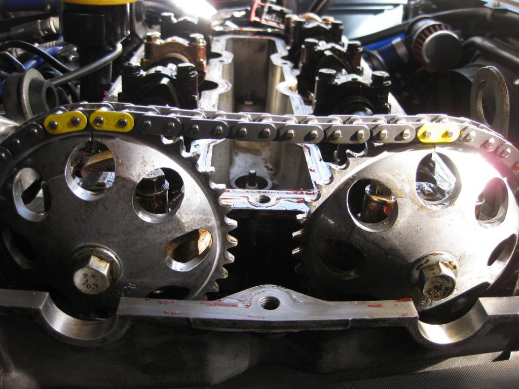

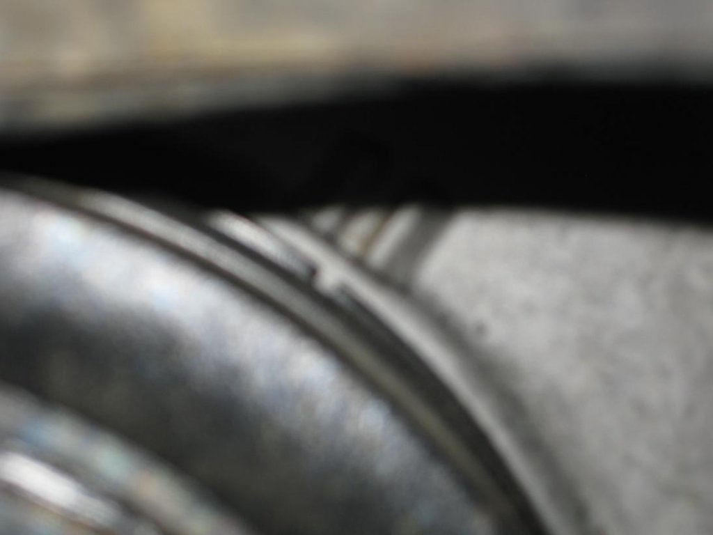

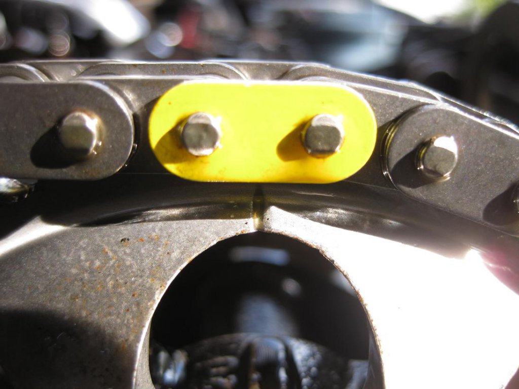

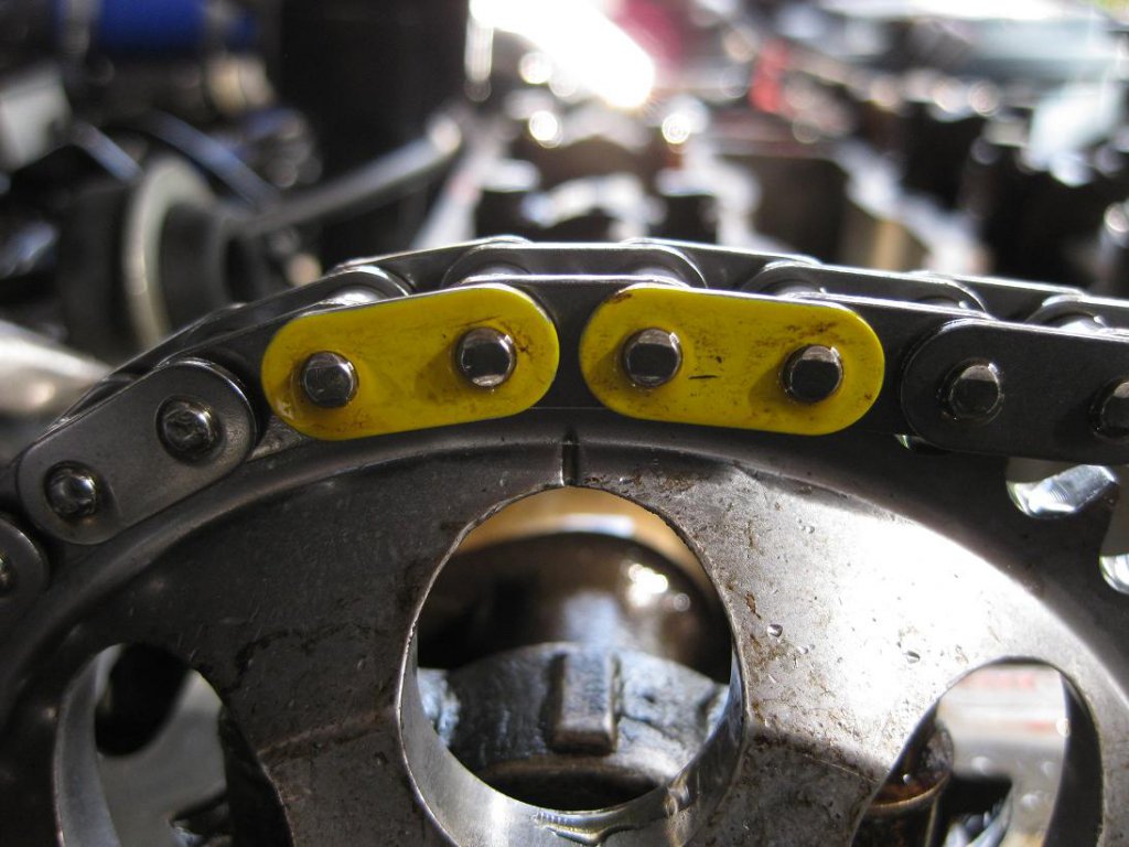

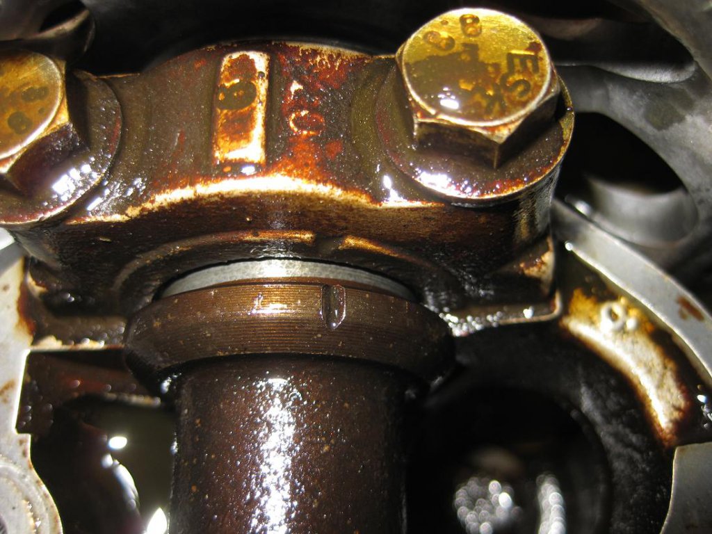

  24. Mein Latein ist am Ende.... So sieht aktuell die Steuerkette aus: [ATTACH]57033.vB[/ATTACH][ATTACH]57034.vB[/ATTACH][ATTACH]57035.vB[/ATTACH][ATTACH]57036.vB[/ATTACH][ATTACH]57037.vB[/ATTACH][ATTACH]57038.vB[/ATTACH] Fazit: 3 DI-Boxen getestet (2xrot 1xgrün) -- Kein Unterschied Kompression gemessen, ok (zw. 12 u. 14bar) Kabel von DICE zu DI-Box, laut Schaltplan ok Zündkerze von Zylinder 2 immer total naß Zündkerze gewechselt, auch untereinander getauscht, kein Erfolg Sprit tropft schon aus dem Abgasstrang (vom Zyl.2 !?!?) Und nun?!? :dontknow:http://www.saab-cars.de/images/misc/pencil.png
  25. Hab gerade ne grüne DI-Box vom fSH eingebaut und getestet. :argh: NICHTS! Der läuft immernoch sch... Beim Einbau hat die Kette ganz sicher gestimmt. Nur nachdem er jetzt gelaufen hat ist evtl. die Kettenspannung ne andere was einen Versatz ergibt... Ich mach jetzt erstmal den Ventildeckel runter und guck mir dem Schmonz mal genau an.
