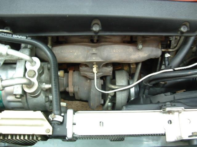

that's not able to hold and it used to? I installed the sensor as shown on
picture(not my car), that's the right place for total exhaust temp.
