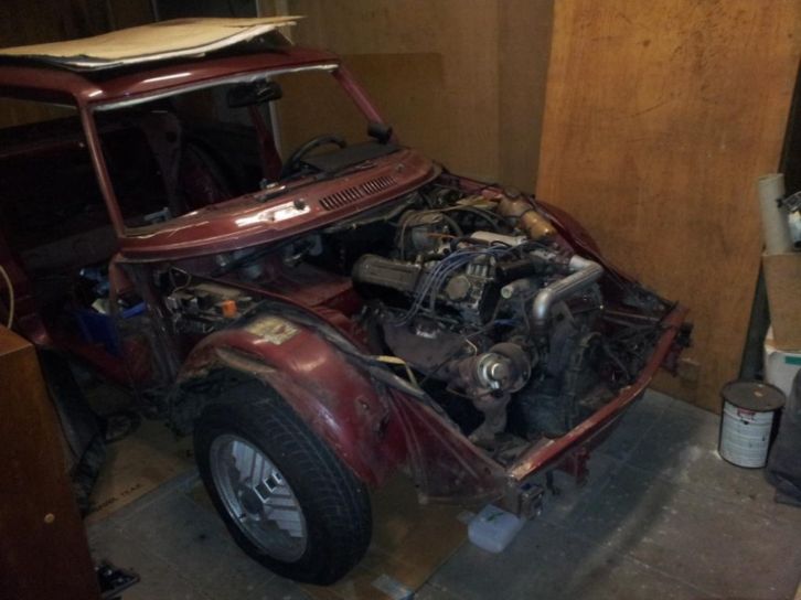

Dezember 14, 201212 j [h=1]Saab 99 turbo Compleet in onderdelen 1980 155.000km!!![/h] [ATTACH]68176.vB[/ATTACH] http://www.marktplaats.nl/a/auto-onderdelen/saab-onderdelen/m625479565-saab-99-turbo-compleet-in-onderdelen-1980-155-000km.html?c=8c285449651fa109c354bbabe740c1b&previousPage=lr&pageNum=1&pos=4 Gruß->

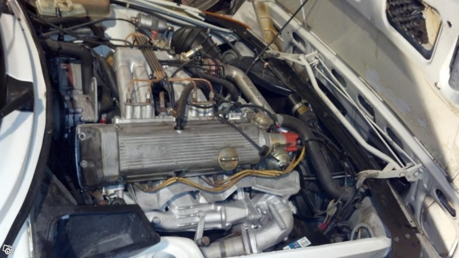

Dezember 29, 201212 j [h=2]Saab 900 turbo -81[/h] [ATTACH]68393.vB[/ATTACH] http://www.blocket.se/skaraborg/Saab_900_turbo_44586251.htm?ca=3&w=3
