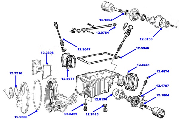

1988 Saab 900 Gear box, 5-speed, Primary gear case Manual : http://www.jimellissaabparts.com/showAssembly.aspx?ukey_assembly=408511&ukey_make=1032&ukey_model=14676&modelYear=1988&ukey_category=19612&searchString=primary
Bitte hier noch schauen!
